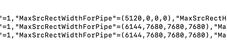

Interesting. Looking at this:
Code:
ioreg -lt | grep IOMFBMaxSrcPixels
There is a new `MaxSrcRectWidthForPipe` property for the framebuffer ports' `IOMFBMaxSrcPixels` on my entry level M4 mini which was not there in previous generations. Its values apparently contain max limits "for pipe" (whatever that means) in an array. These seem to coincide nicely with the 3072px and 3840px HiDPI limits we experience (not sure about the 3360px some had) and the limits match the specs page of the mini. The old `MaxSrcRectWidth` is still there which in previous generations was an exact indicator of the scaled resolution limit, but it is now always set to 7680.
Maybe this is somehow used to determine the scaled resolution for various display configurations in a more complicated manner than on previous generations.
