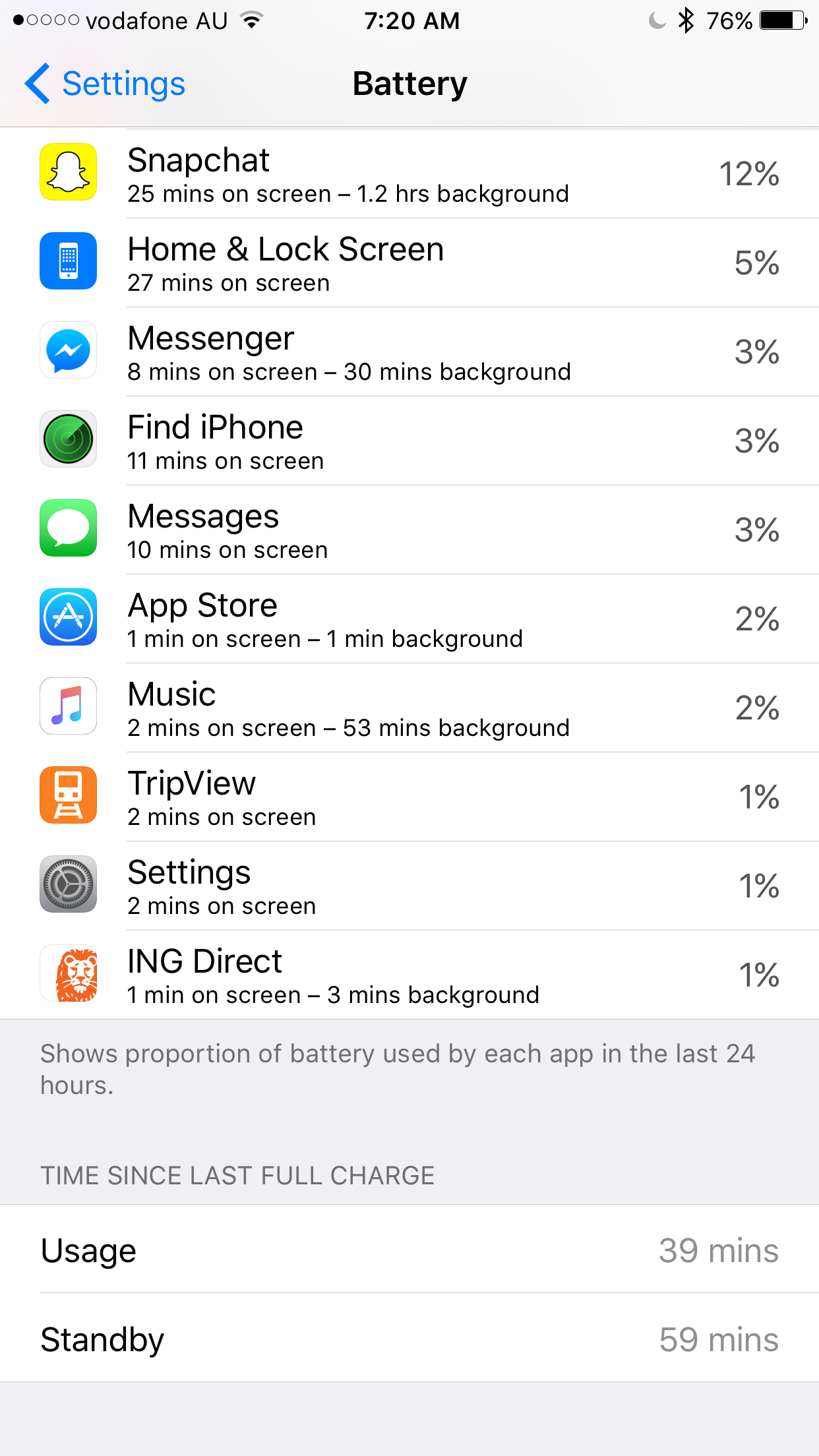

I've had my 6 Plus since launch day, and it's been a pretty great phone. I don't use it extremely heavily, but I have a question about how much capacity your battery has kept since its release date.
Mine lately has been absolutely dreadful over the last 2-3 weeks. It will be on 10%, I'll plug it in and it will jump up to 40% or something similar to that.
I'm running 9.3.2, no background app refresh on or push mail. Do I possibly have a faulty battery. Or does anybody else have a similar issue on their iPhone 6 Plus who have had it the same length of time as me?
This morning it even managed to drop 24% in 40 minutes of casual browsing in safari. After that it had about 30 minutes of playing music and it dropped to roughly 39%.
Should I just get a new battery for it or is it software based?
Thanks guys

Looks like a broken/faulty battery, especially if you use your phone a lot. Whatever you do DO NOT replace the battery without taking it to an Apple store first/talking to them on live chat/on the phone. They can find out for certain by running diagnostics on it which will pick up any battery issues (first-hand experience).
In live chat they do this by sending you a link in emails which you'd open on your phone (they'd get results and share anything picked up by the diagnostics). Then it would be your choice on what to do next. If it turns out the battery is indeed broken/faulty then I would recommend getting an official battery replacement from Apple (if your phone were to break they can refuse to fix it if you got an unofficial part put in your phone).
