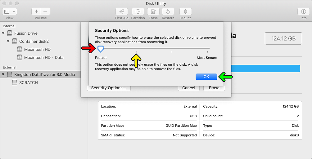

If you ever do not trust a disk, format it with several test patterns (diskutil).
Takes a while (hours-days) but it will isolate any bad spots
and also tells you if it is good enough for re-use.
;JOOP!
Are you saying to format 100%, then reformat a second time in a different format, and repeat?

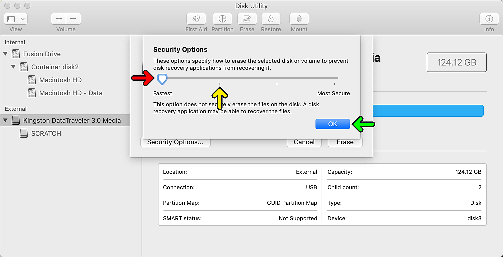

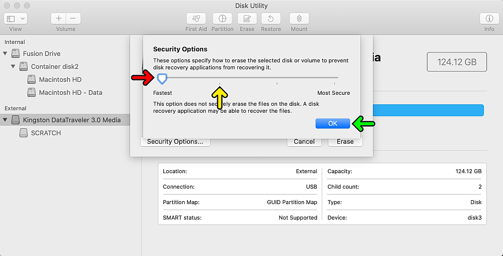

Diskutil has security options, see attachment.
;JOOP!
