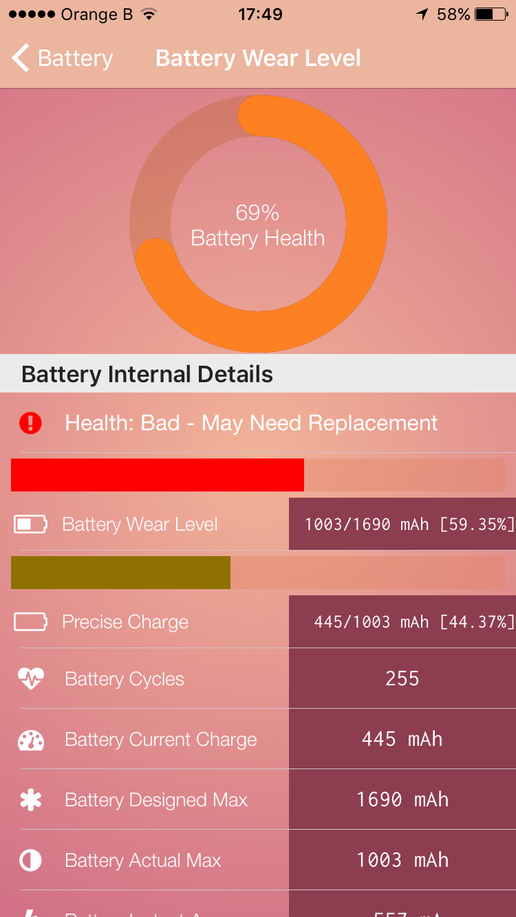

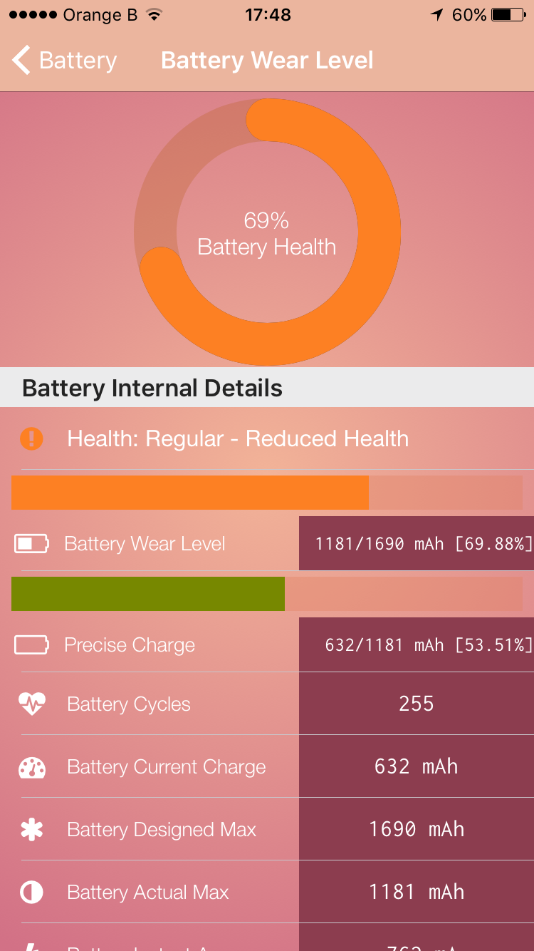

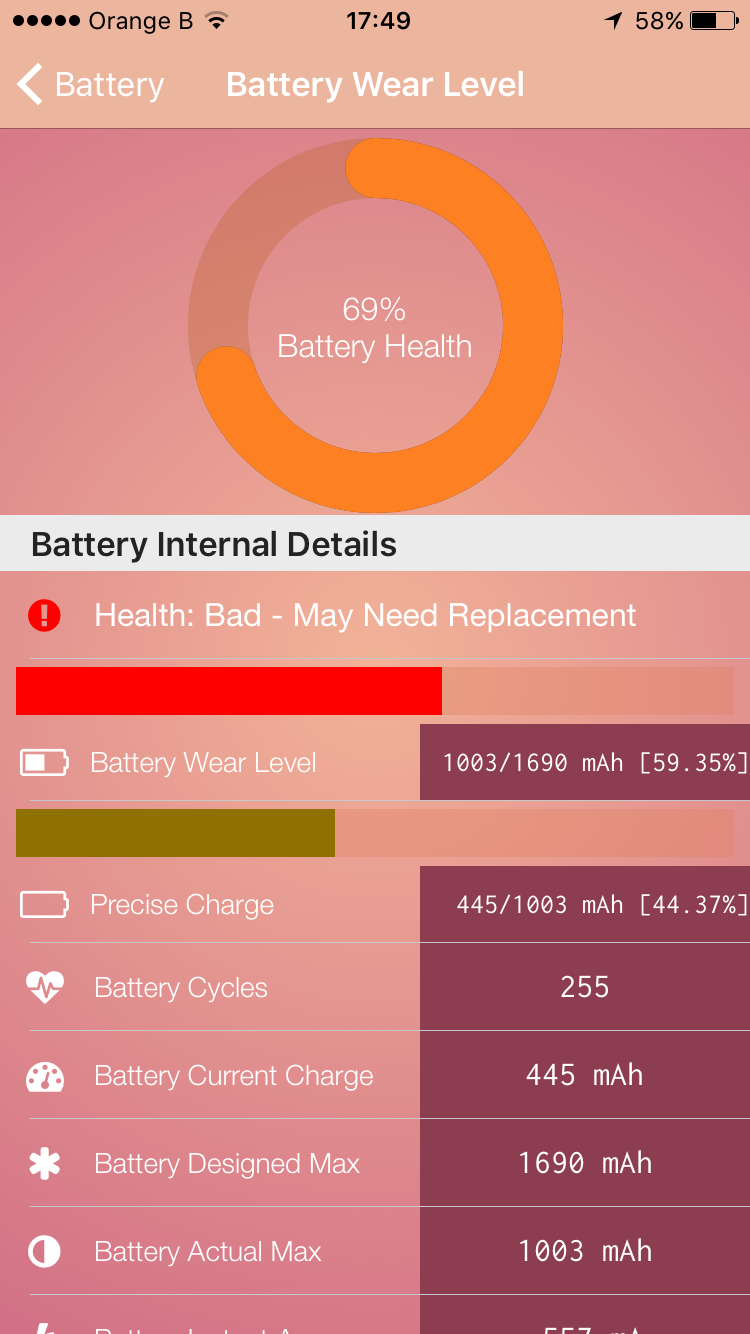

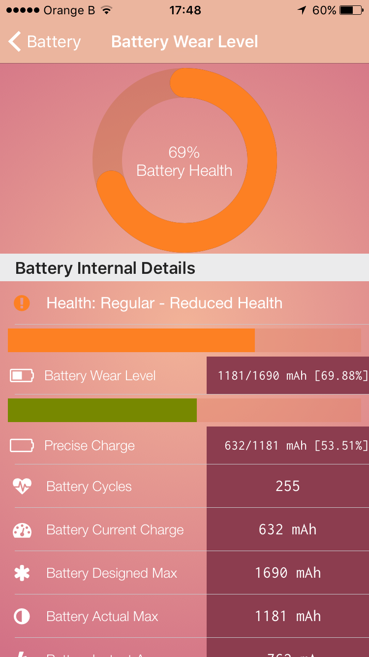

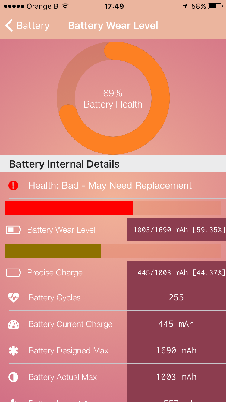

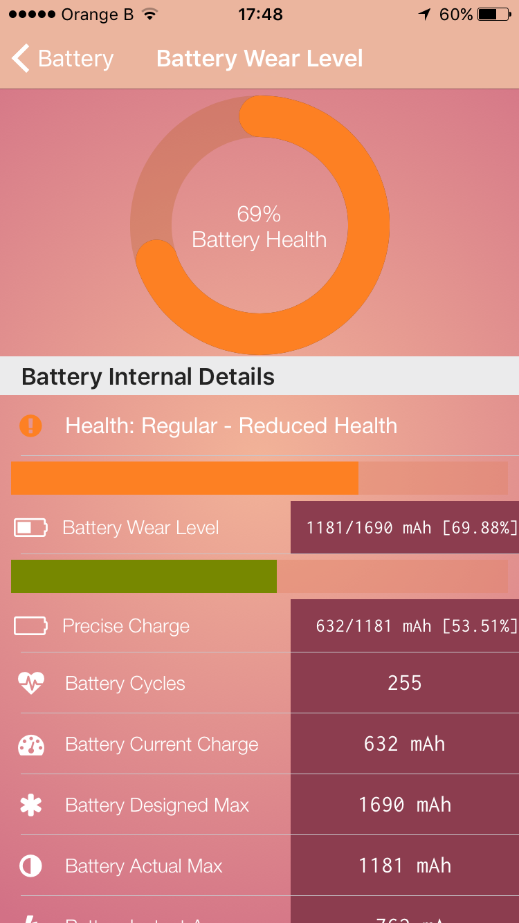

Hey , My almost one year iphone 6s has this problem to, it starten 6 months ago, random restarts , turns of between 5-30% battery . after 2 min i could restart the device just for a few sec before it turns itself off. i called a lot to apple , restore with itunes , without backup and with backup, made no difference. I send it to repair , my carrier took care of it. They found no problem and did just a DFU reset (firmware/software)I did a lot correct battery calibrations didn't work
i used the app battery life , it told me the battery was average en sometimes bad and even verry bad , the max charge was between 1350mha and 1400mah
Now i send it to apple. 09/09/2016

You should go to Apple Store to replace battery. It should not be that bad after only 255 cycles. Looks like battery is damaged
Yes , when i called apple . I told that i had 255 cycles en my capacity was around 1400mah
They repley: Indeed normal i could easely handle 400 cycles
i used those apps:
iBackupBot for iTunes
coconut battery
battery life
Lirium info
