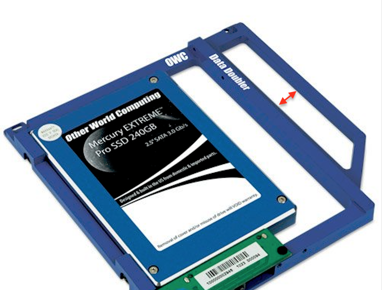

Does anyone have the OWC data doubler and if so, could they measure the width of the cut-out in the aluminum, indicated by the double red arrow in this screenshot? I want to know the width to see if the WiFi card can straddle the opening with 3M transfer tape and not fall through.
Thank you!
I got the dimension of a OWC style, aluminum data doubler; the wireless card should easily span the gap!
