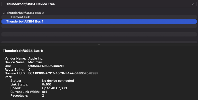

I'm using M1 Mac mini with a graphic tablet which is working as an external display but mirrored from the main monitor. I updated to 11.5 today and then a graphic tablet is not working. Im using Huion Kamvas 13 btw. It's not broken cause It's just not allow me to use two displays at once. If I disconnect the main display and then connect a graphic tablet, it works fine. But then, when I reconnect the main display to use both fo them, the graphic tablet does not work or the main display does not work until I unplug the graphic tablet. The graphic tablet has no signal and it's in a power saving mode. I checked the system report and it says one of the TB port is empty. I have no idea why but I already connected it with USB-C cable. The power shouldn't be a problem cause both TB port can provide enough power and I even have a TB4 hub. I tried all TB ports and it keep showing no signals. There were options for arrangement from System preferences but not anymore. As a result, M1 Mini is not recognizing the tablet.
Yes, I'm quite furious about this issue. It's not a hardware issue. I tried both old and new firmware for Huion Tablet but it didn't solve anything. Now, in order to use a tablet, I have to disconnect the main display. So far, M1 Mac mini is not recognizing the tablet AND it does not providing enough power to run. Since M1 Mac mini can provide enough power with USB-C port, it's hard to believe it.

I reinstall macOS and yet, it didn't solve the problem. Clearly, Big Sur 11.5 is the main problem and I need to figure out how to downgrade it. With 11.4, I was able to use both monitor and graphic tablet at once.

Here's the video after I got Big Sur 11.5. It supposed to work with the main monitor but now, I can't. No problem with the tablet itself and cable since I tested on other devices. I disconnect the cable from the main monitor and then reconnect it to test the problem. As you can see above, there is no way I can use two of them at once. It works fine when I used 11.4 or older. Clearly, 11.5 messed up with something but I have no clues about how did it happen. I checked all settings.
