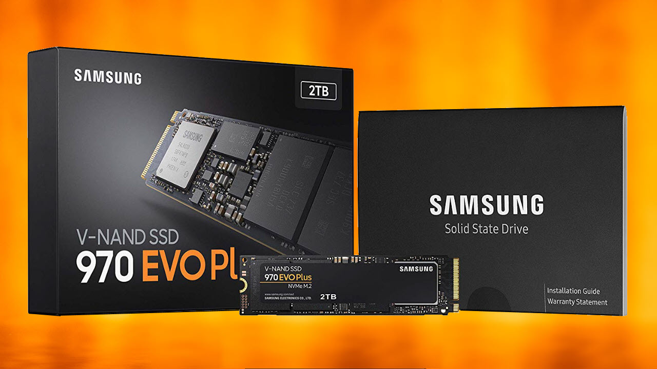

I personally would always go with a Samsung, e.g. 970 Evo, 970 Evo Plus (newest firmware update; but all the ones produced after 2020 have it) or the new 980 (I just installed this in a Late 2013 without any problems, and its quite cheap; see here: #750). All of them have higher read and more consistent write speeds, but most importantly a lot higher write endurance. If you intend to use the iMac intensively for a longer time, then endurance might be important for you.
I chose a Samsung 970 EVo Plus and I regret it. I have a very slow boot time because of slow trim.

970 Evo Plus has 600 TBW for 1 TB drive.
That's pretty standard for a TLC drive, but by no means spectacular. For instance, most of the drives based on the Phison 16 controller seem to have a 1600 or more TBW for a 1TB drive. E.g. Spatium M470.
Point is, if endurance is the measure, the 970 Evo Plus is respectable, but nothing special.

Question: The listing for the Sintech adapter people are frequently mentioning says it is not compatible with w/ 970 Evo Plus. However, I also see a lot of posts where people are using this drive. Am I missing something? And for some reason the basic 970 Evo ($399) is quite a bit more expensive than the Plus ($229) model. Thoughts?

I think this is old info that came from the time when old 970 Evo Plus firmware caused problems with Macs.
This has long been solved with a firmware update by Samsung, however, recent threads here indicate that new macOS versions like Monterey now introduce (different) issues with this SSD.
You can check here :
https://forums.macrumors.com/thread...grade-pitfalls-and-tips.2177812/post-30716033
Thanks for this info, this is new to me. My previous upgrades with this drive have long being sold, and my most recent upgrade of a Late 2013 with a Samsung 980 is limited to Catalina, so I had no chance to check this.
Best currently, I guess, is to avoid the 970 Evo Plus.

I wann a change the origin NVme from my iMac 2019 3,7 with Fusion 2TB to a Samsung EVO 970 Plus 2TB.
Having both of them the one with Phönix and Elpis Controller the question is Is it worth taking the Phoenix or Elpis Controller?
What is u‘s favorit. Firmware is actually the newest.

Hi Sascha
as per this recent post here ( #790 ) for the time being I'd refrain from using a Samsung SSD to avoid extremely long boot times.

Hy it seems to be an 32 Bit problem not only by the Samsung SSD. If there is a 32 bit App installed then Montery didn‘t support, only 64bit Applications.The comunicación between EFI, hardware and OSX is corrupted in the beginning of booting the system caused an error by the 32 bit Apps and is hanging the time of booting.
By an clean install thre is now slow booting because no 32 bit app is installed now. And when a Timemachine backup is installed with an old 32bit App u have become a slow booting System.
