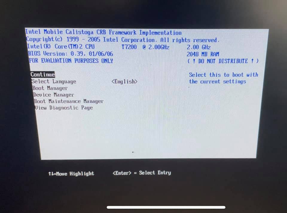

Here's a video of how it behaves. https://streamable.com/ew0tc

Thx for the video, yours is very different from the retail one.
Thanks for confirming this. Because my friends 3,1 doesn't act like this at all, and dumping our ROM's confirm they are the same binary, so something must be on the SPI that's giving it this behavior (or perhaps the board is wired differently that just triggers a different routine). I think I suspect a lacking of TPM to be why it won't boot EFI, but that's based on Windows saying it has no TPM, I don't think Windows is compatible with it, so perhaps something in the NVRAM is triggering the different response.

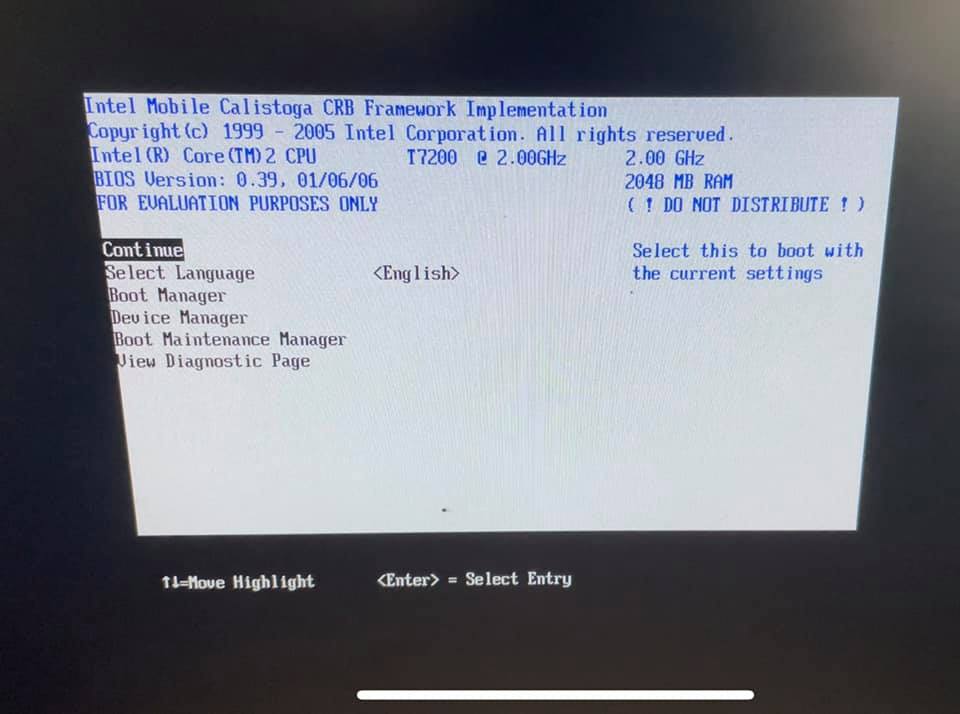

Martin Nobel (YouTube) posted this on the Low End Mac Facebook group today. It shows a iMac 4,1 displaying the Duet Boot Device Selection interface. He says he downgraded his iMac to IM41_0039_00B.fd from Firmware Restoration CD 1.7, after first intentionally corrupting his firmware. He was able to enter the Duet BDS by starting a EFI shell and exiting it.
iMac 4,1 showing DUET Boot Device Selector
It seems this interface has only been seen twice in the wild before.
  • On a 2005 prototype of a 15 inch Macbook Pro with pre-Yonah Pentium-M CPU.
  • An another early iMac, before Apple released Boot Camp and a firmware update with a proper Compatibility Support Module (CSM).
I opened the IM41_0039 firmware file on Firmware Restoration CD 1.7 using UEFITool NE alpha 57. I found the relevant DXE driver using the same GUID as it has in the MP3,1 firmware. UEFITool calls it "DuetBds" for "Boot Device Selection".
I extracted the driver and opened it in Hex Fiend. I then copied all the English language UI strings to a text file. See spoiler:
