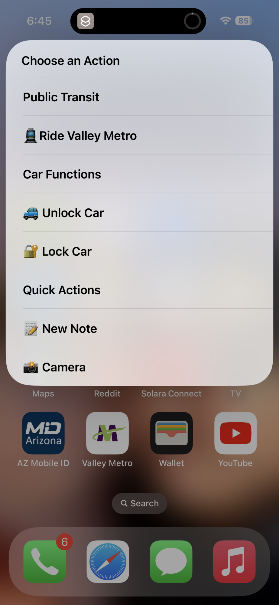

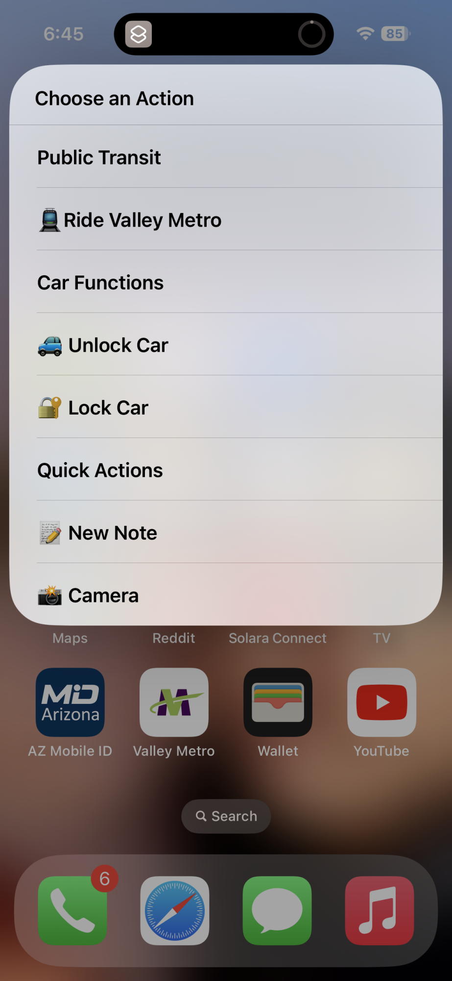

Mine is a transportation one. I press it and I have options regardless if I’m driving or taking the bus or train.
If I press Ride VM, it pulls up my digital bus pass to scan on the bus or train station.
Lock car and unlock car run shortcuts to lock and unlock my car!
Edit: New Menu setup!

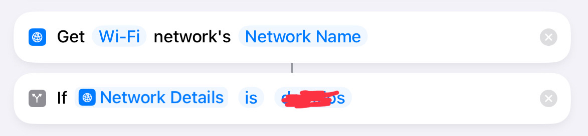

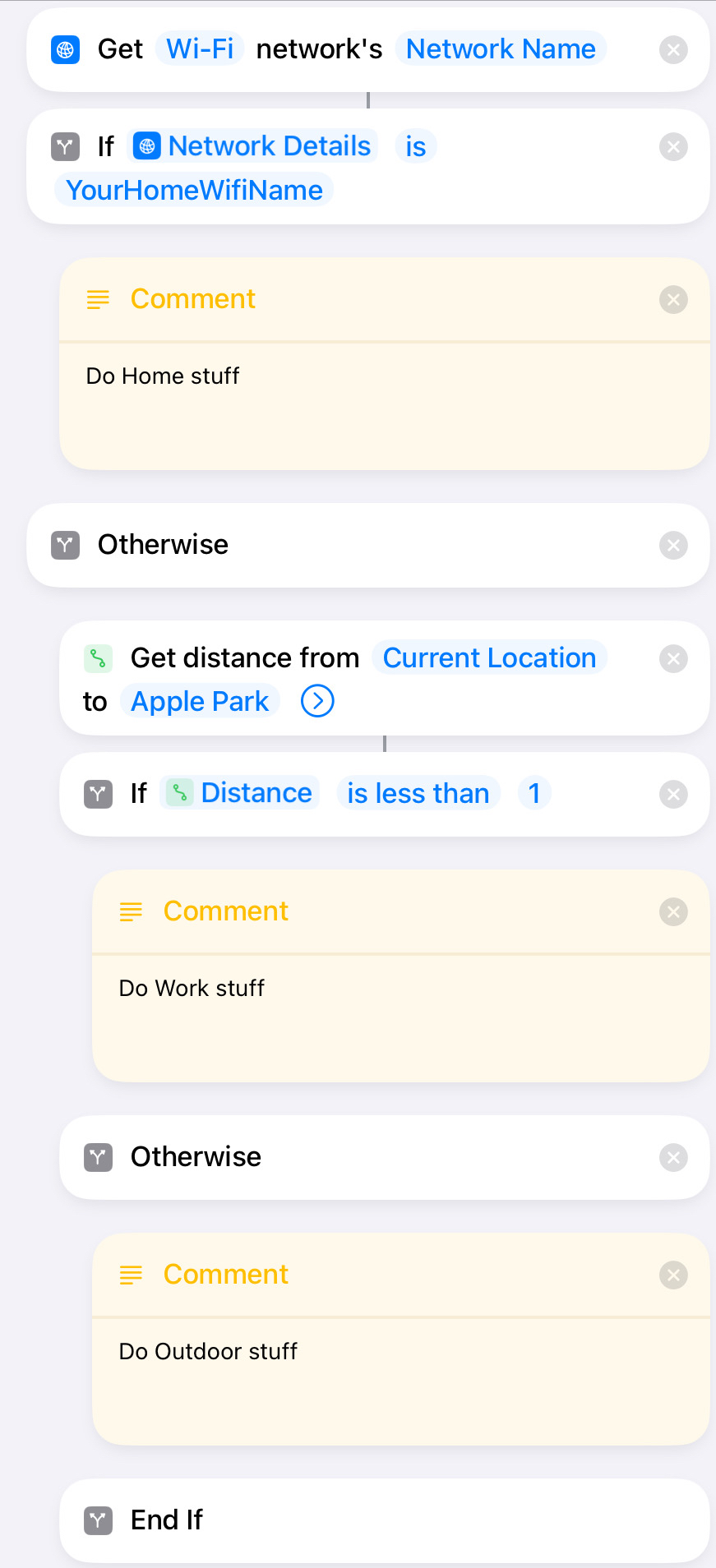

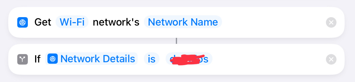

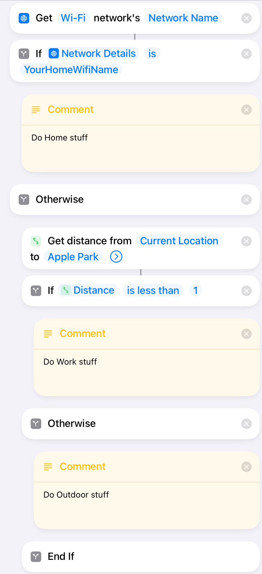

So for the ‘if network details’ is ___ I put my own WiFi network name? This is probably really obvious stuff but I can’t wrap my head around the code like text 😂
Thanks for the suggestion I may try just the WiFi for work and camera app for all others and not bother with the work setup. At work I’m often not on any WiFi so the WiFi method wouldn’t work.
@Lotuskid , yes, type your home WiFi name directly into the field.
If not connected to this network, then check the distance to your work location like in the attached screenshot.
Of course you could use location/distance to determine your home as well.
just a quick follow up, the wifi connection worked like a charm, now when it recognizes my home wifi it'll open the hue app, and anywhere else opens the camera app. i haven't yet tried the location based step for work but will give it a shot as well. pretty cool, and adds some extra functionality for me since the hue app i specifically use several times a day but only when i'm home and don't need to open it typically outside
