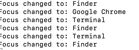

I have used the script and all it is showing is that finder is stealing the focus, rather than pinpointing a specific culprit.
Safe mode does not have this issue. HELP!
I believe there is, or was, a way to extend Finder functionality to do things like add custom badges or context menu items. For example, I believe DropBox used to use that feature, and maybe MS OneDrive(?). However, recent macOS changes have broken that old technique so up-to-date products need to use a different method.
Do you have any programs that may be integrated into Finder? It makes sense to me that they could cause the behavior you are seeing, and the idea also explains why it doesn't happen in Safe Mode:
Safe mode prevents certain software from loading as your Mac starts up. This includes login items, system extensions that aren't required by macOS, and fonts that weren't installed by macOS.
This article (here) suggests that you can list your non-Apple Finder extensions with this Terminal.app command:
pluginkit -m | grep -v apple
For example, my output lists Pixelmator and 1Password components. Take a look at your output, and uninstall any un-needed or out of date Finder extensions.
