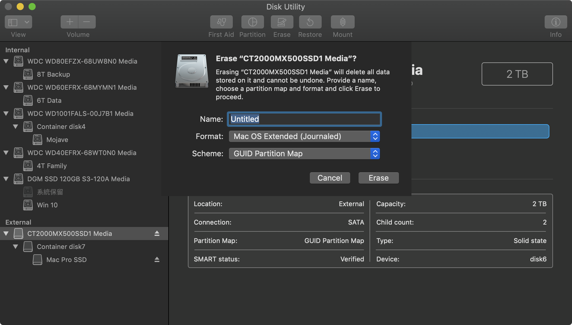

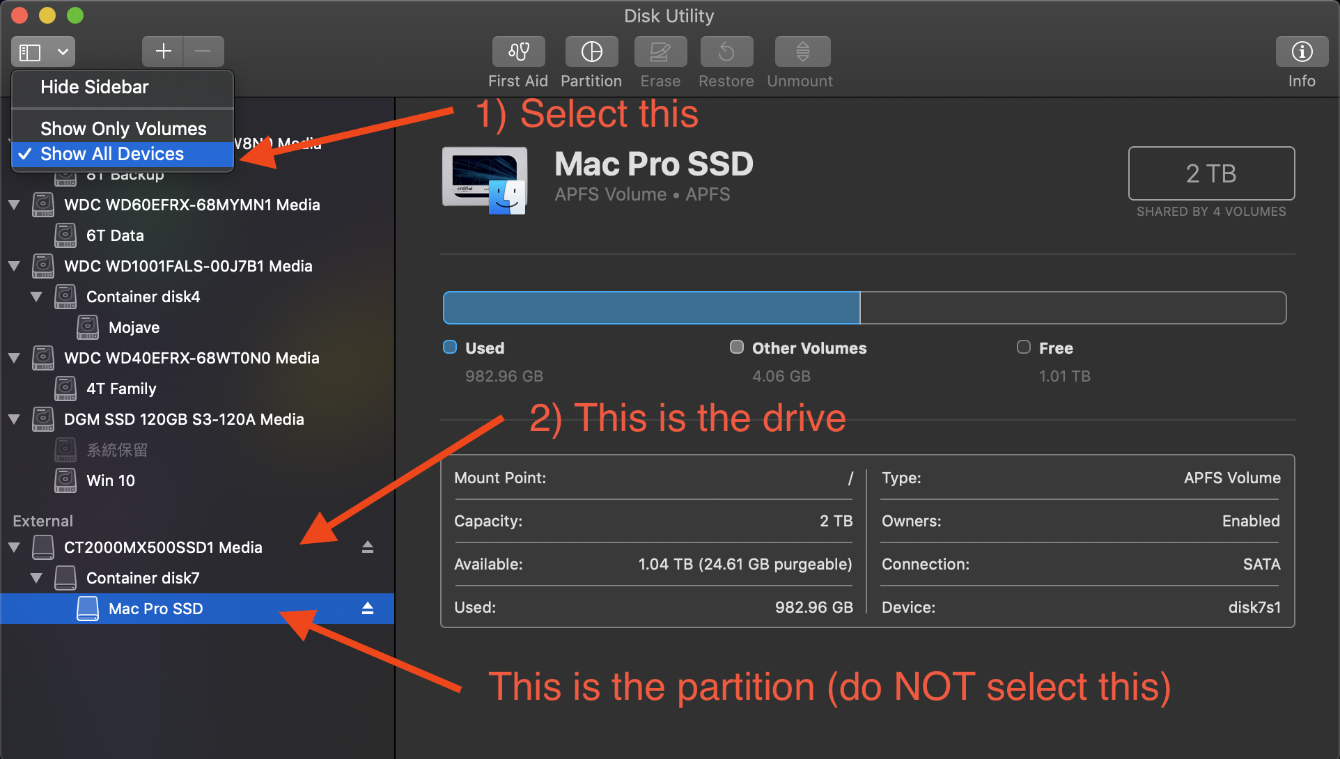

Since you have a HS USB installer on hand. All you need to do should be
0) Shut down
1) install a SATA drive (can be SSD, however, expect all data will be completely destroyed)
2) with a know good GPU (that HD4870 is good)
3) Hold option to boot
4) select HS installer

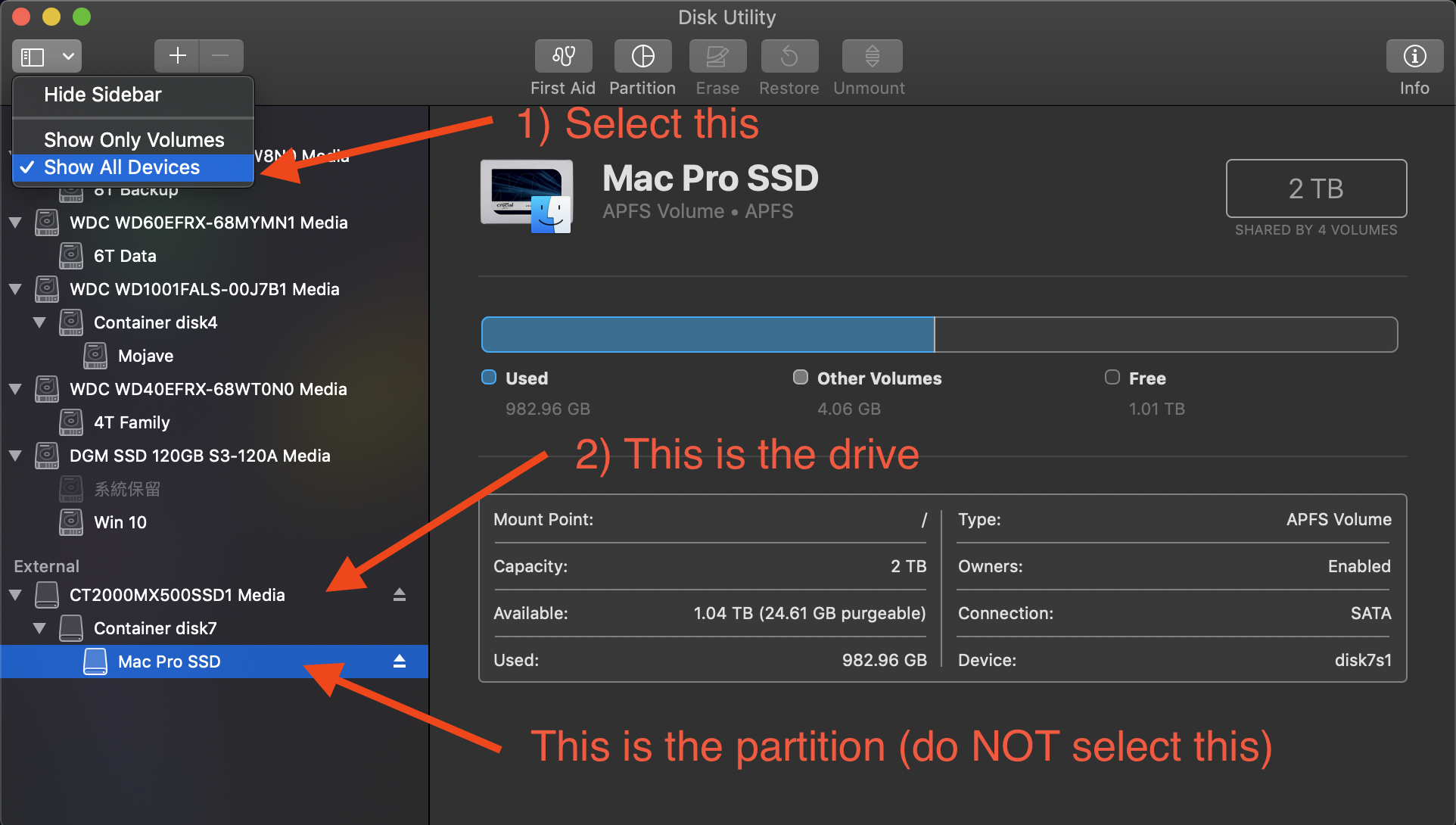

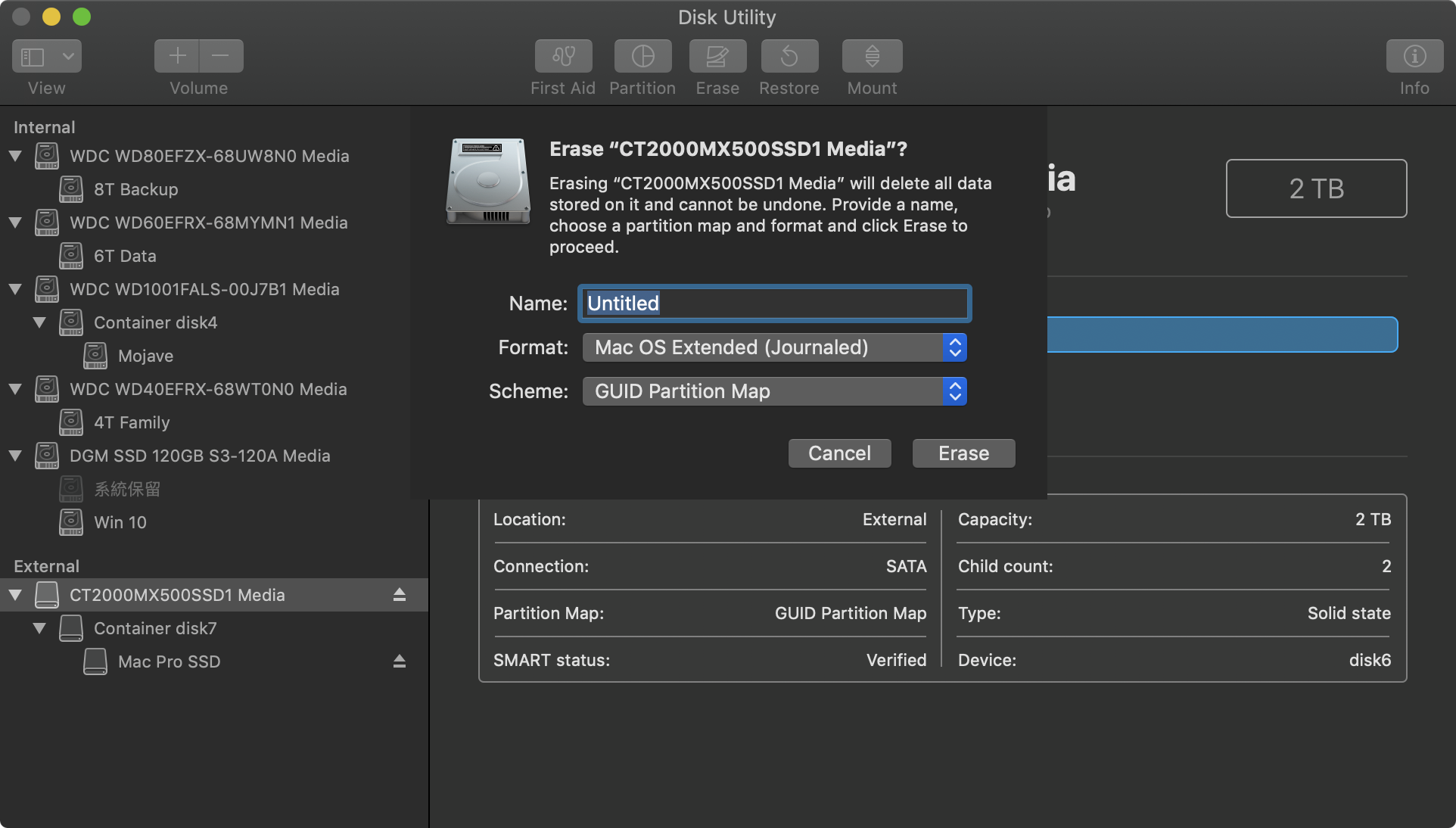

5) open disk utility
6) select the SATA drive (NOT the partition, but the drive, you may need to select "show all devices" on the top left)
7) Erase it (as per the following parameter, except you can name it to whatever you want)
8) install HS to this newly erased drive

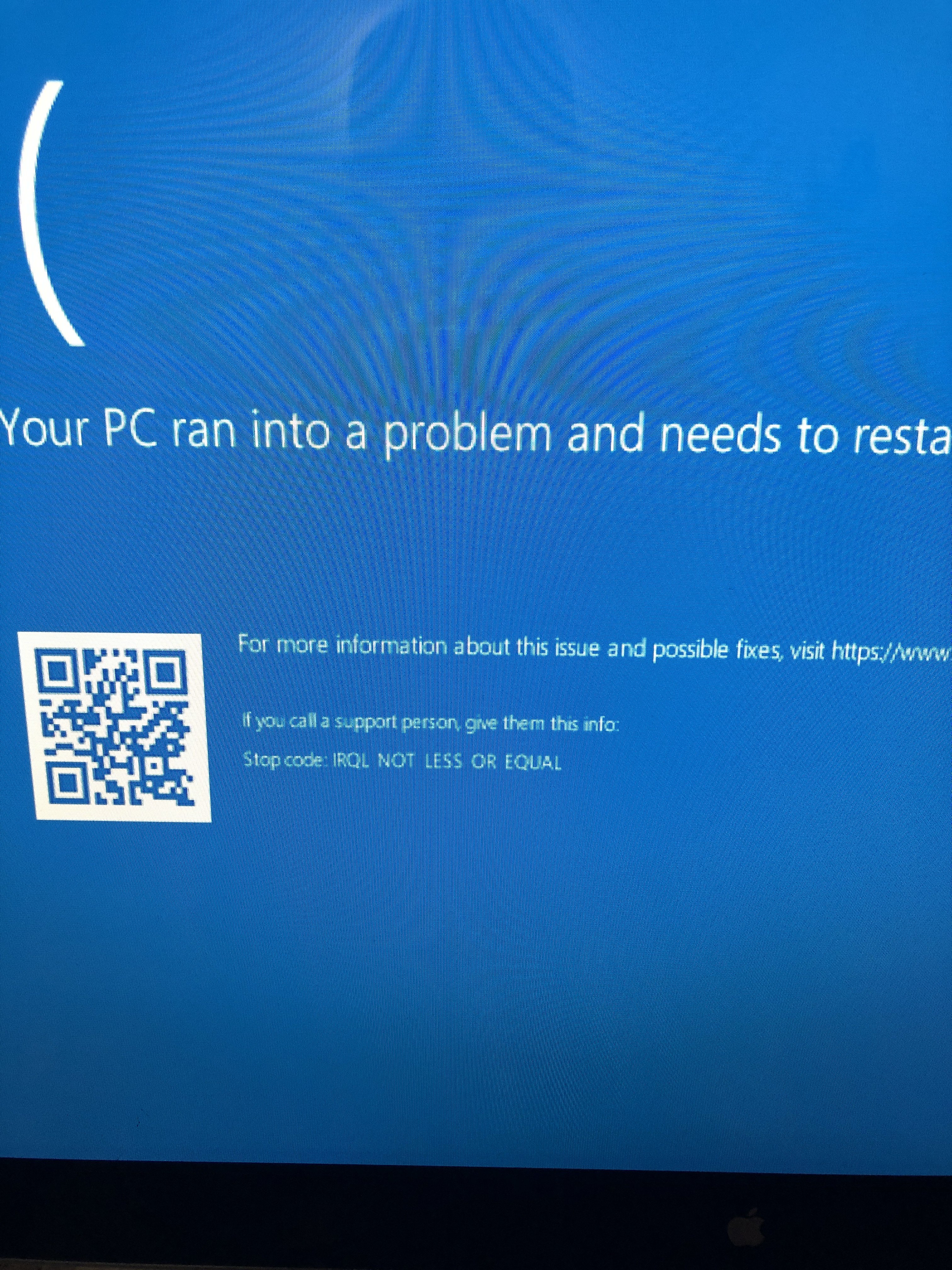

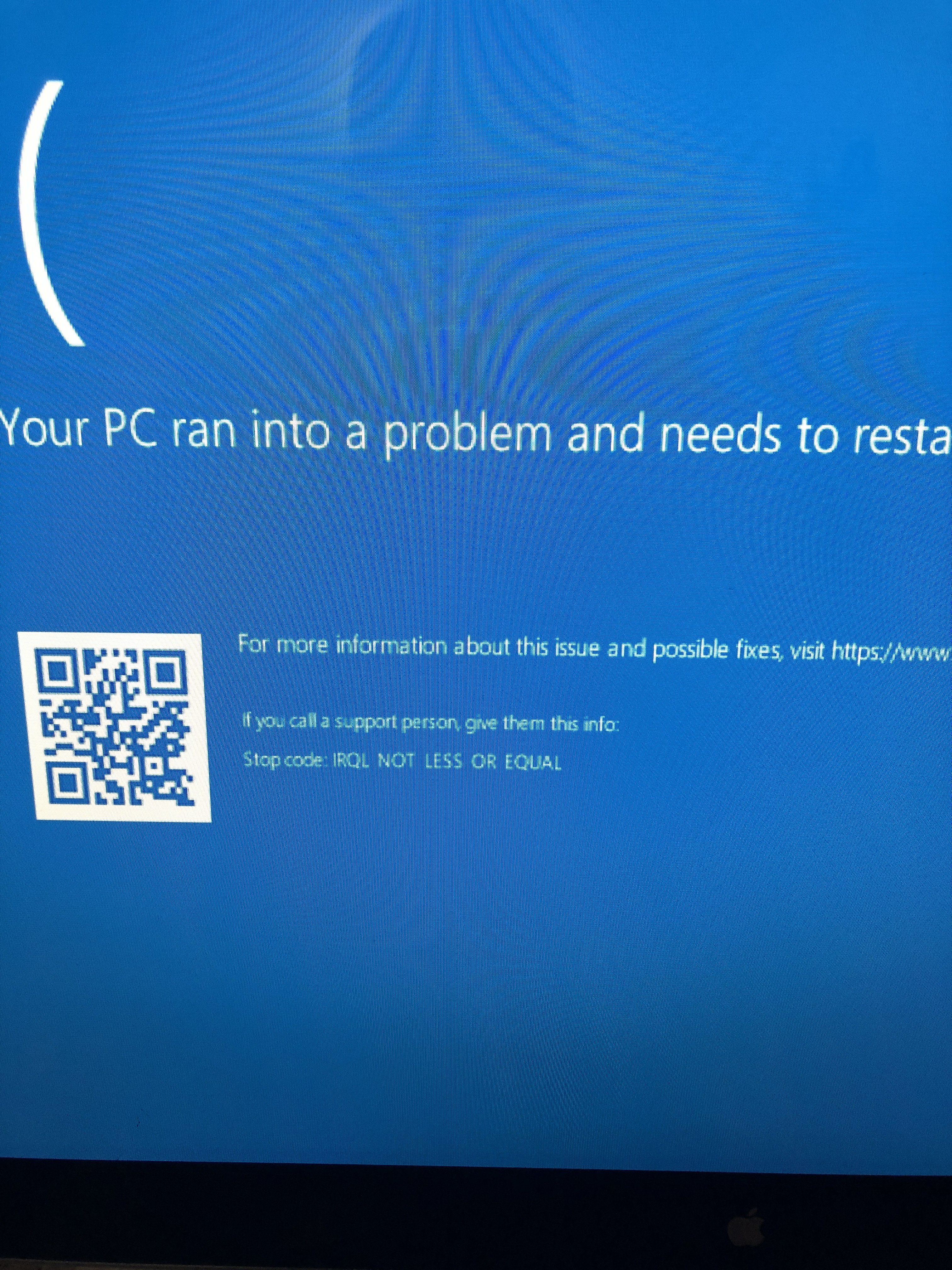

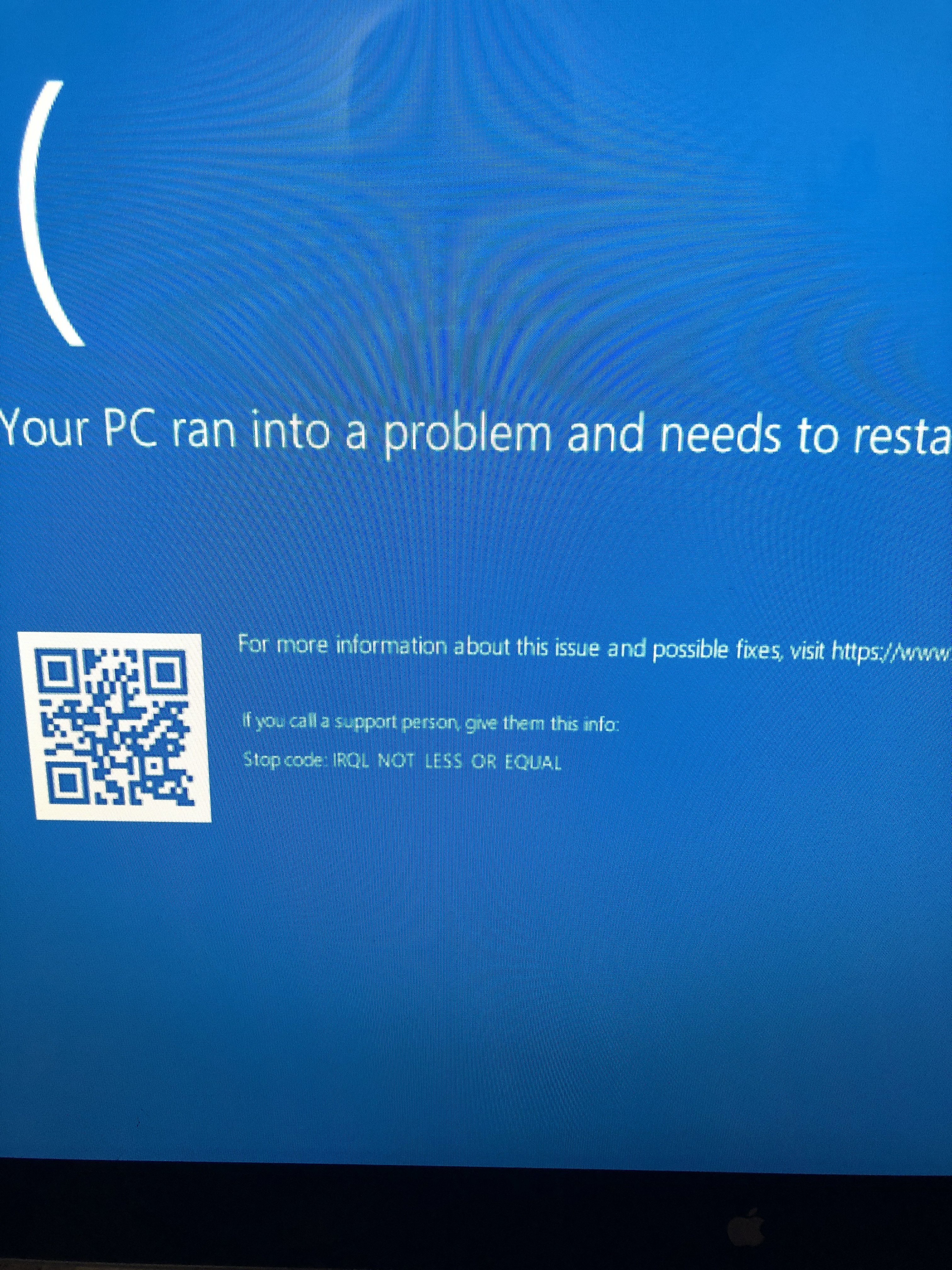

D9CDCC50-DEAC-4B99-880F-6EABC46788D1.jpeg Ok... so I removed the battery for a few minutes, installed one stick of RAM, and put the HD 4870 in slot 2. Also threw in a Windows 10 install DVD.
Seems to be taking Windows just fine. However, I tried so many things at once its hard to say what did the trick. But I’m leaning towards the computer having some kind of problem with OSX.
Or not... after the cMP loaded the files from the install DVD, I was greeted with this screen (and its hung up, won’t actually restart):

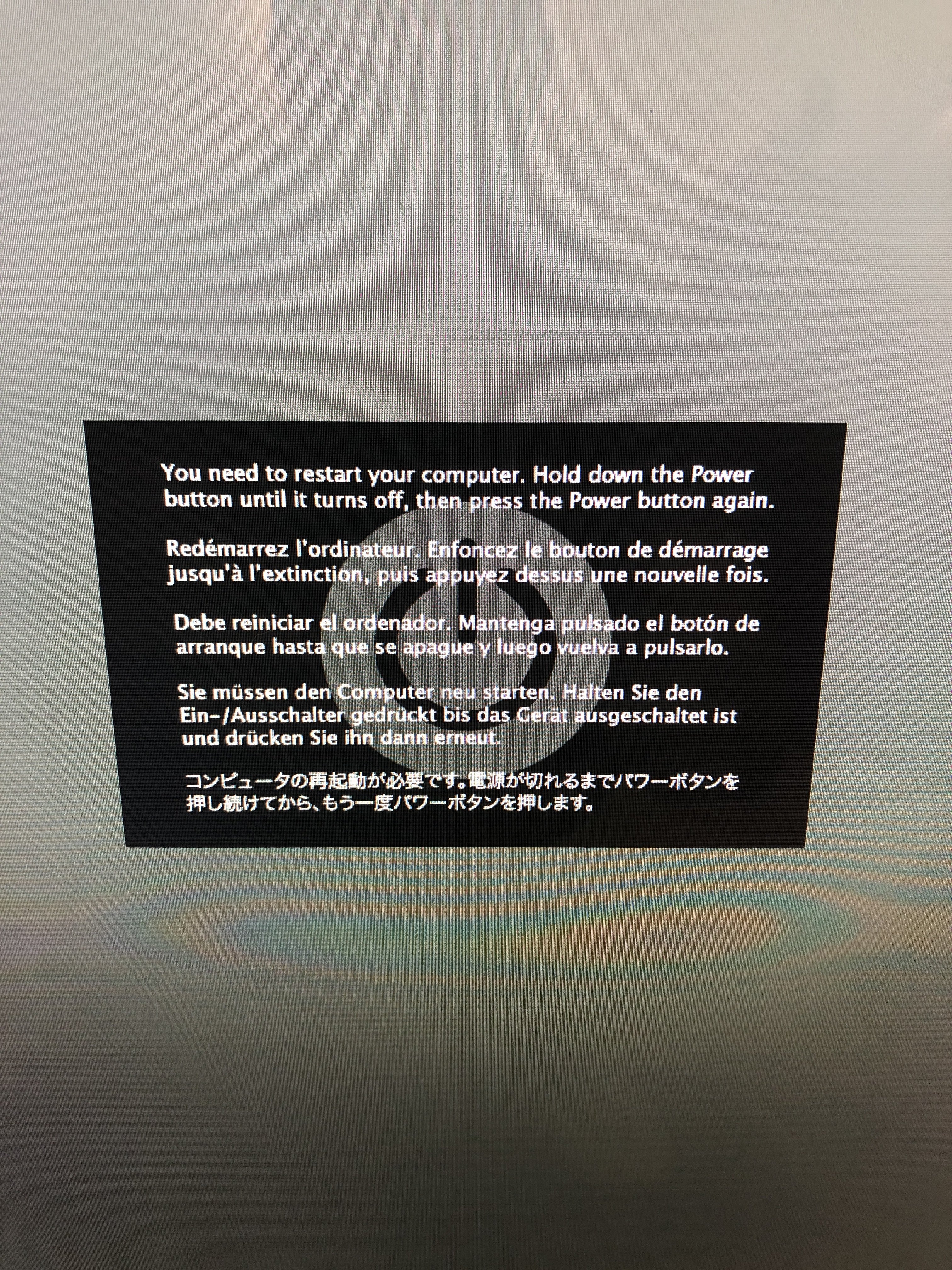

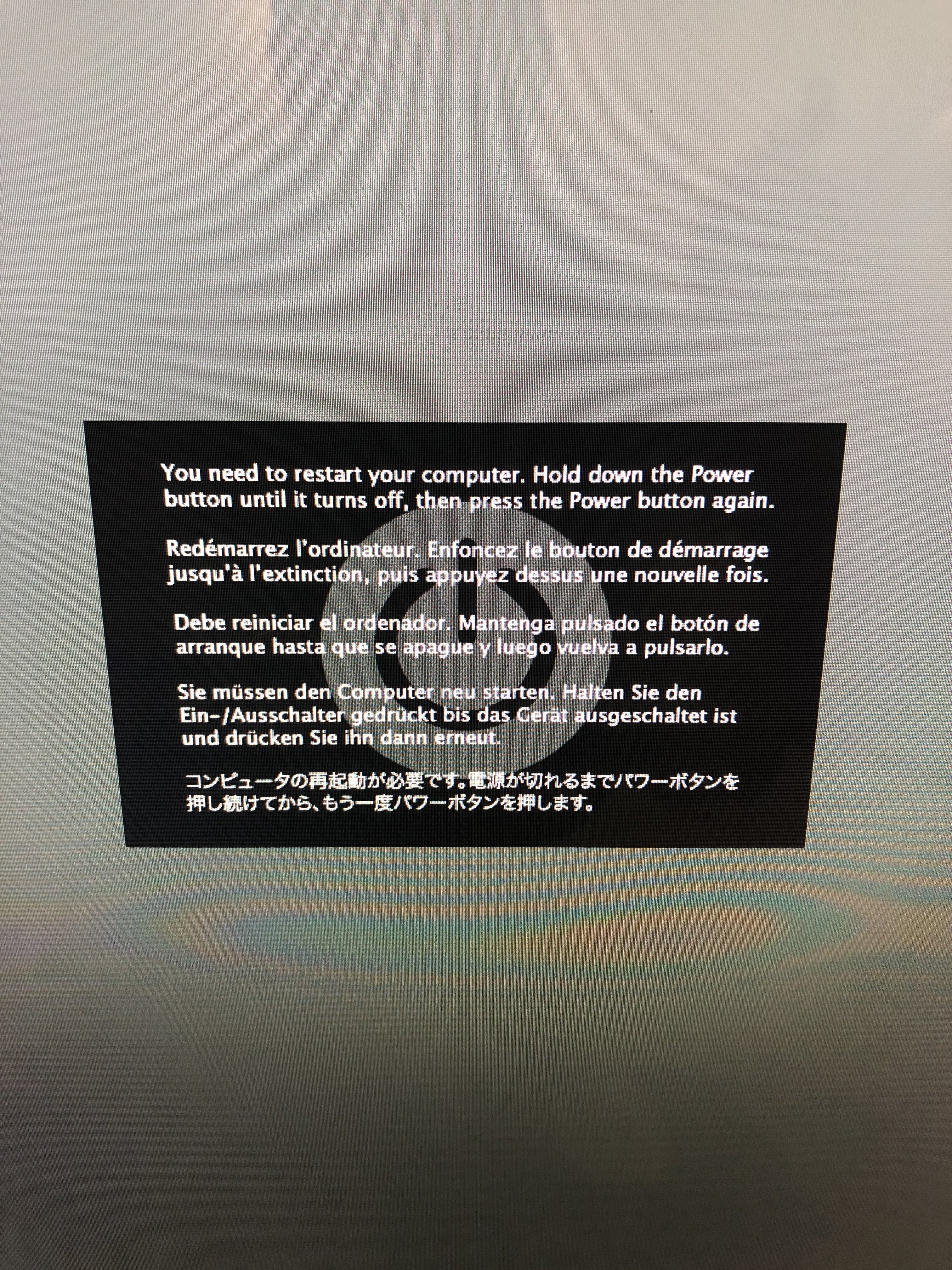

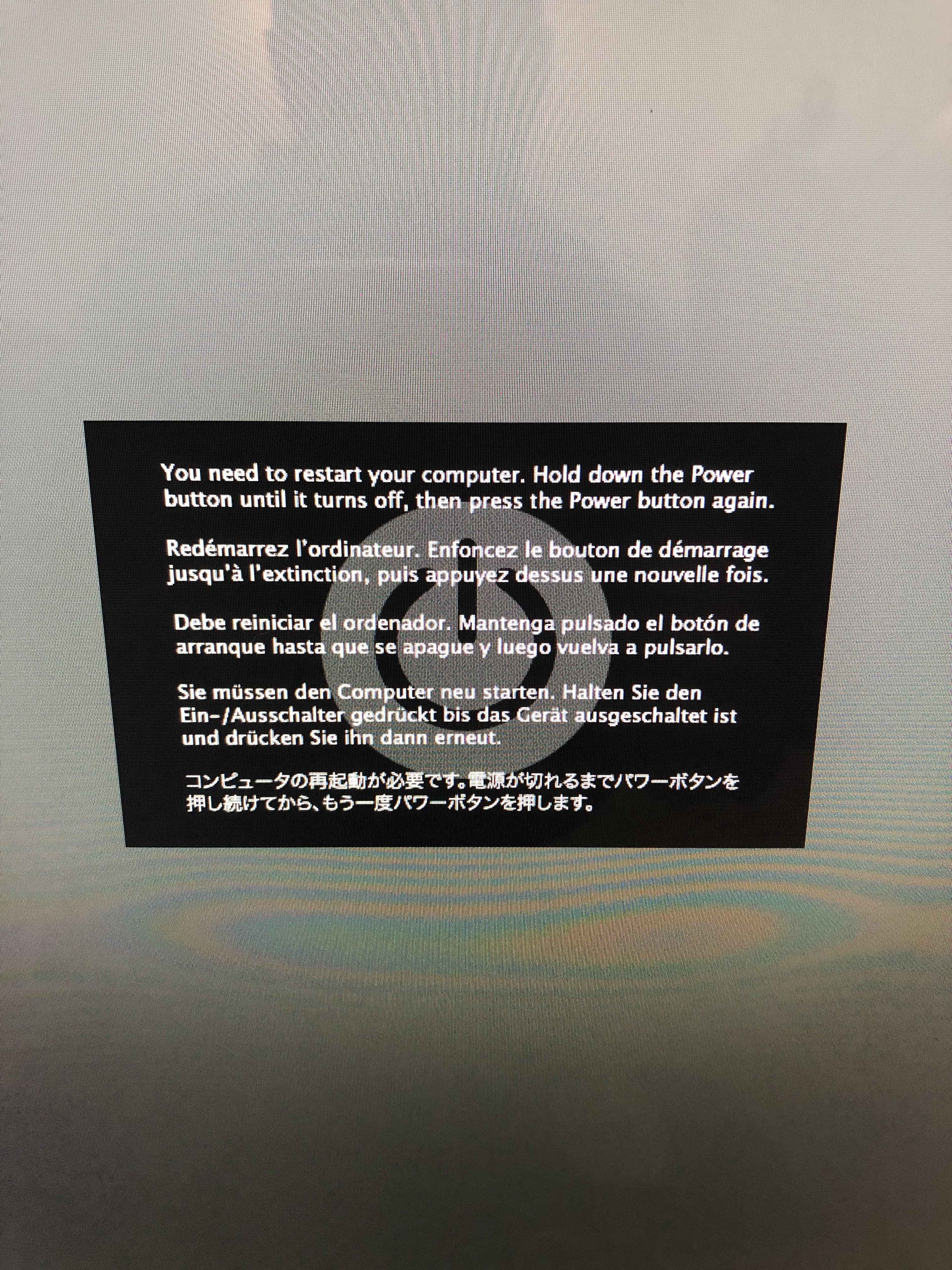

[doublepost=1542498304][/doublepost]F6B4EA81-68A4-451A-9EF8-C5A1D0816A09.jpeg Trying a Lion USB installer gives me this screen.
Even tried holding down the power button while starting up like a firmware flash. No change.

View attachment 804900 Ok... so I removed the battery for a few minutes, installed one stick of RAM, and put the HD 4870 in slot 2. Also threw in a Windows 10 install DVD.
[doublepost=1542498304][/doublepost]View attachment 804901 Trying a Lion USB installer gives me this screen.

Try to load a Linux Rescue-CD, if loads sucessfully, we can reflash the BootROM using flashrom.
Gparted live cd is the one that people flashed Mac Pro BootROMs.

on the Lion USB thats a kernel panic
boot the Lion USB in verbose mode, it will print out the panic log and then I can tell exactly what its crashing on :)
