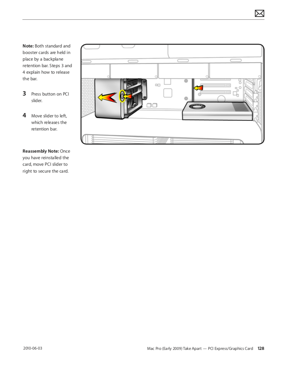

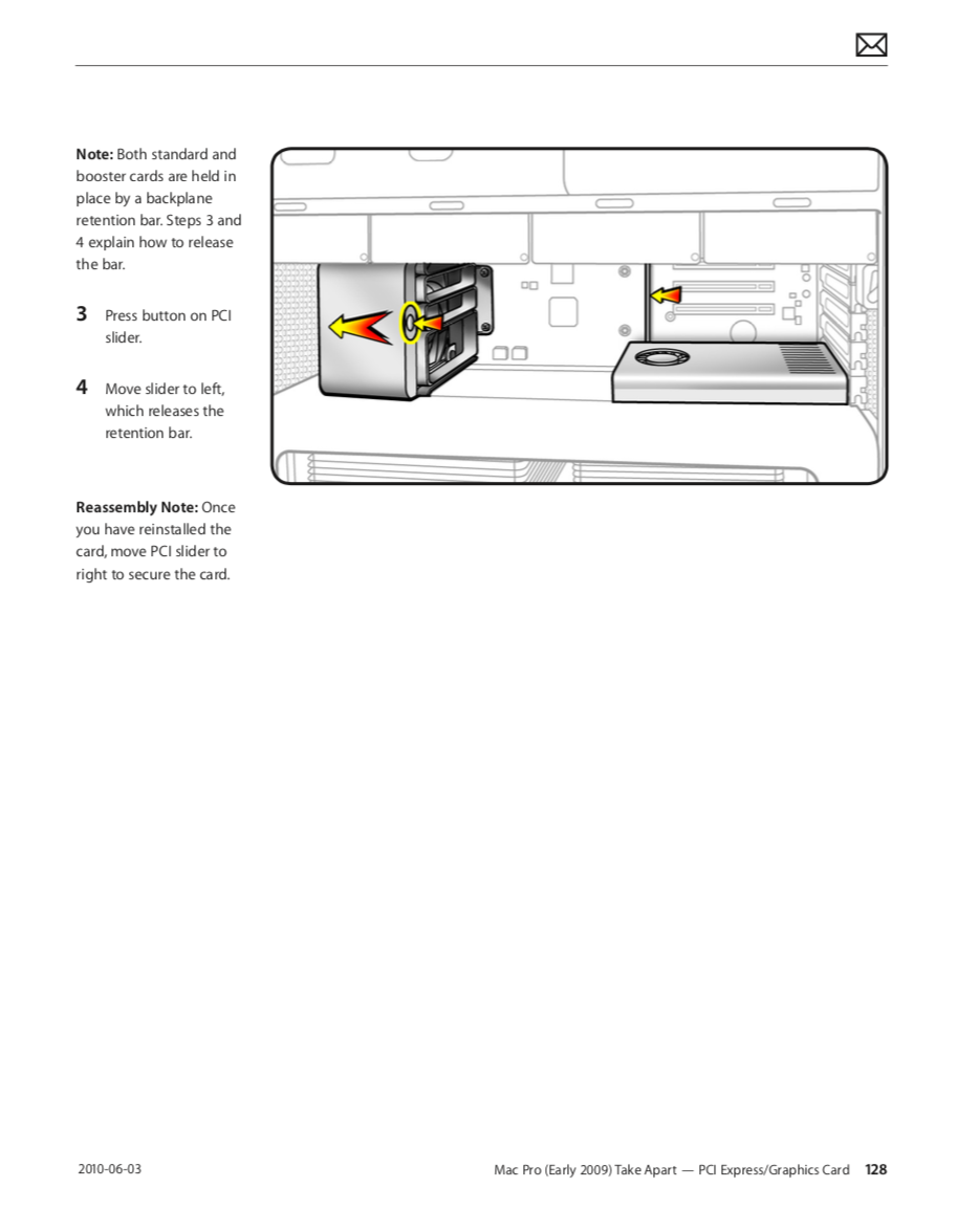

This may sound obvious but you know that there's a button on the PCI fan housing ? when you press it, you can slide the fan housing and the metal bar that locks the PCI cards in towards the front of the MP.
This way it should be very easy to remove the GPU and/or a PCI card....
I never saw the button and still haven''t. I was trying to research and couldn't find anything but I guess I should looked how to take it out in the first place but didn't think of that.
