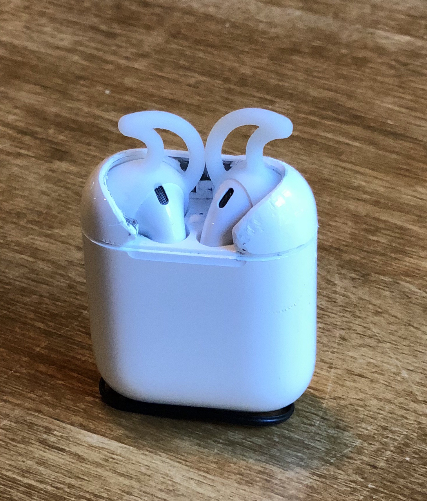

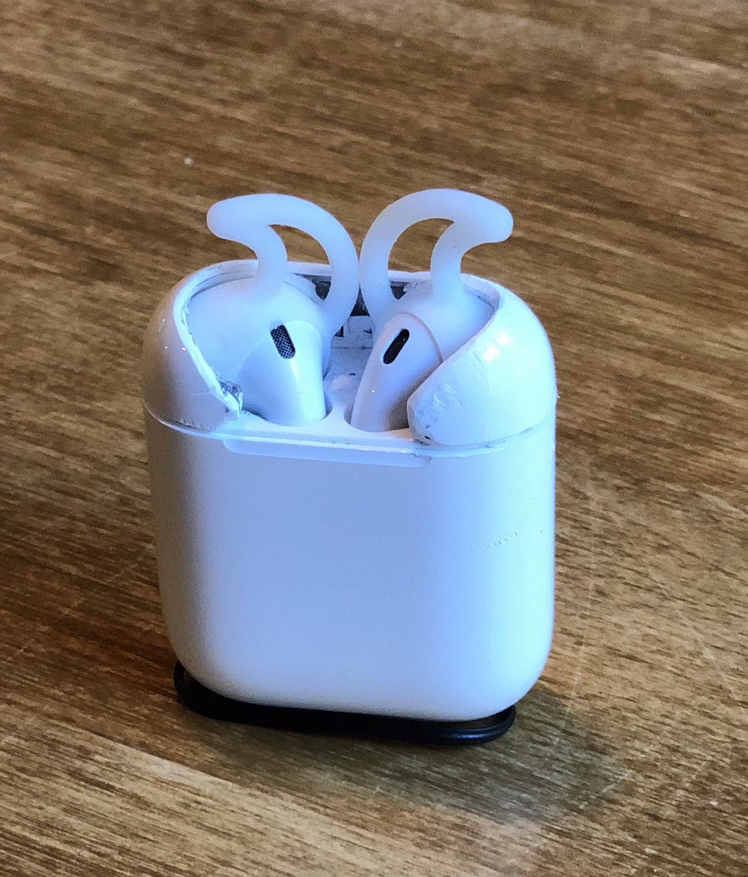

This changes everything - again!

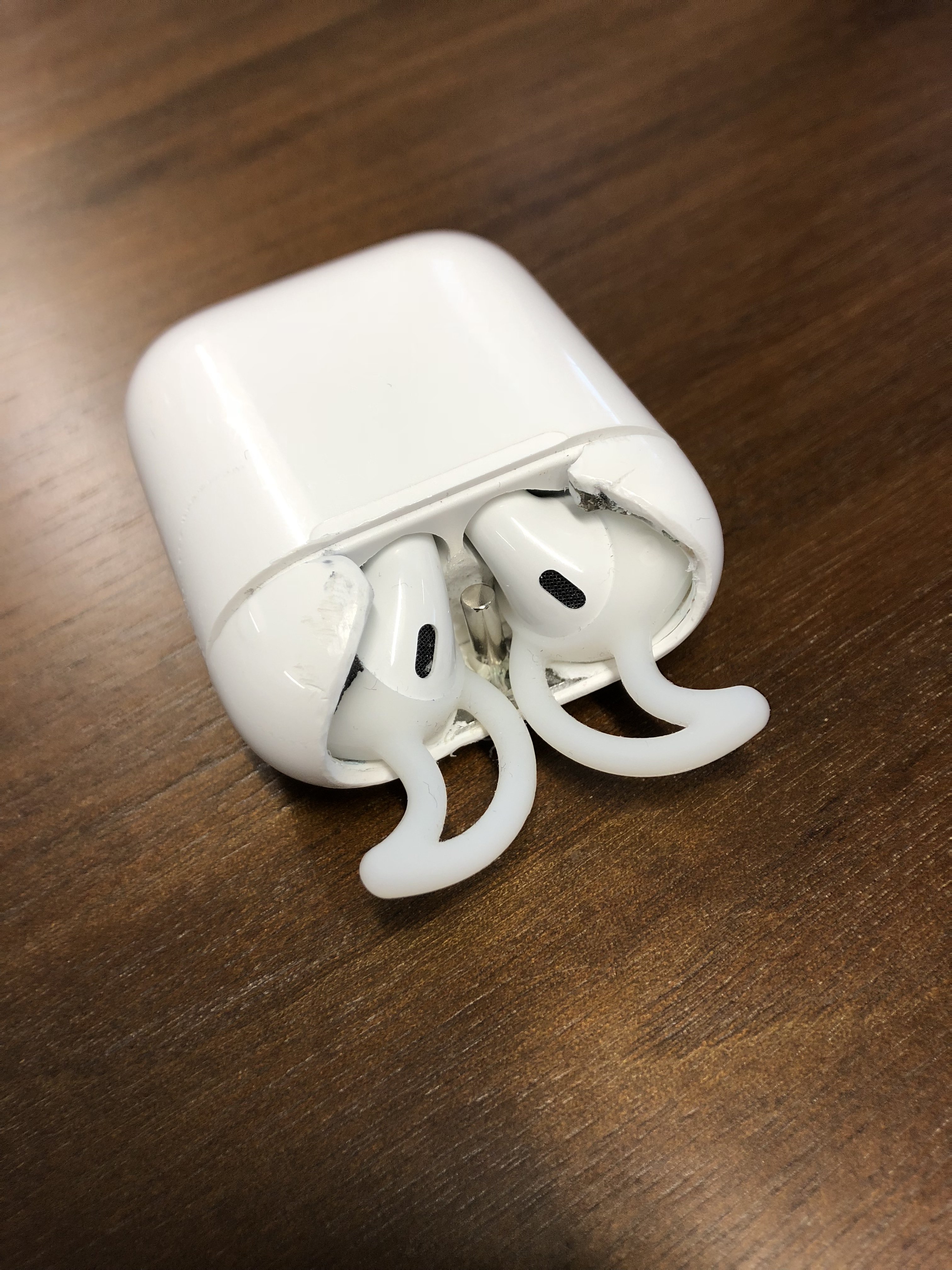

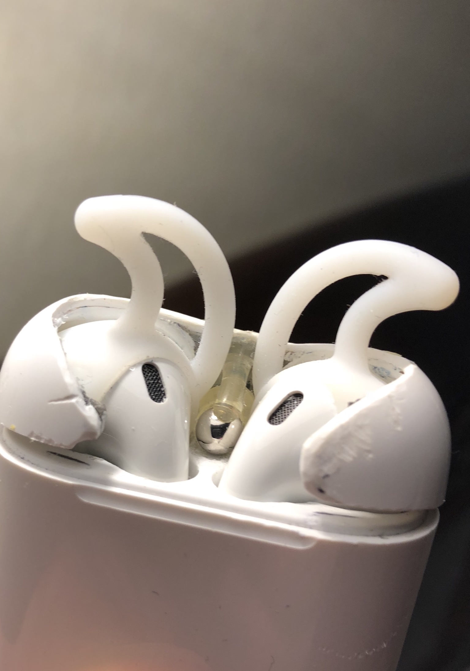

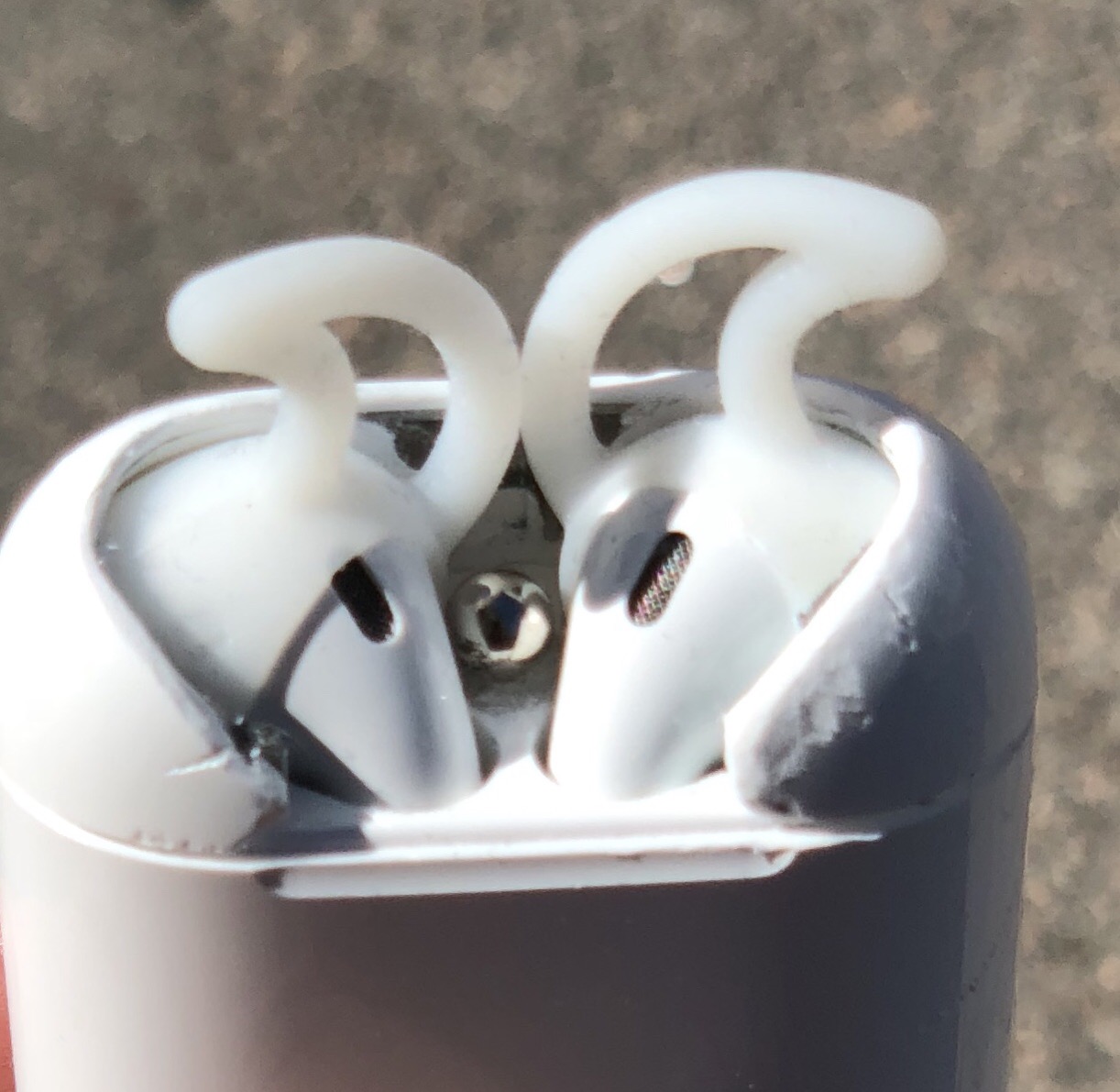

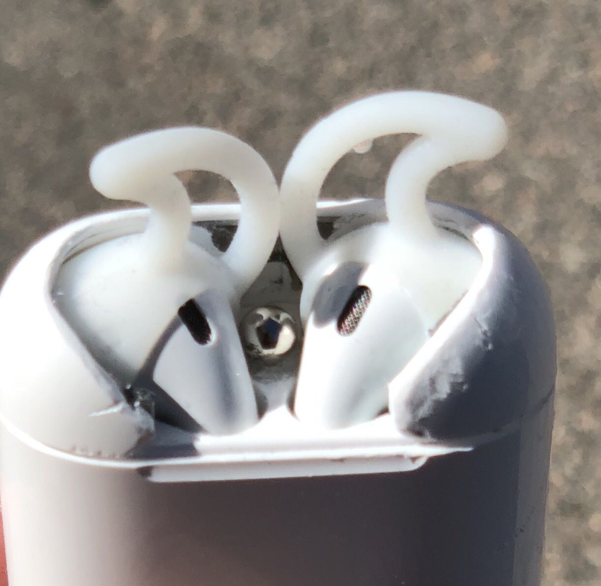

Airpods - ”designed” by Apple in California (to be inclusive for people with average size ears only) and made remotely usable by adventurous clients!
Airpods are part of Apples new line of products ”designed” to activate fine-motor skills and problem-solving thinking.
30 minutes with a Dremel. Not the safest of mods to be sure, but the only thing that does not work it the case thinks it’s open all the time.
, Staffan

Great idea! It now suits your needs. I would keep an eye on your battery as you may run into some battery loss/ usage as now the charging case (thinking its open) will be constantly searching for nearby devices to pair with. https://support.apple.com/en-au/HT207012 indicates that: Repeatedly opening and closing the charging case can reduce the battery charge of the case.

[doublepost=1529135496][/doublepost]Good point!

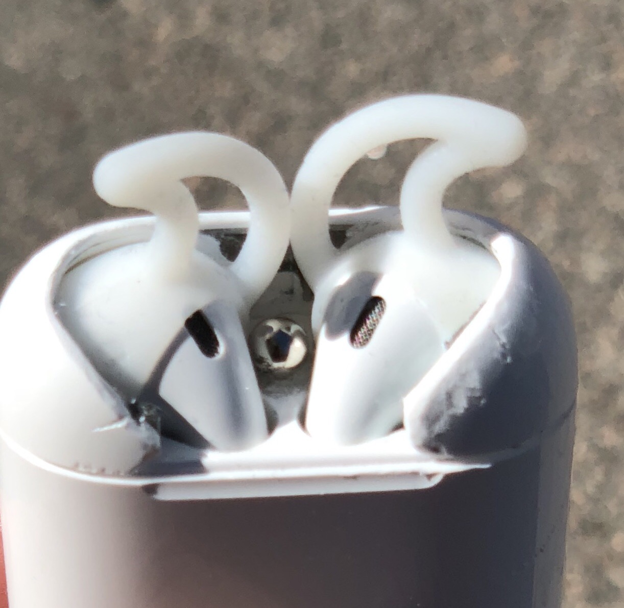

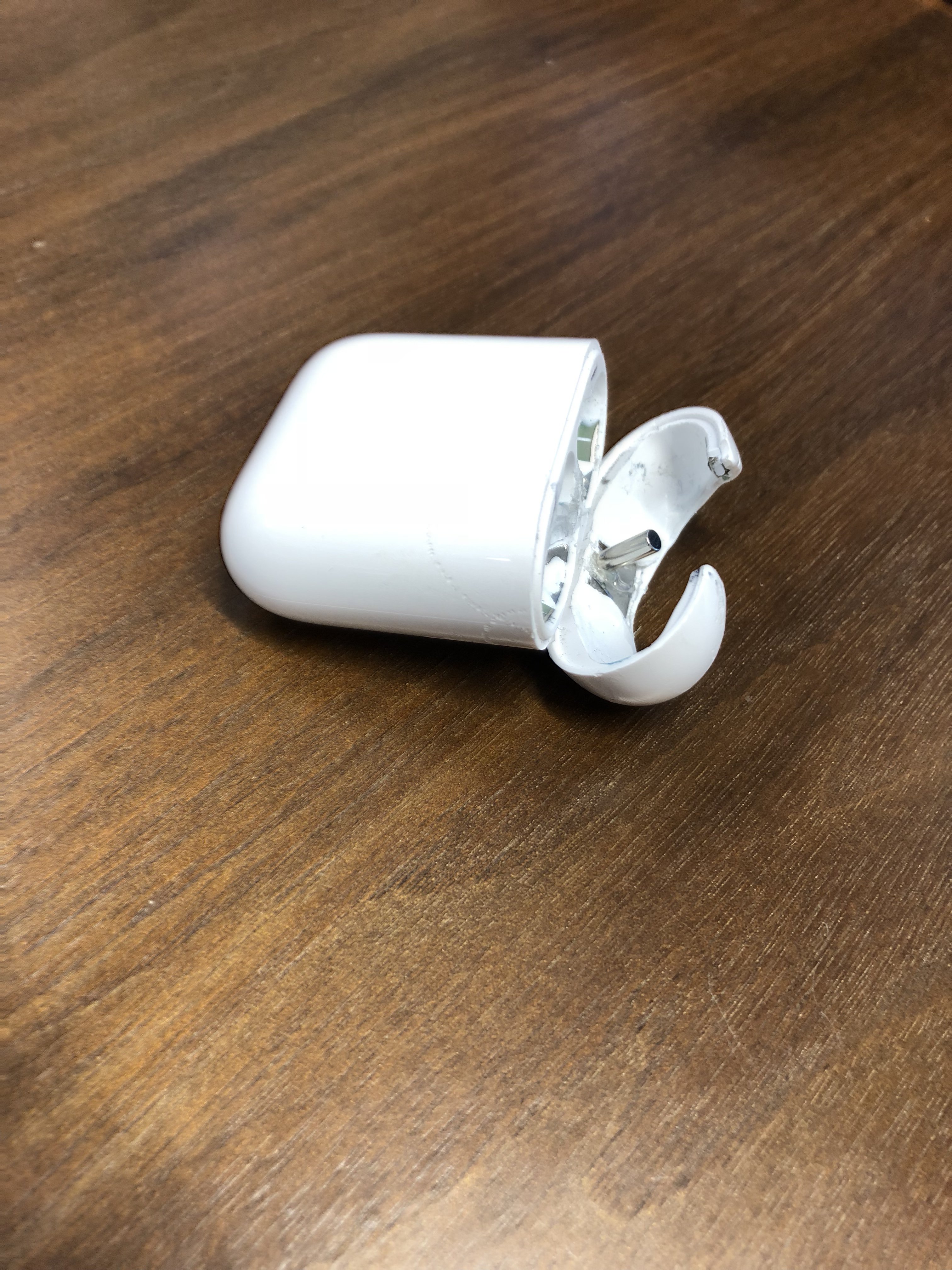

Enhanced version with a hot-glued magnet 🙂

Charging with eartips has been a problem many have struggled with. Yours is a very creative solution. Bold move. Bravo!

Thanks 🙂 (and yes - Apple engineers could have made a more classy solution 😀 which would have left the warranty alive also.
There is still one thing for me to figure out: I need to have a magnet activate/deactivate the mid-case sensor so the case it’s opened (and wakes up the earphones). It works without as well, but then the case&earphone are bluetooth-visible all the time which isn’t ver convienient

To be sure, it’s not necessarilly a case I would dare leave charging without over-sight
Being of the big-ear sub-species myself, my first experience of the airpods were that the sound was dreadful. Silicone tips made it much better (the foam-cover ”mod” is still maybe the best in my opinion - easy to do, fits in the case and has a surprisingly big impact on sound quality. To me, the case-mode become more of a challenge - a proof of concept - than anything else.
I have an additional pair if airpods and other earphones as well, so to me the warranty is not a game-stopper, even if these are now a potential short-circuit risk. Latest and ugliest has a hot glued magnet in the case-cover. The case now knows when it is being opened.

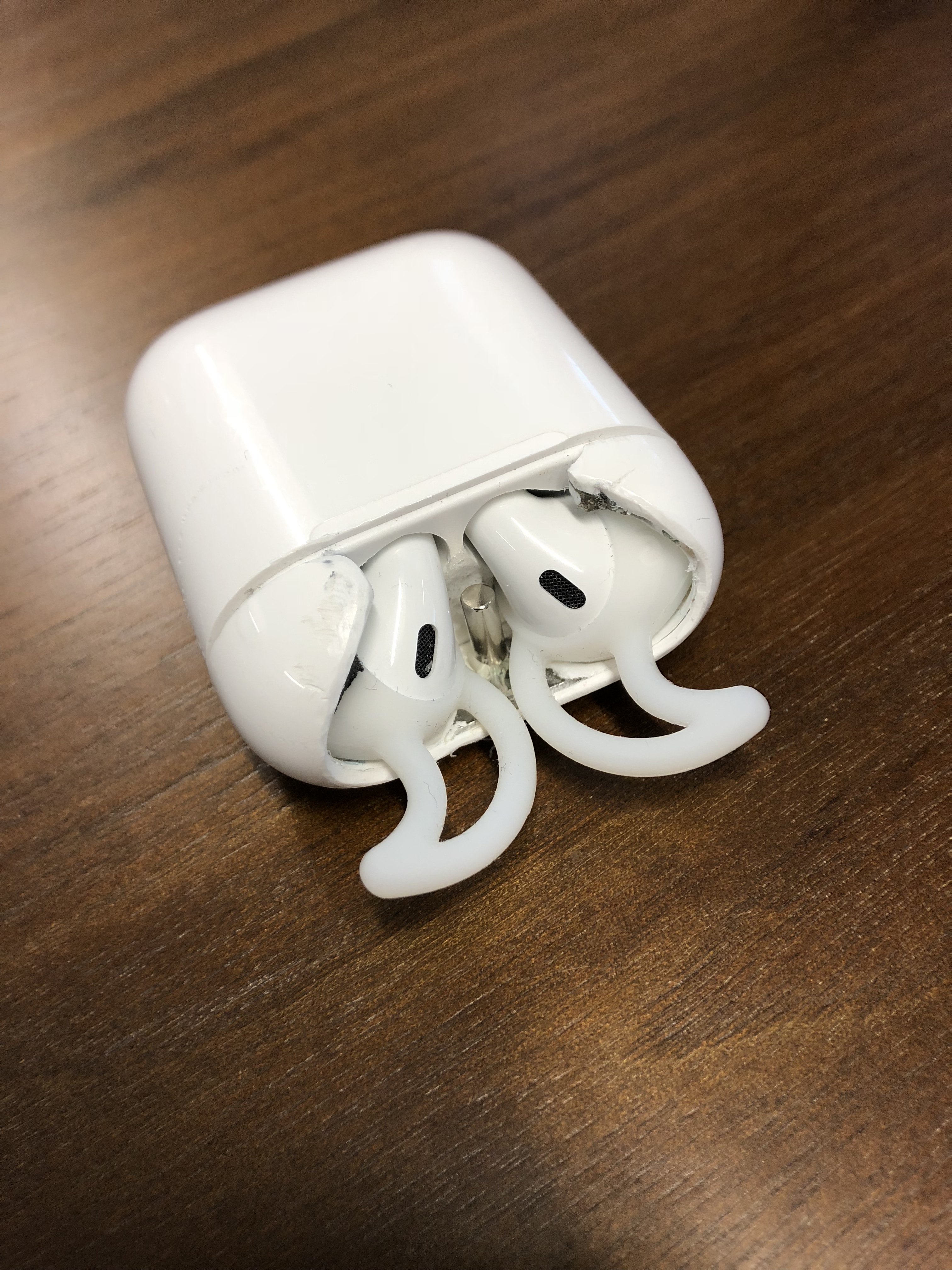

I now this could/should be safer and less ugly - but I have proven it to work - challenge handled

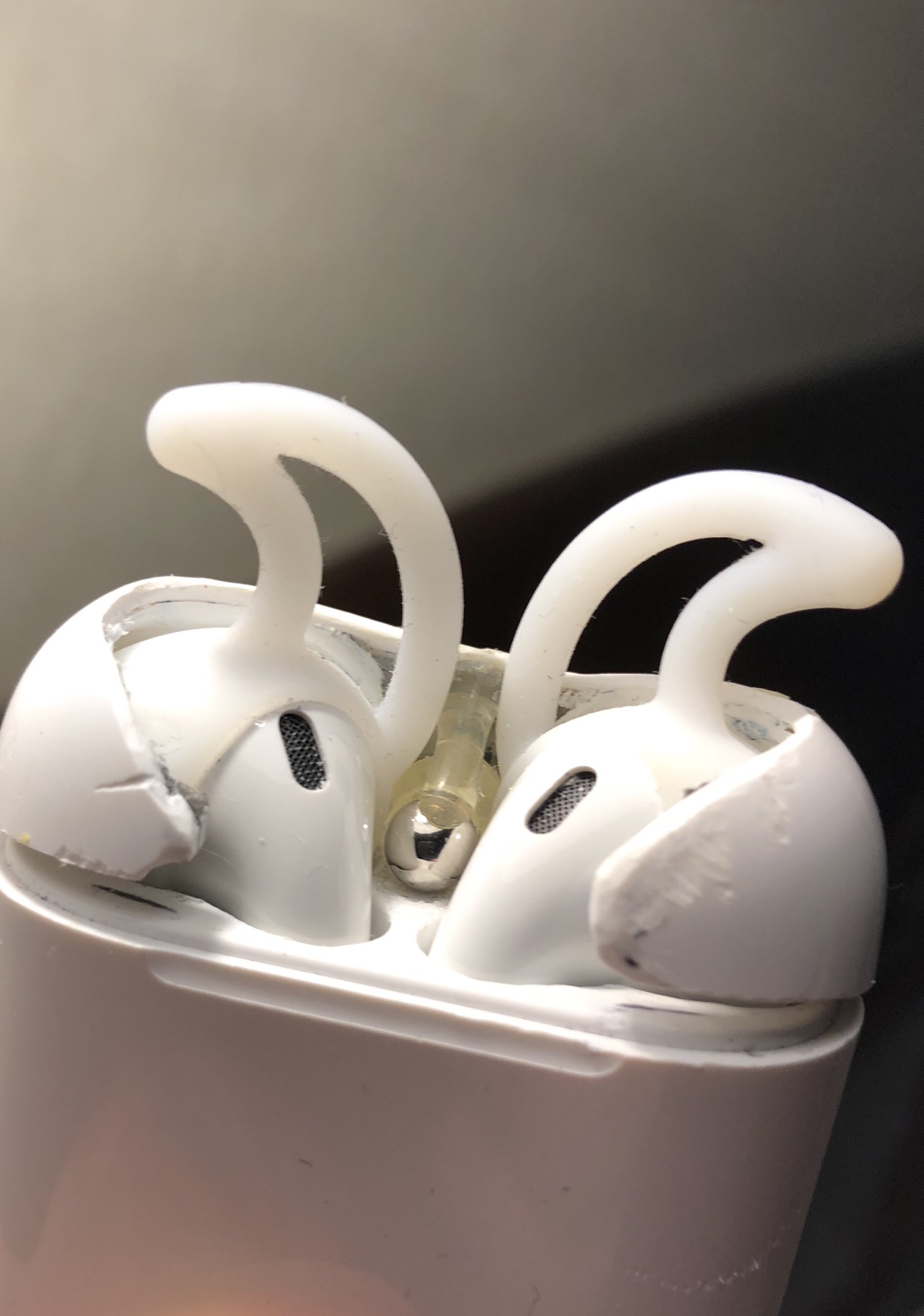

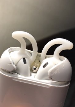

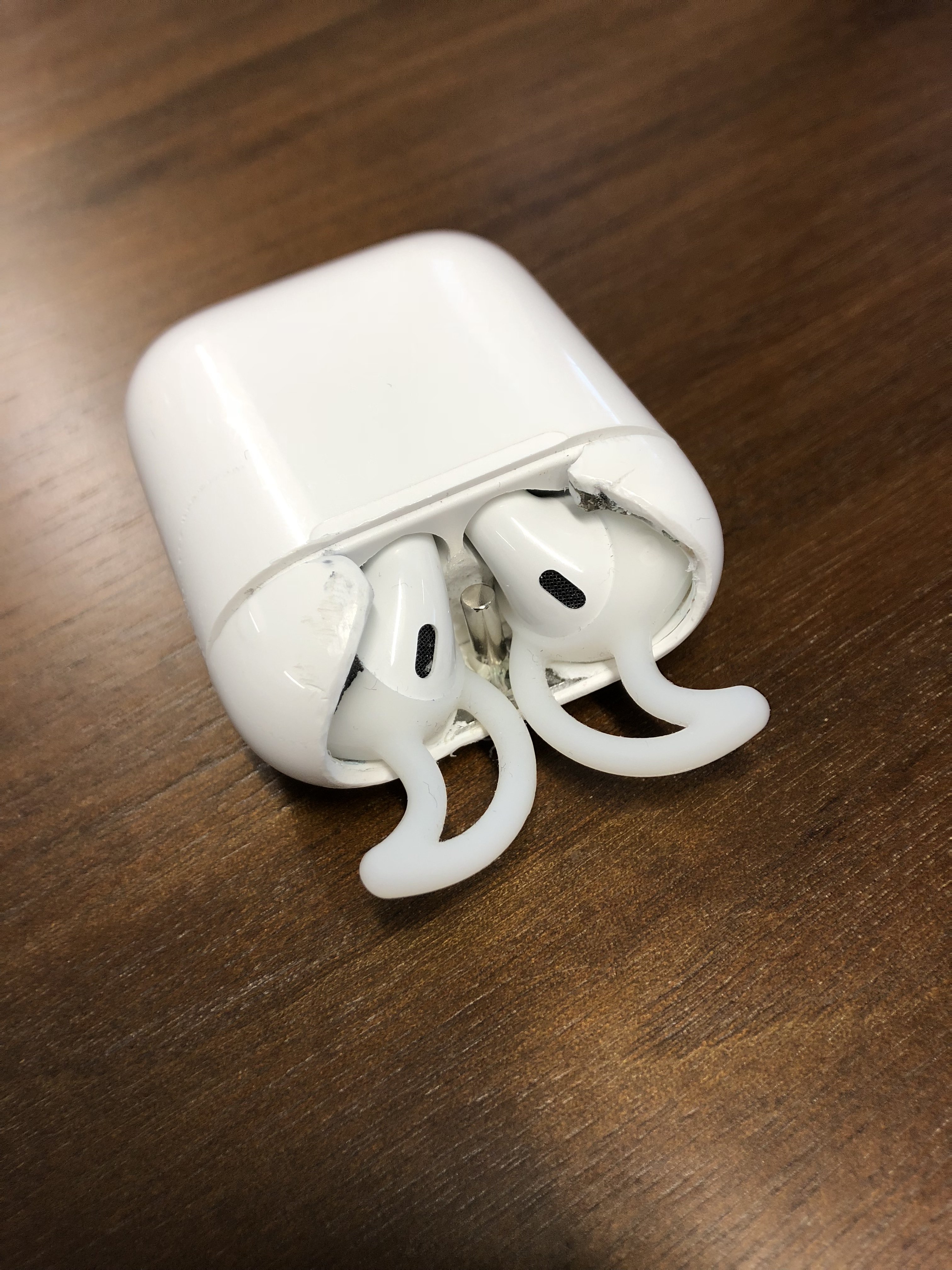

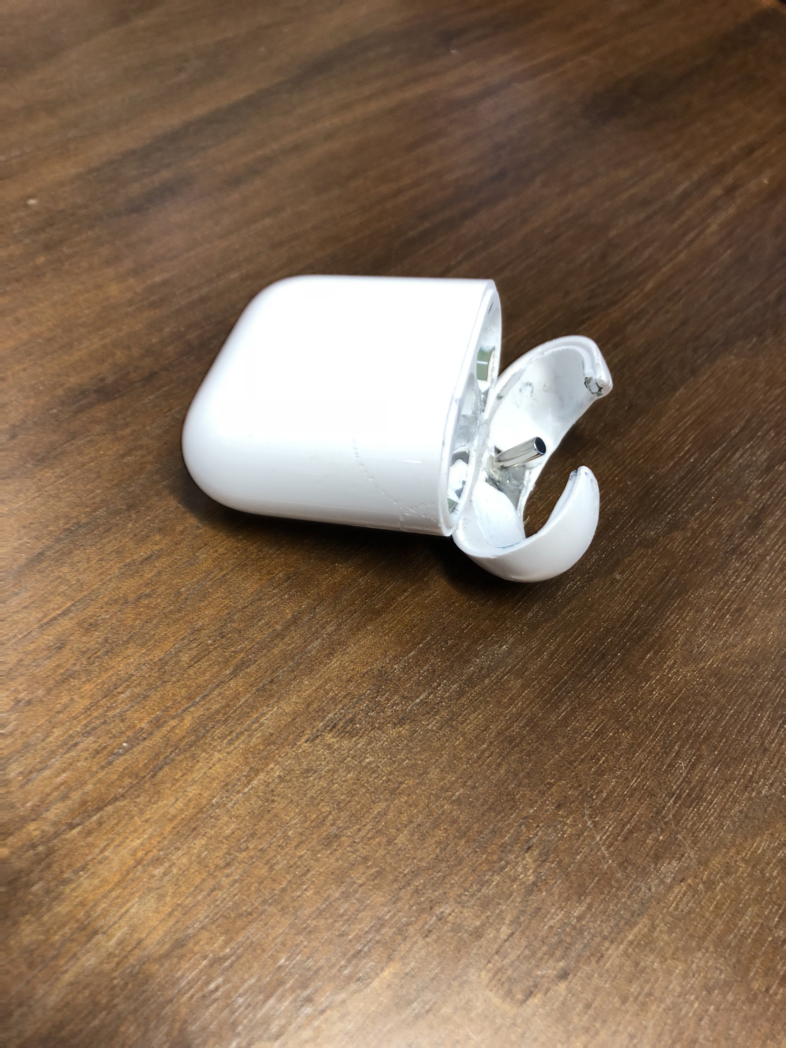

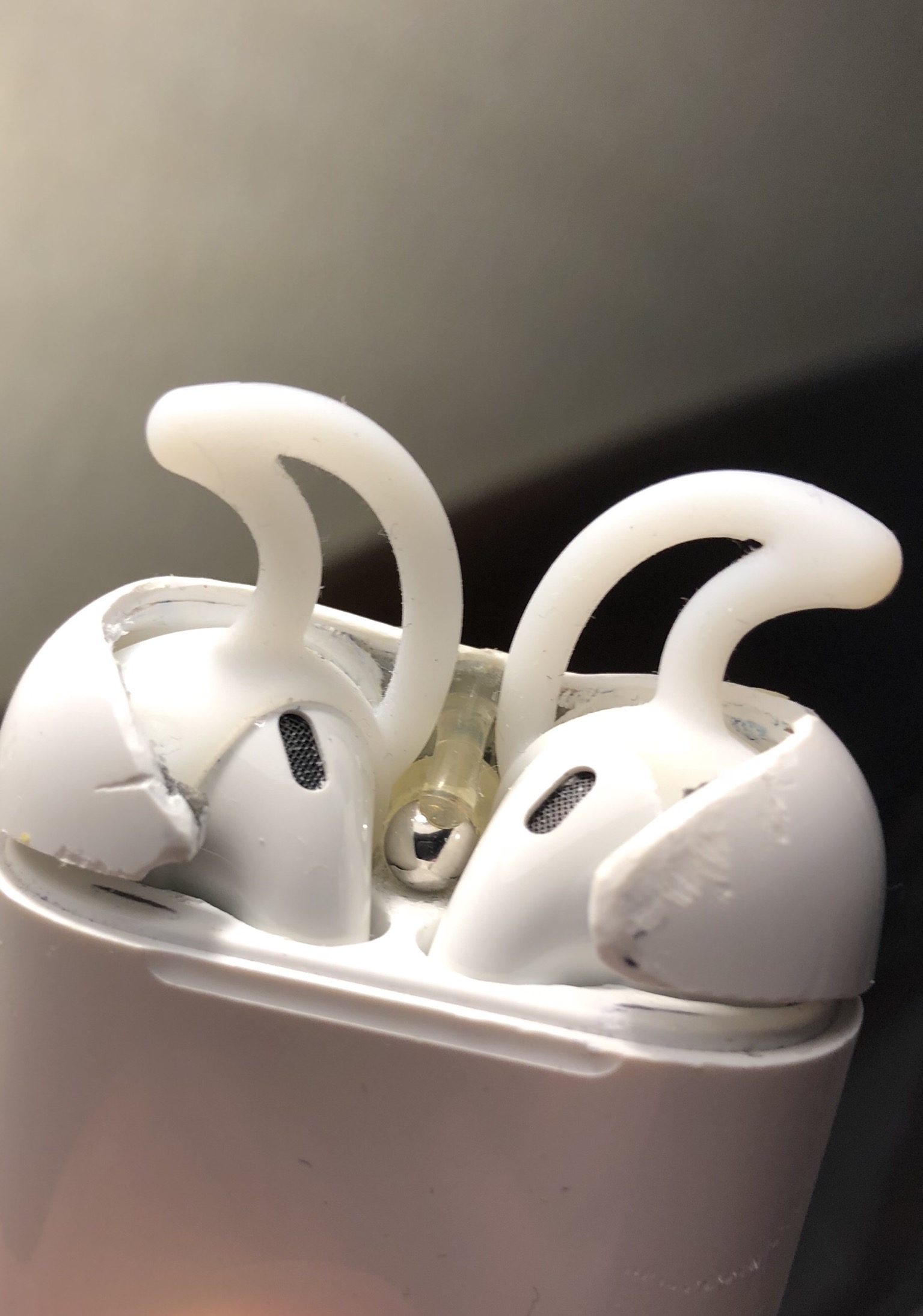

My final iteration. A small (3mm diameter x 8mm length) magnetic rod hot-glued to the cover-portion of the case. The case now knows when it is open or close and closes easily.
Works like a charm! However I take no responsibility for any damage anyone else might be caused by - in a fit of lunacy - trying the same mod 😀

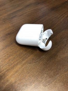

This is exactly what I was looking for! I was about to do this mod myself with no knowledge of what was hidden in the lid, so thank you for sharing. I totally agree with you that the Airpods are basically unusable given the size of my ear-holes -- but thankfully I found those same silicone covers on Amazon and they make the Airpods perfect! My only hang-up was not being able to fit them in the charge case.
If you were to do it again, do you think it would be possible to cut around the existing magnet placed in the lid by Apple or is it necessary to go the route you took with glueing in an aftermarket magnet?

Thanks for an excellent mod. I concur with others who have stated that the warranty issue is your own business. If someone thinks a mod is useless they have the option of simply not doing it. There is no need to criticize others' ideas.
With that said I have a question regarding the actual modification. I use the same EarBuddyz EarHooks and am unable to charge them, even with the lid open, because with the covers on the contact tips do not reach the charging contacts at the bottom of each of the AirPod slots in the case. My thought was to "file" down the edges of the tops of the case where the AirPods sit so that they could slip a bit further down and thus reach the contact points at the bottom of the case.
Is this something that you did in your modification but didn't describe? If not, I don't see how the AirPods could be charging with the EarBuddyz on despite the modifications to the lid.
Can you clarify? Thanks.
