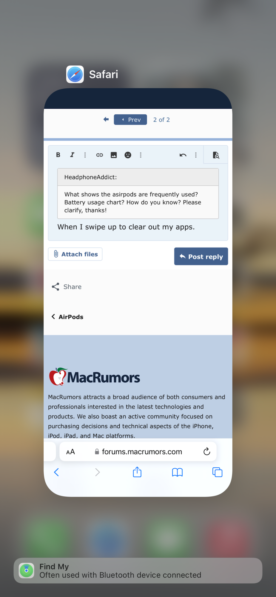

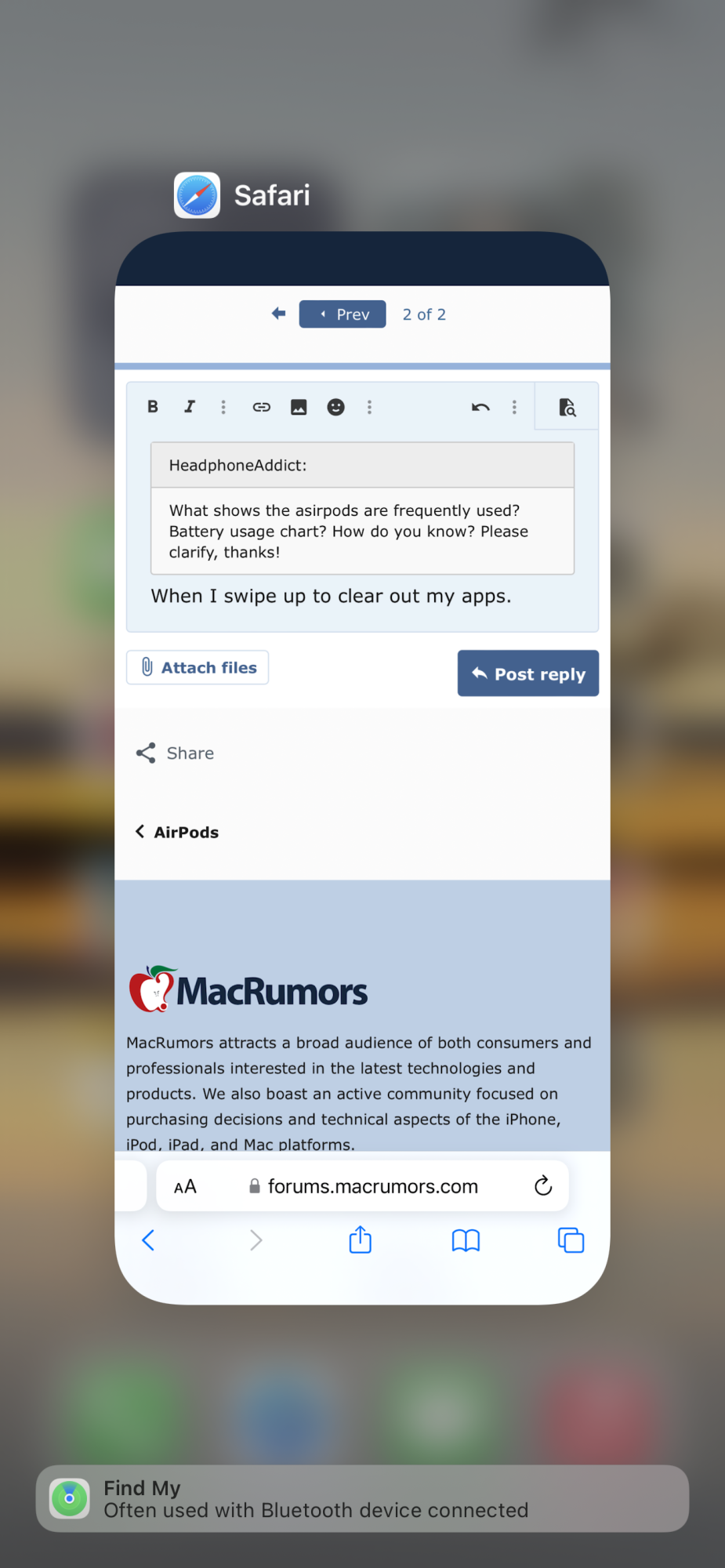

When I clear out my apps the little icon at the bottom shows they are frequently used by find my , but it’s not even connected to find my

When I clear out my apps the little icon at the bottom shows they are frequently used by find my , but it’s not even connected to find my View attachment 2089858
Okay. But I'm in trouble shooting mode and wonder if it is possible that it's some other device using Find My via bluetooth? You may have to remove some other BT devices too get Find My to stop using up battery.
In my case, with early iOS 15.x versions when I had my iPhone paired/trusted to my iMac so the iPhone could be seen over Wifi, it was causing Find My to suck down my iPhone battery until I reset network settings to unpair my iPhone from the iMac (i.e. entrust the iMac). In your case I only see that something with bluetooth is using Find My, but I don't know if it's the AirPods Pro 2 unless you know that you only have the AirPods Pro 2 paired and nothing else using Bluetooth.
Make sense but I only see that if my airpods are in. Never any other time. Even with watch phone and iPad being the only thing connected to find my
