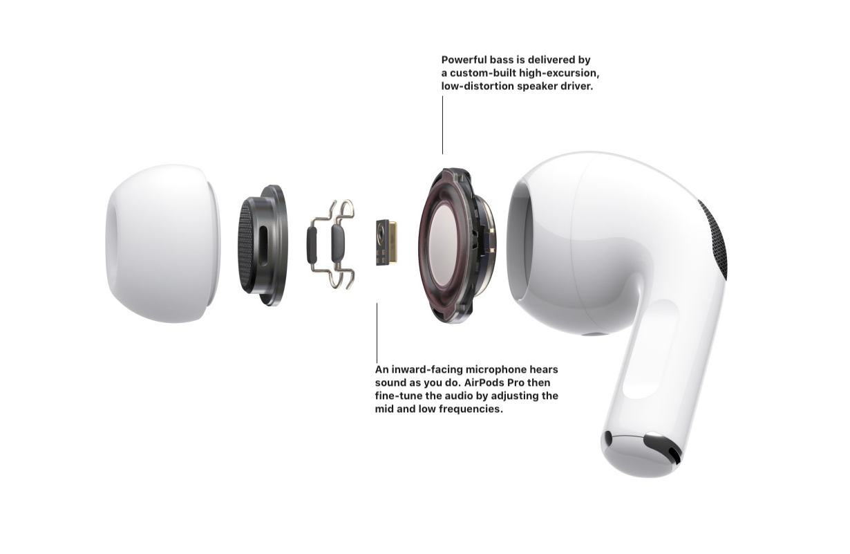

Found this image finally:
That's where the inward facing microphone is. You can actually barely see it if you pop off the eartip and look really closely with light at just the right angle. And while I was perusing, I found confirmation that it uses this mic to adjust the sound characteristics to suit your ear canal, and also uses it to run the fit test (the audio coming from the speaker goes into your ear, bounces back, and the inward mic listens to see if it sounds right according to its algorithms).
It looks like it's held in place suspended above the speaker with some clips. One guy said he could hear some rattling in his. Possible the inward facing mic isn't clipped into place properly in some of these and comes loose....(however, if airpods can pass fit test at any point, including putting finger over eartip or jamming into ears during test, then mic has to be connected, but not necessarily functioning properly)
Don't think it's loose or not working in my case... I'm still searching on my end. I'm going tonight at the Apple store. I'll let you know about the outcome
