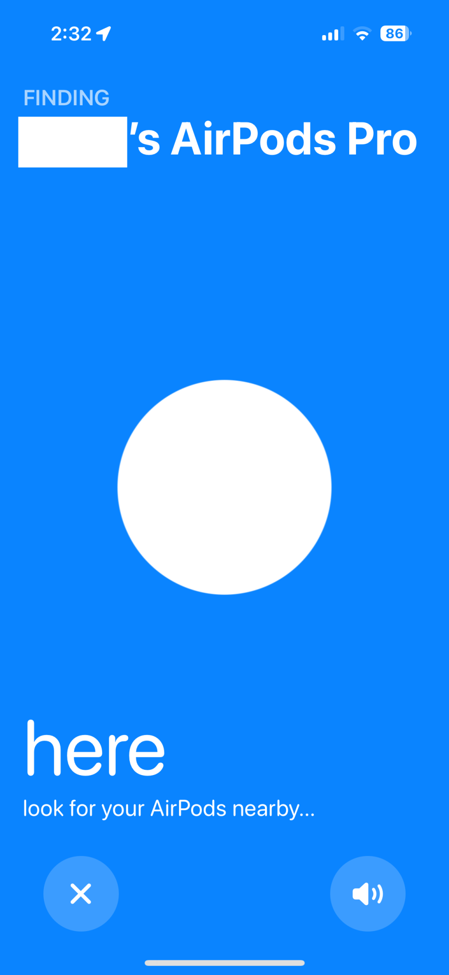

on most aipods, once the case is closed, the case powers down. So with the case closed, you get no pinging (either way), charging/battery indicator on the phone, or find my.
FWIW, mine are AirPods Pro. Case is closed with AirPods inside. Case has not been opened since yesterday.
I opened the Find My app, and it connected/located my AirPods in the house within 30 seconds... again, without opening or touching the case. There most definitely is some kind of two-way communication happening with the lid closed.
