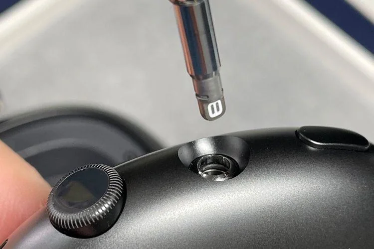

1. The AirPods Max ear cups don’t even have a physical connection to each other, at least on the lightning / V1. Power is always required because of the 2 H1 chips needing to sync as well as the internal ADC.
There are connectors on each end of the headband that look like tiny lightning connectors-- everything is physically connected through those
Yeah, that passes power not audio. It’s a real interesting design. I thought the same thing years ago until I found some spec write-up. It’s remotely possible they changed this for the USB-C variant but I doubt it.
If you recall some very old rumors, Apple was going to have hot swap bands initially and this is probably a hold over from that, if they started off the process knowing the band wasn’t removable I imagine they’d make a different choice.
Interesting, for some reason I assumed there would be one battery in each ear cup, but I guess that would be kind of a silly design in retrospect 🤣
So there is a battery in only one earcup. Interesting! When I got the battery service done on mine they replaced the entire right earcup, which I guess was just quicker and easier than disassembling it. I wonder if that's standard procedure with the battery service.
They also unexpectedly replaced the headband, so I ended up getting a pretty much entirely refurbished set for $89.

Like @novagamer mentioned, the two earcups are not directly connected (for purposes of transferring the audio signal). Even with a wired audio input, the signal will come into the right earcup via the wire, but then be *wirelessly* transmitted to the left earcup.
