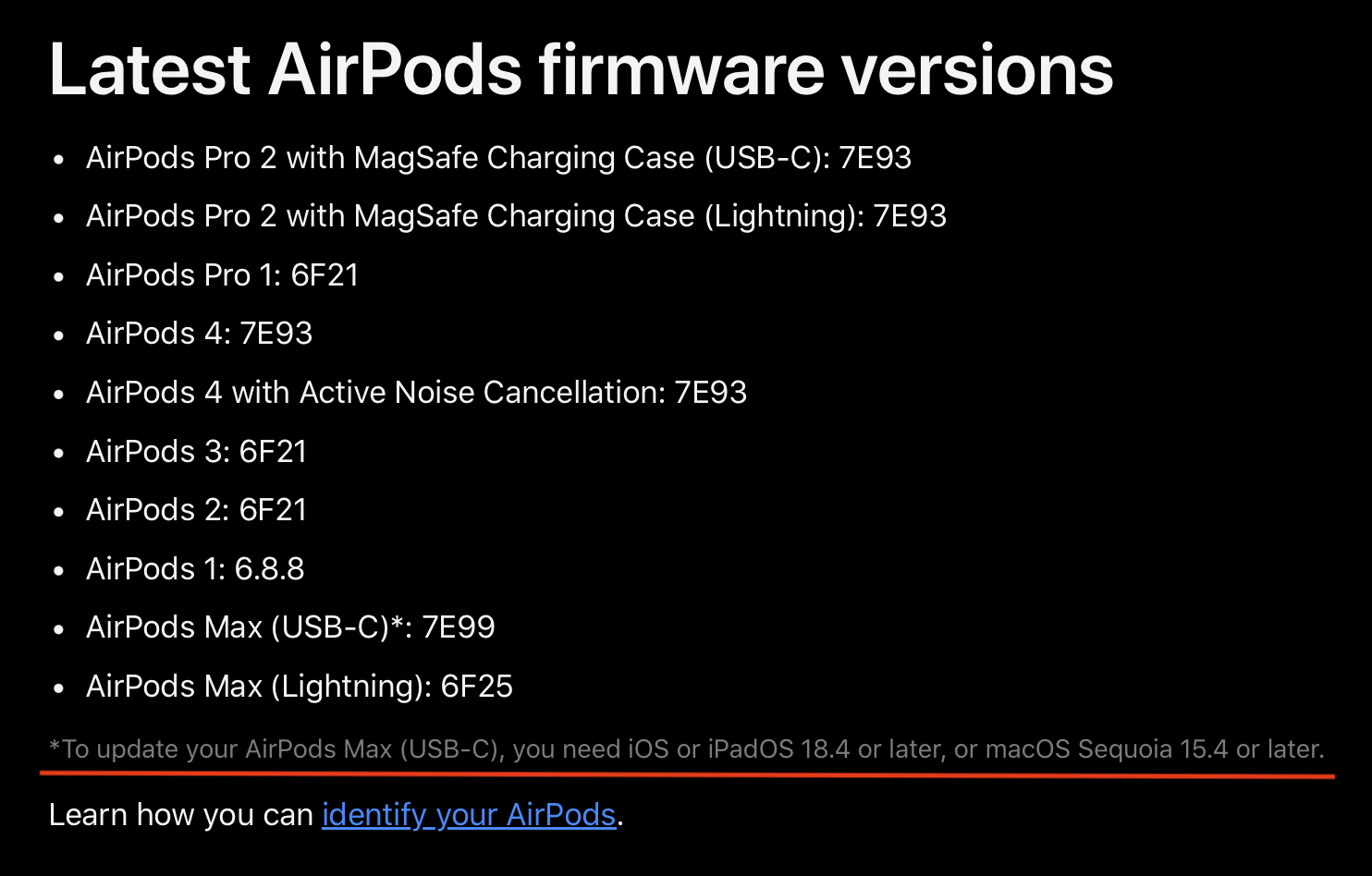

macOS 15.4 / iOS 18.4 are officially released. (Same as the RC2 builds from late last week.)
Based on Apple's press release from last week, I was expecting a firmware update that would enable the USB audio functionality to drop at the same time. However, the AirPods firmware page is not listing a new firmware version for AirPods Max — https://support.apple.com/en-us/106340.
I am not sure how quickly that page is updated when a new firmware version drops, there could be a new version of the firmware available and it is just not listed there. So, I'm going to go plug the AirPods in for a while and see if a new firmware version will get installed...
The AirPods firmware page is not listing a new firmware version for AirPods Max — https://support.apple.com/en-us/106340 — but I am not sure how quickly that page would be updated when a new firmware version drops.
Going to go plug the AirPods in for a while and see if a new firmware version will drop down...
I don’t think Apple plans to release the firmware update until April.
Sorry if something was unclear. The headband indeed only transmits power, not data. Data between the earcups is transmitted wirelessly, even if the audio source to the headphones is wired.
The cable is "bi-directional" but it can only work in one mode at a time. If you hook it up to AirPods Max, it will be analog-to-digital (audio input). If you hook it up to the USB-C port on your iPhone, it will be digital-to-analog (audio output).
I’ve heard it both ways honestly. Someone said the AirPods Max only have one H1 chip in the left earcup.
The press release made it seem like it was coming "with" iOS 18.4 / macOS 15.4. The batch of OS updates released today included other features previously announced for April (i.e., Apple Intelligence for visionOS).
Anyway, the Apple site that I linked to above now lists a new version of the firmware, 7E99. Got to figure out how to get my headset to update. I left it for an hour charging in the case and it did not, but I might have been "too early".
Version 7E99 release notes​
  • When used with an iPhone, iPad, or Mac running iOS 18.4, iPadOS 18.4, macOS Sequoia 15.4 or later, AirPods Max with USB-C and firmware update 7E99 enable lossless audio and ultra-low latency audio for the ultimate listening experience and even greater performance for music production, content creation, and gaming.

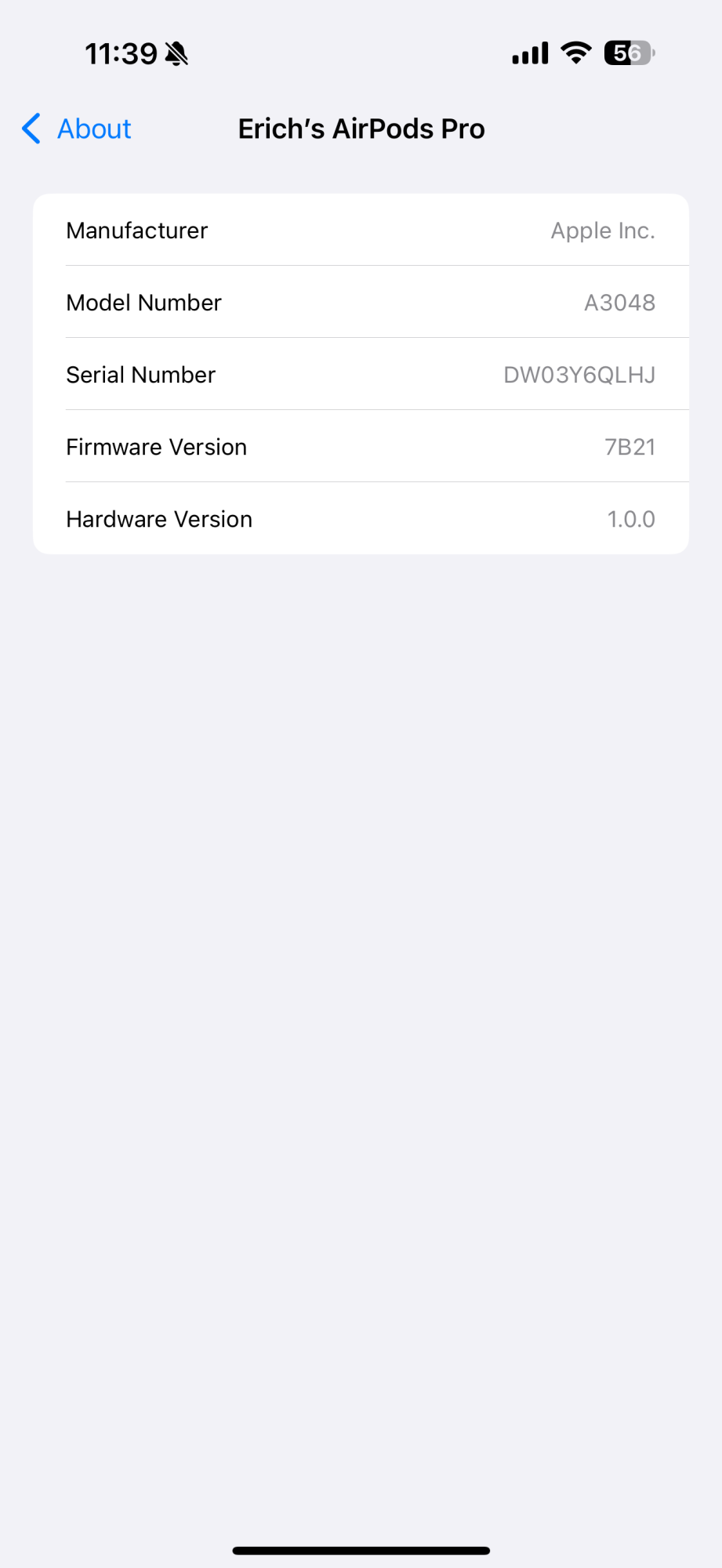

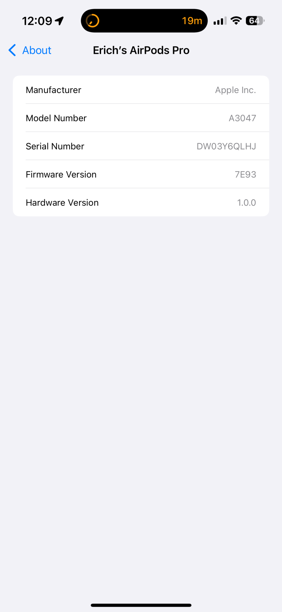

Some movement… I was able to update my USB-C AirPod Pros
This might be useful to some....you have to have already updated your iPhone to 18.4 or your Mac to 15.4 in order for the latest APM firmware 7E99 to become available to you. It won't update to 7E99 if you haven't already updated your phone or Mac.
