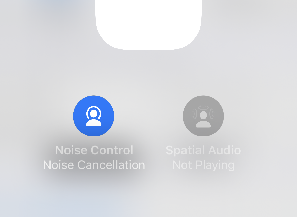

About a week or so ago, while using them for a call or listening to a podcast, I noticed they didn't sound normal. I was still hearing all kinds of background sounds coming through despite Noise Cancellation. It was so unusual that I had to go into my settings to verify that "Noise Cancellation" was still enabled; and it was...

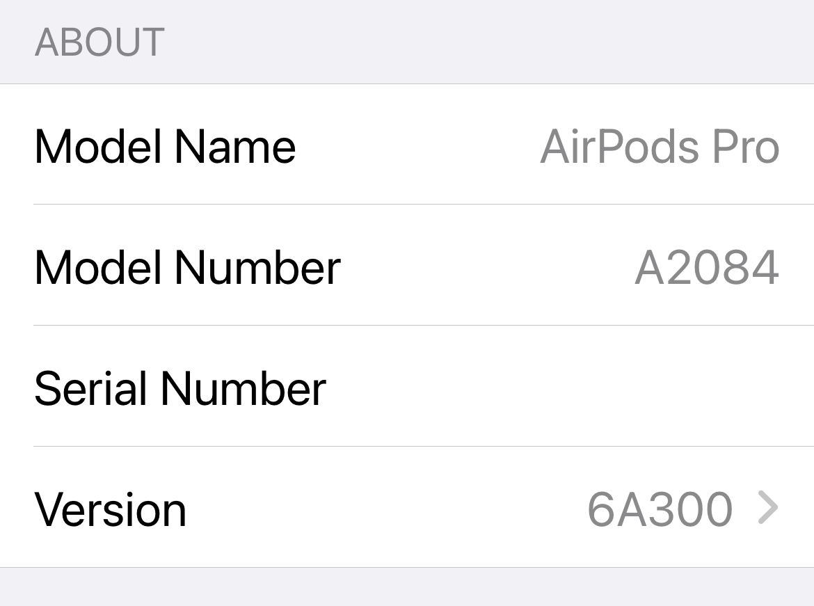

I cannot blame the latest firmware update, since I only updated to 6A300 today and I noticed this issue about a week or so ago while on 5E135. It's possible this started a way more than a week ago, but I don't use them often enough to pinpoint exactly.

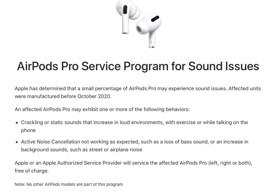

Cleaning may not be the answer. Apple replaced both of my AirPods last week (static problems) but even with the latest firmware (6A300) noise cancellation is not as good as used to be.
Reactions: sparky672
I may be misremembering, but I've read some people got them replaced even when manufactured after the October 2020. Maybe someone else can confirm.
I'm on an Apple support chat now. We will find out shortly.
EDIT: No dice. Mf'd 8/7/2021. I may stop into an Apple Store and try again.

That is not the case. According to Apple site, the latest APP gen 1 firmware is 6A300, which is the same as before iOS 17. I'm not saying Apple can't update them, but in this case, no firmware updates coincide with iOS 17.
Like I was trying to say, the APP have their own firmware and can connect to various devices that have nothing to do with iOS 17. So if they sound different on a Mac or Apple TV, blaming iOS 17 for how it works makes sense. Otherwise, if they sound exactly the same no matter what they are connected to, then it has nothing to do with iOS 17.

6A300
Which AirPods are you using? Pro1, Pro2 USB C, AP3?
I have the new USB C APP2 and it's supposed to be 6A301 but it's 6A300.
EDIT: I'm wrong. it is 6A300 for the APP2 USB C.
