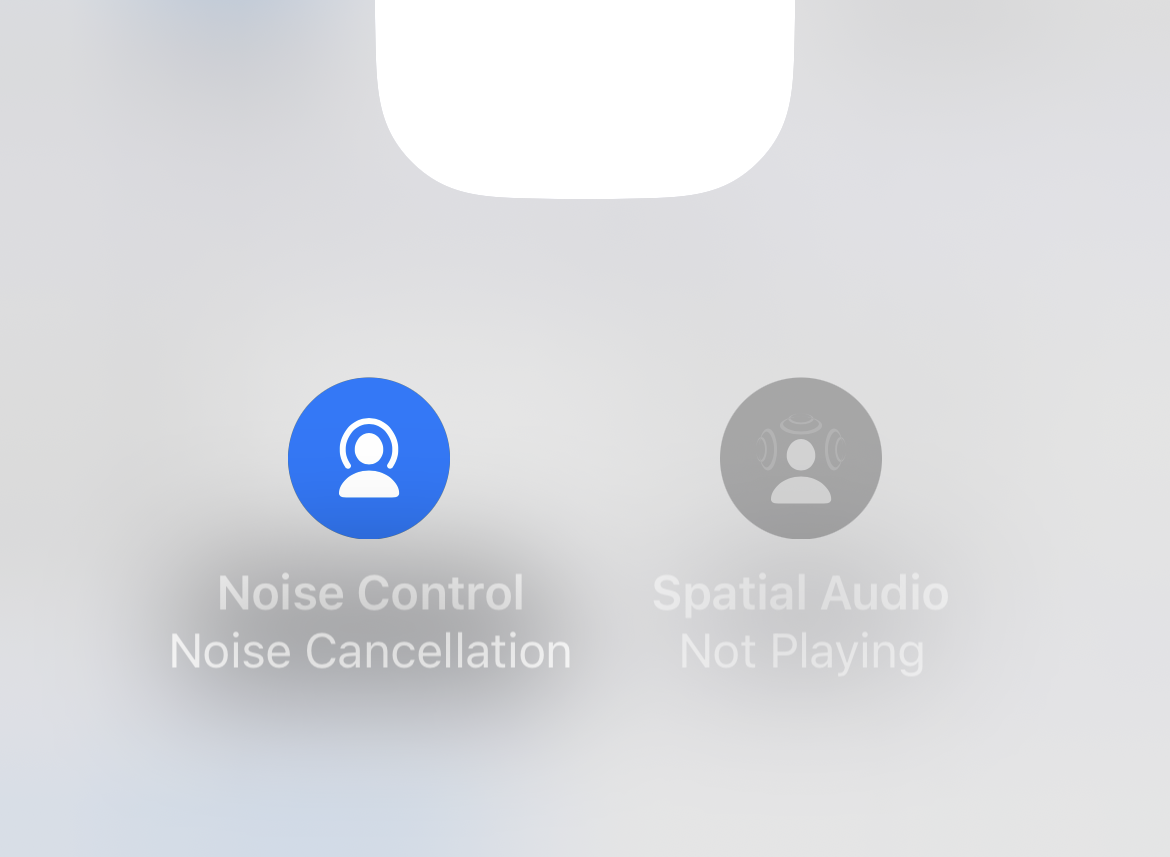

I've had my first gen AirPods Pro for almost two years so I am pretty familiar with how they've been working and how they normally sound. However, I use them somewhat sproratically.
About a week or so ago, while using them for a call or listening to a podcast, I noticed they didn't sound normal. I was still hearing all kinds of background sounds coming through despite Noise Cancellation. It was so unusual that I had to go into my settings to verify that "Noise Cancellation" was still enabled; and it was...
When I used to enable Noise Cancellation, it made the world sound like it was completely blotted out. I'd say something like 90% of sound was blocked. Even the noise of my window air conditioner was almost fully blocked out.
Now today, Noise Cancellation simply sounds like the world is a little muffled. I can clearly hear my dog's nails when he walks on the hardwood floors as one example - maybe more so since other sounds are muffled. When outside, I can hear wind noise, running water, and cars approaching from way down the road. These sounds used to be completely blocked.
I cannot blame the latest firmware update, since I only updated to 6A300 today and I noticed this issue about a week or so ago while on 5E135. It's possible this started a way more than a week ago, but I don't use them often enough to pinpoint exactly.
Is anyone else experiencing anything like this?

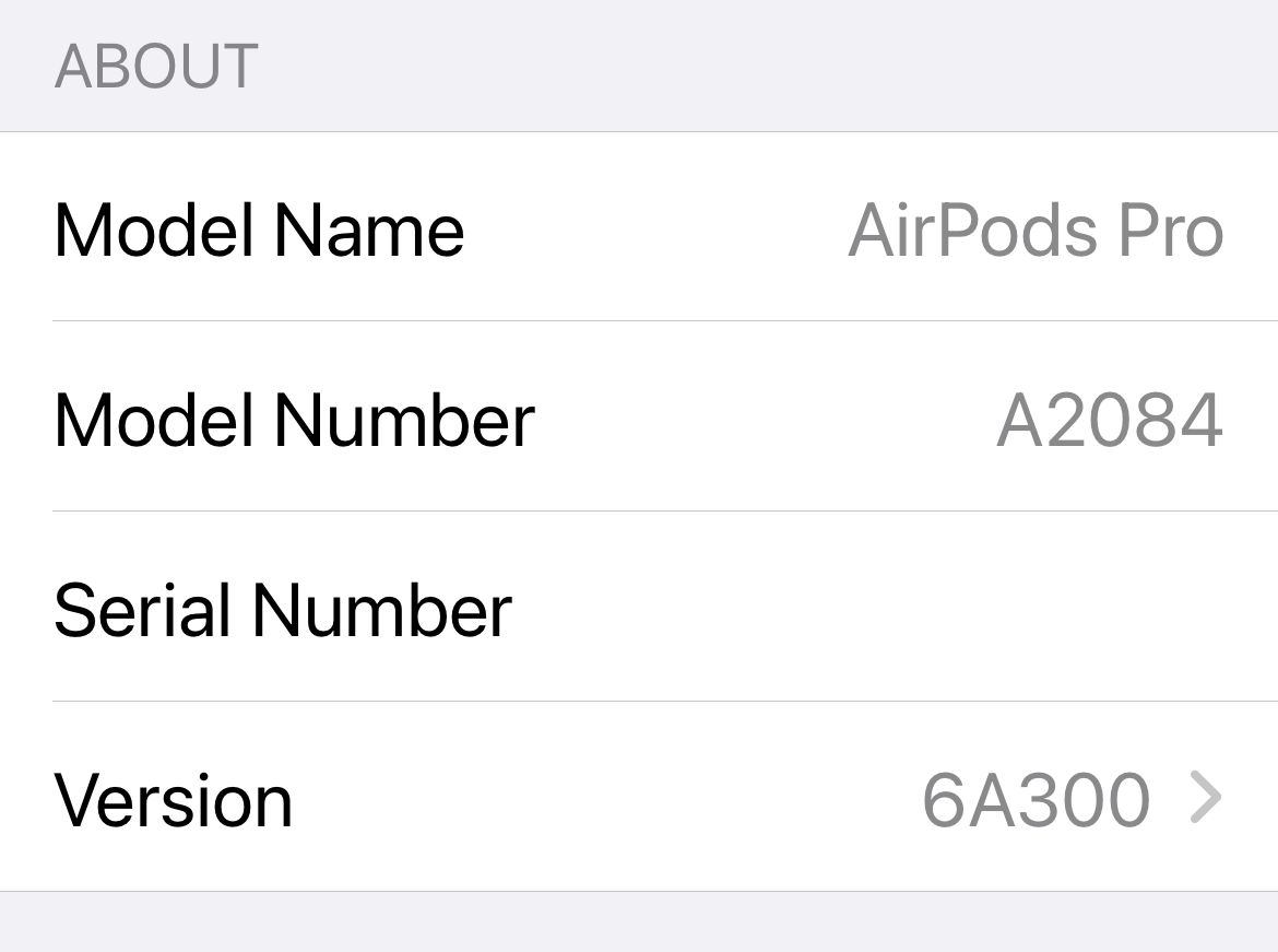

OK, so 3 weeks ago I noticed my APP 1 ANC was not as good as it used to be. I ran the fit test and could´t manage to pass it once.
I send em to Apple which they replaced both earpieces to brand new (Case still old one). The replaced APP 1 had firmware Vers. 4C165. I paired an used them. And it was AWESOME, the ANC was like 200% better then before and fittest passed.
I remembered that during firmware Updates the APP 1 and even 2nd gen got worse in ANC. So what to do, I read that you can really block firmware updates, so I forced it and got the current 6A300 fw. And what shall I say even with the new 6A300 fw, my ANC is awesome and fittest also.
Long story short, the firmware updates wont harm the ANC its more like the wear and tear which blocks the ANC mesh due to time
