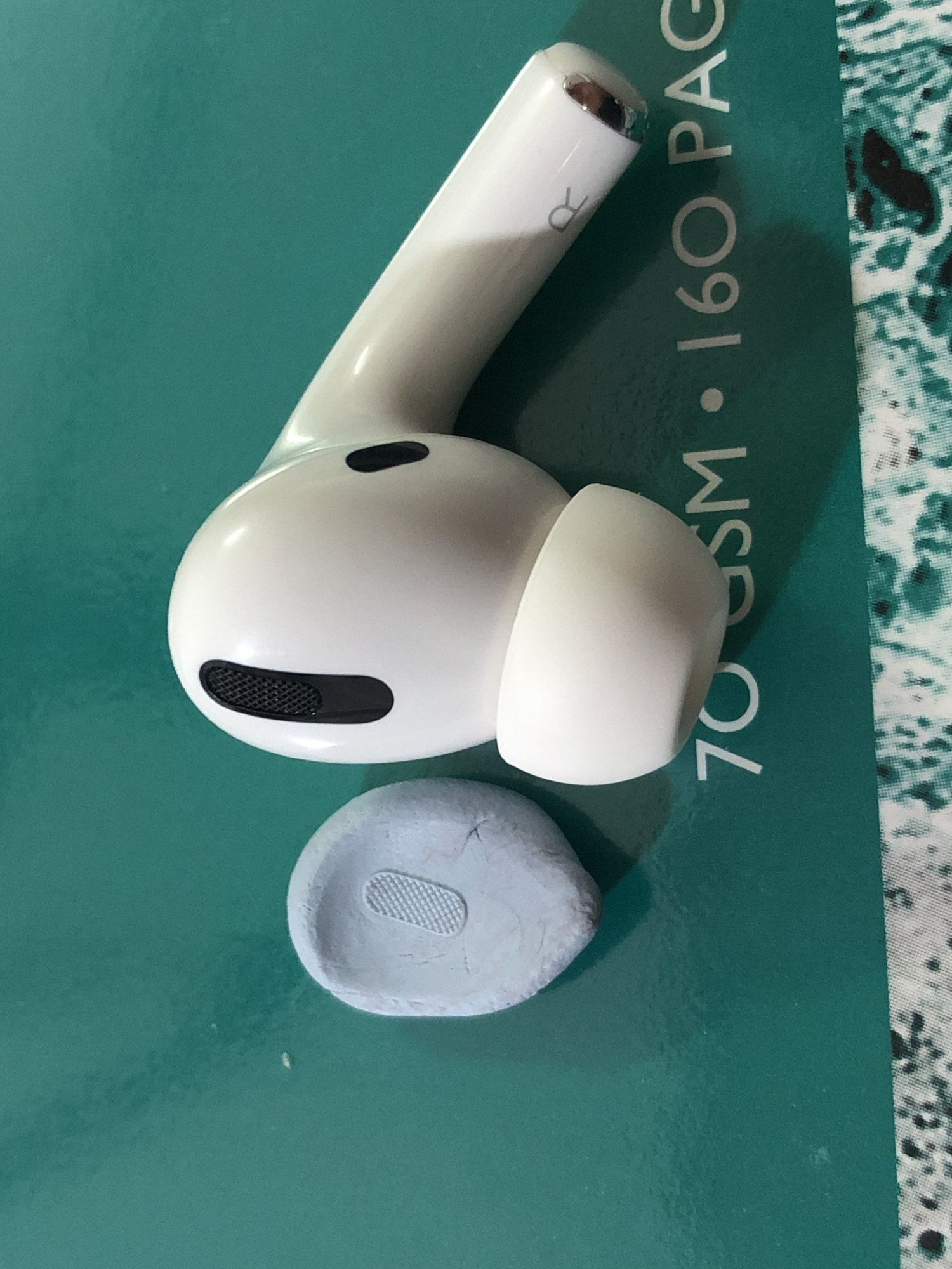

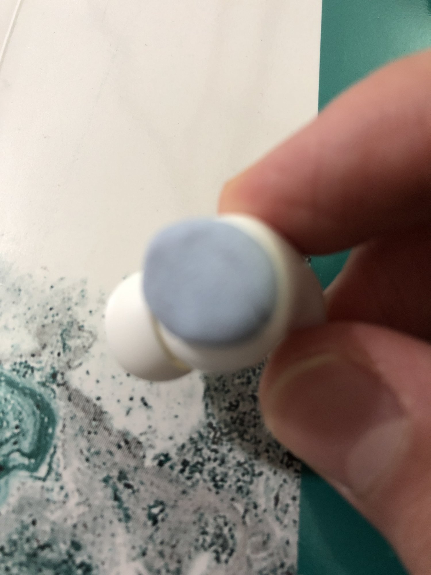

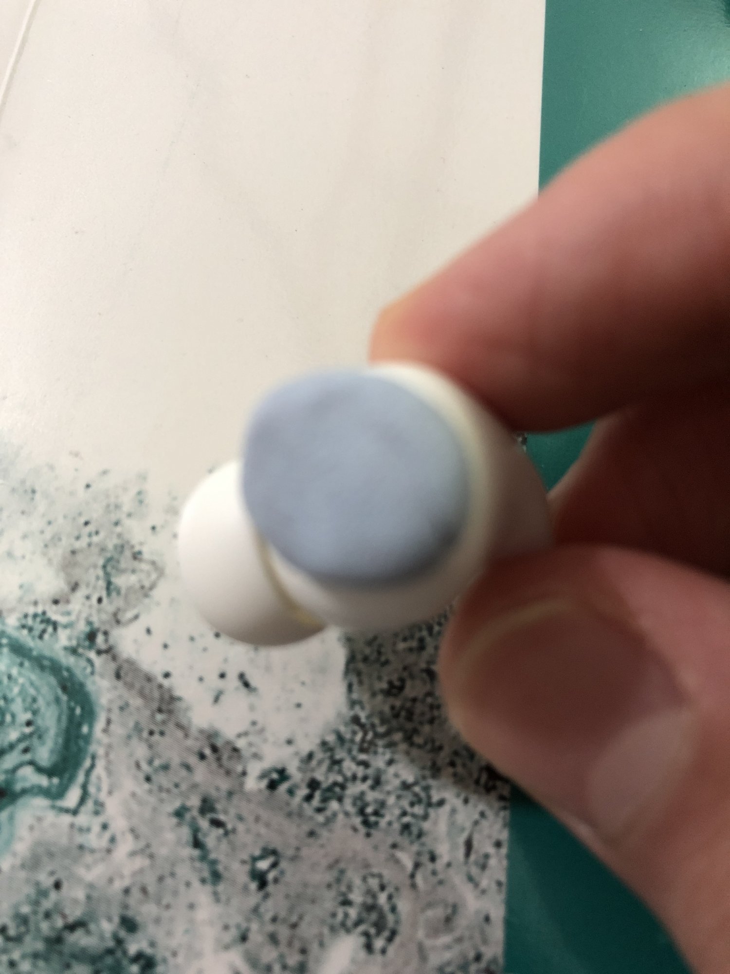

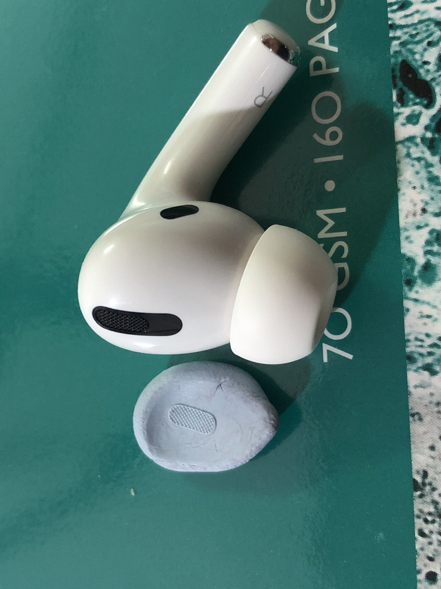

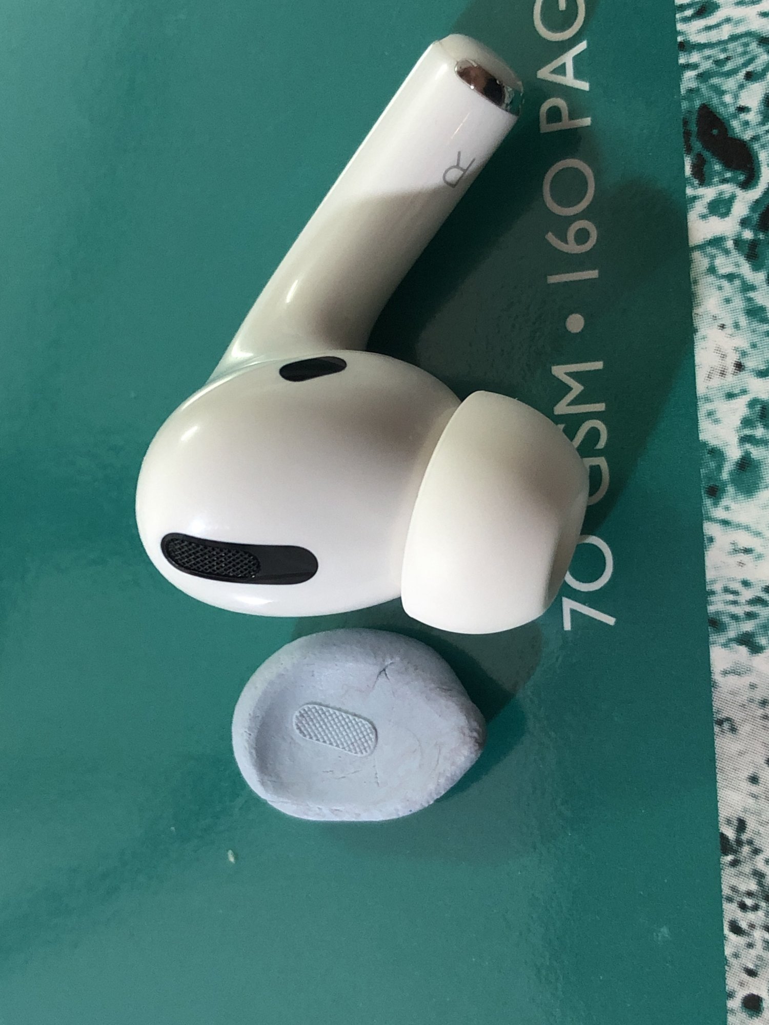

It is a hardware issue, I managed to fix mine. Just take some blue tack and force it into every hole in your AirPods. Then slowly SLOWLY remove each blue tack. Repeat this a few times on each vent and you will get perfect sound quality again. I don’t know where the inner and outer microphone is but if you know which vent has microphones in them just do the ones with microphones in them.
if you didn’t do it slowly and got some blue tack stuck in your AirPods you are stuck with 30 minutes of sticking and removing a piece of blue tack until it comes off. Good Luck

Thanks! The blue tack method works! Except that I don't have the blue tack, so I suck and blew the hole instead. And It's fixed in just one try! Thanks! You saved my life. 😇
Holy smokes... this WORKED!!!
Just returned from the Apple Store (9/14/22) and was told my pair has this known problem (AirPod Pros). However, because I purchased them just over a year ago, they were not eligible for the "Quality Program". The 3rd edition AirPods are coming out 9/16/22 anyway, so why buy a new pair.
A final attempt at an online search and BOOM... the suck and blow method worked like a charm. No more crackling noise! Thanks guys!!!

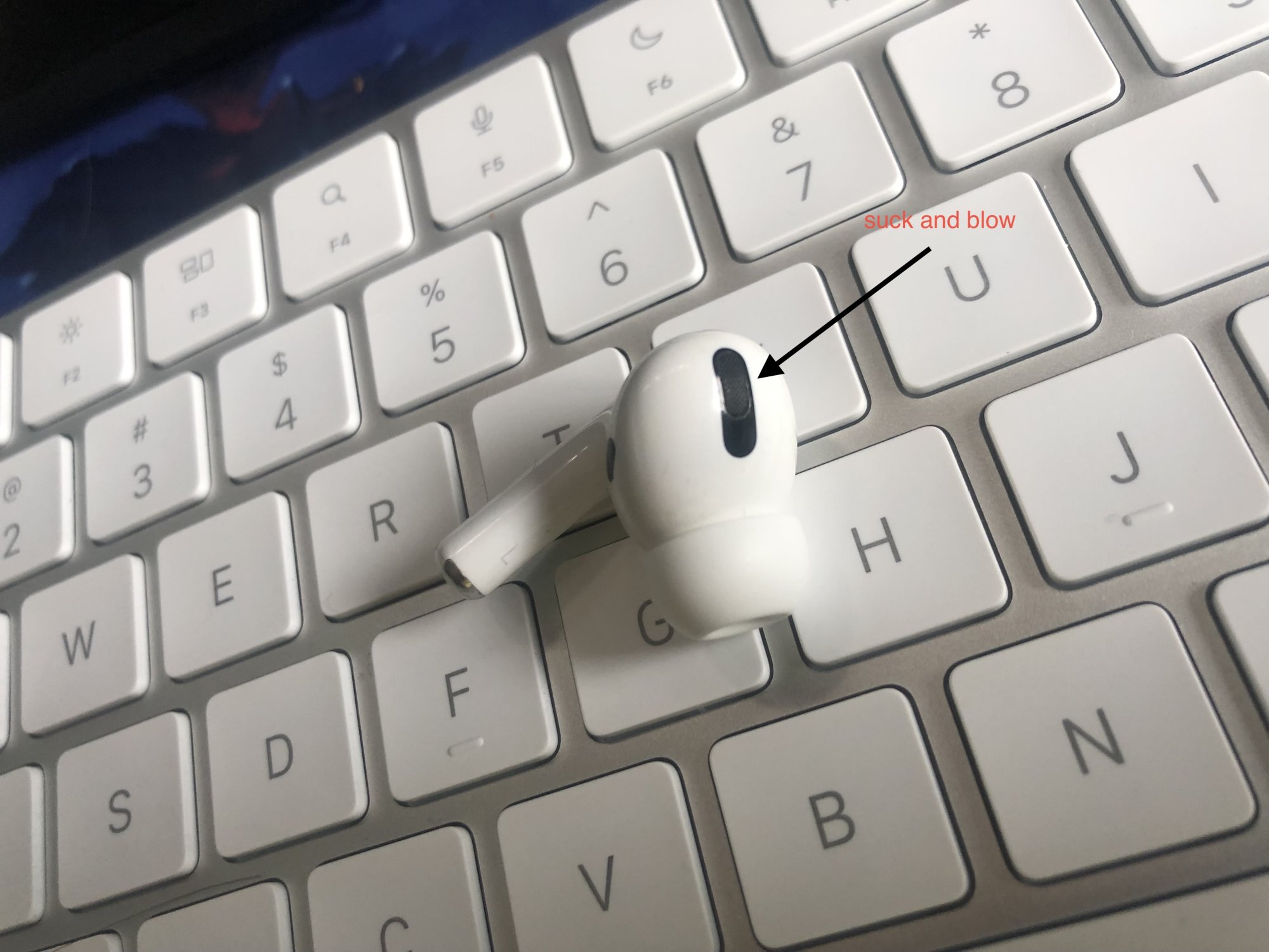

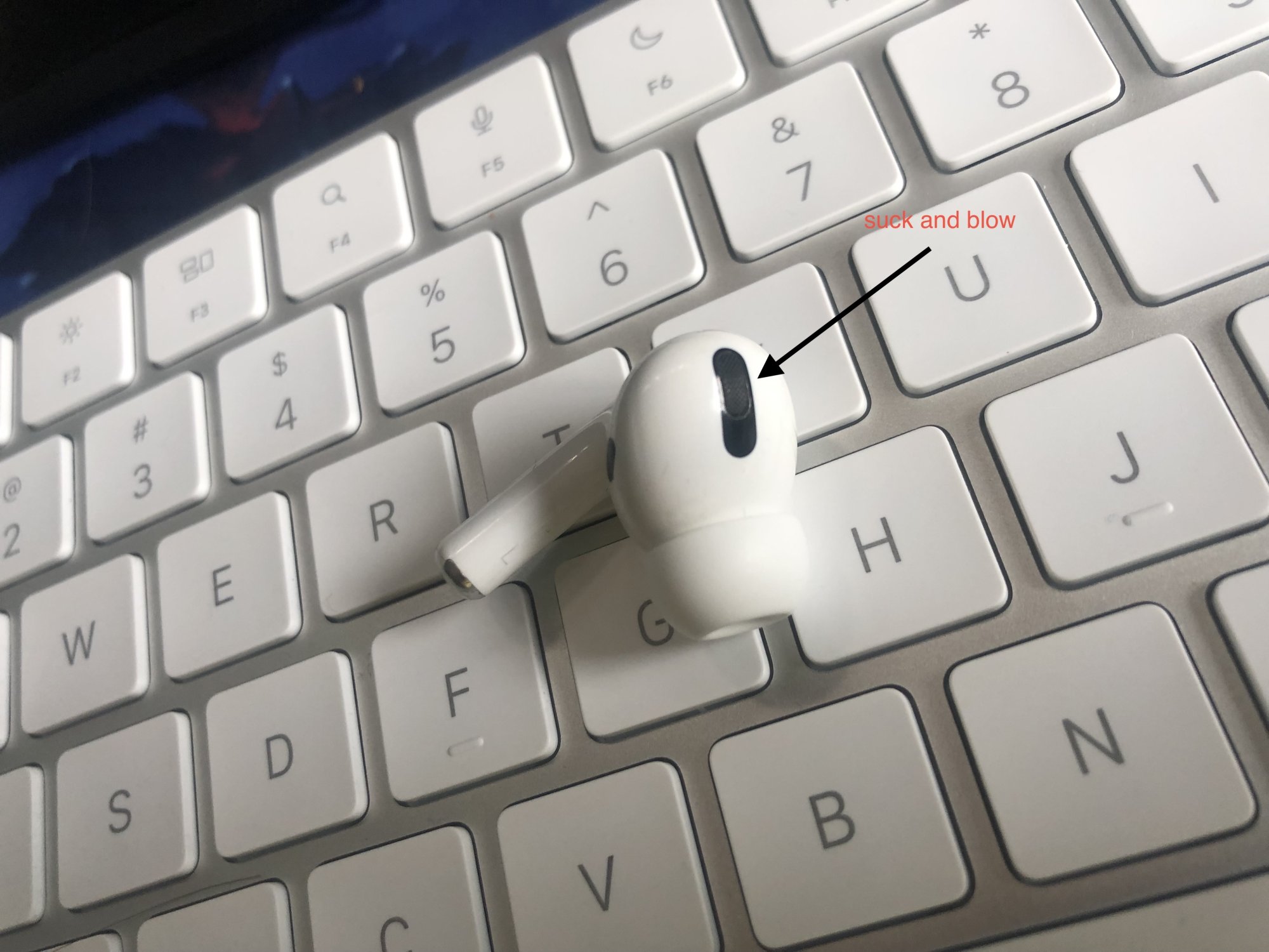

Hi ikeda,
I just signed up to say thank you. I had this issue, and was thinking of replacing them when I saw this thread.
It worked first time for me, so thank you so much for saving me a load of cash.
I thought it was odd, that turning off the auto sound stopped it. But once again. Your tip Worked well for me.
Thanks.
Thank you! I didn't have blue tack either, I tried the suck and blow method and it worked in the second attempt for me.
