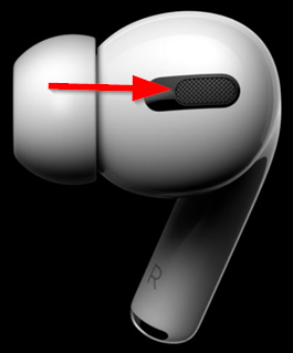

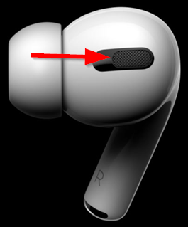

same here when I got the Foam Masters Premium Memory Foam Ear Tips, the right bud kept failing the seal test until I watched this russian guy so I sucked on ‘em. I am green now R/L
