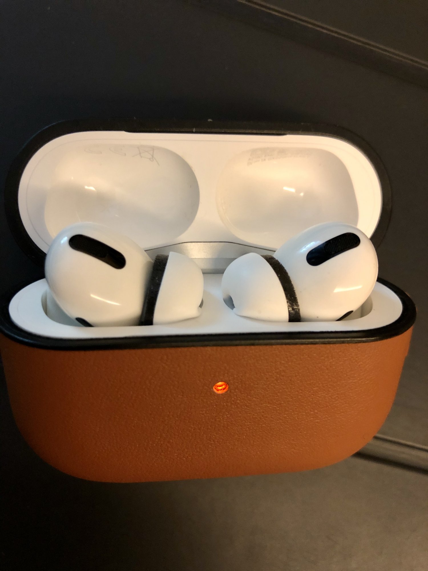

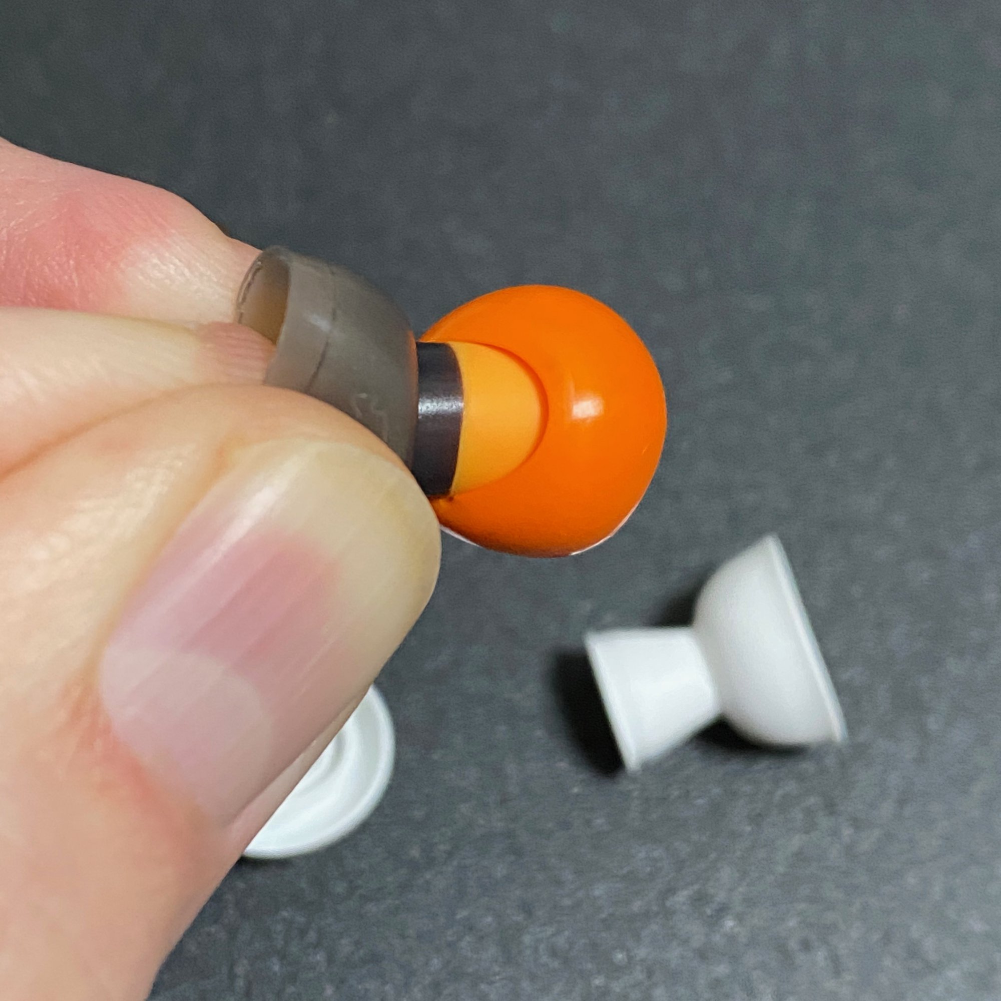

Just a PSA. I bought a set of Symbio W eartips for my Sony WF-1000XM3s last summer (hybrid tips - memory foam inside a standard silicone sleeve) and last night I discovered that the foam insert can be removed with relative ease AND fits inside the AirPods Pro tip perfectly.
This is what I bought: https://www.amazon.co.jp/gp/aw/d/B07T5TBTSW?psc=1&ref=ppx_pop_mob_b_asin_image

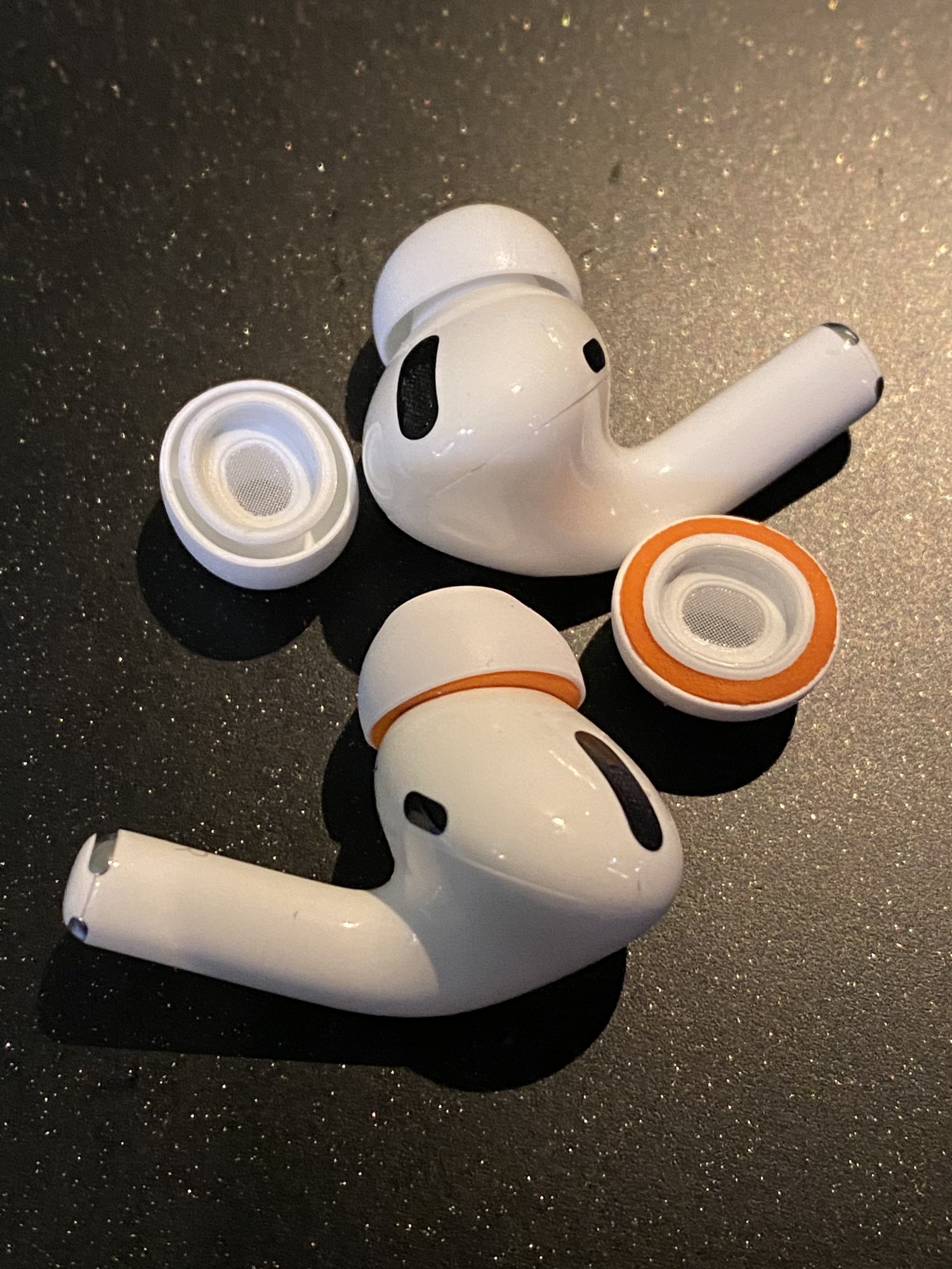

And this is is what it looks like, on the AirPods Pro. They fit inside the case exactly like the stock tips, too.

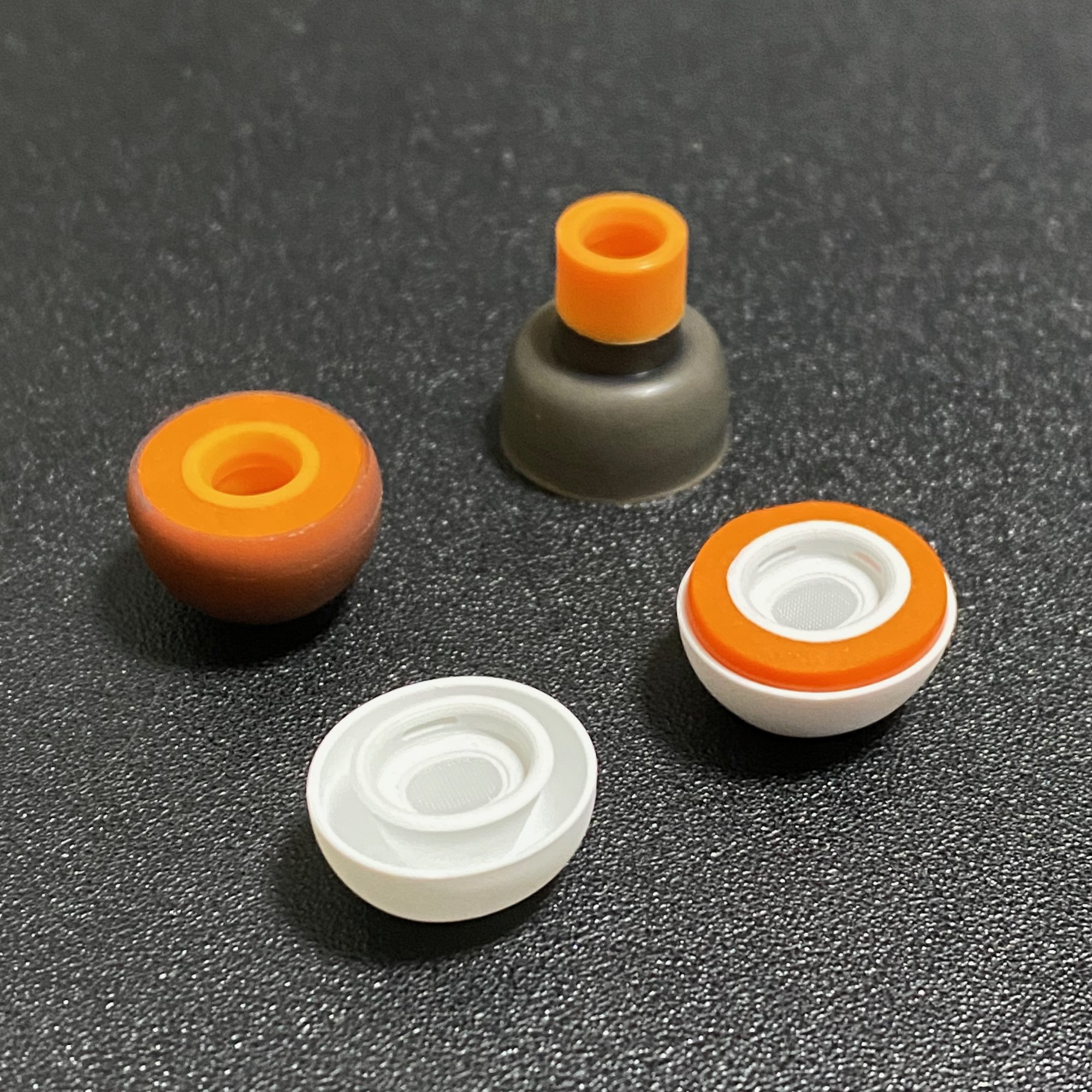

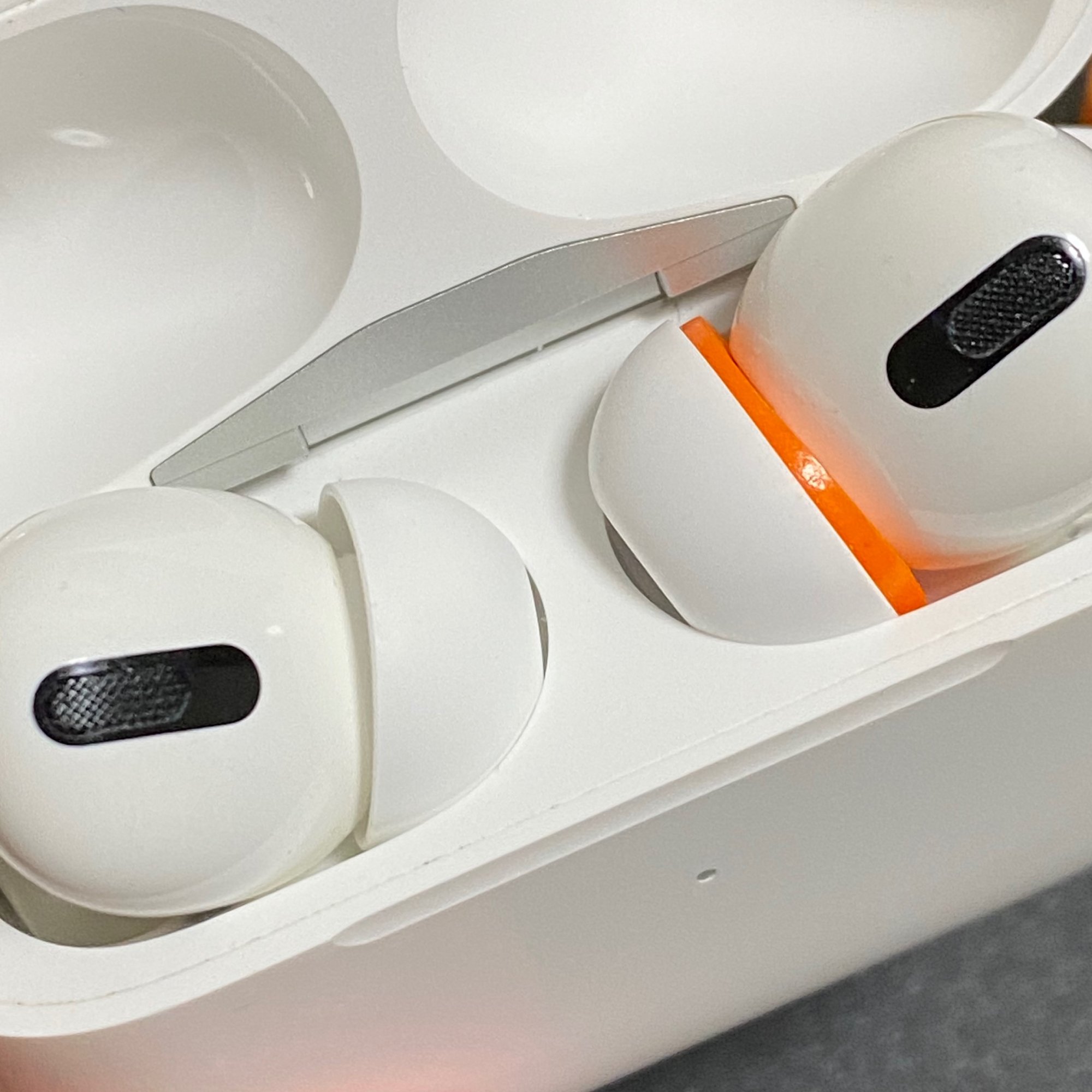

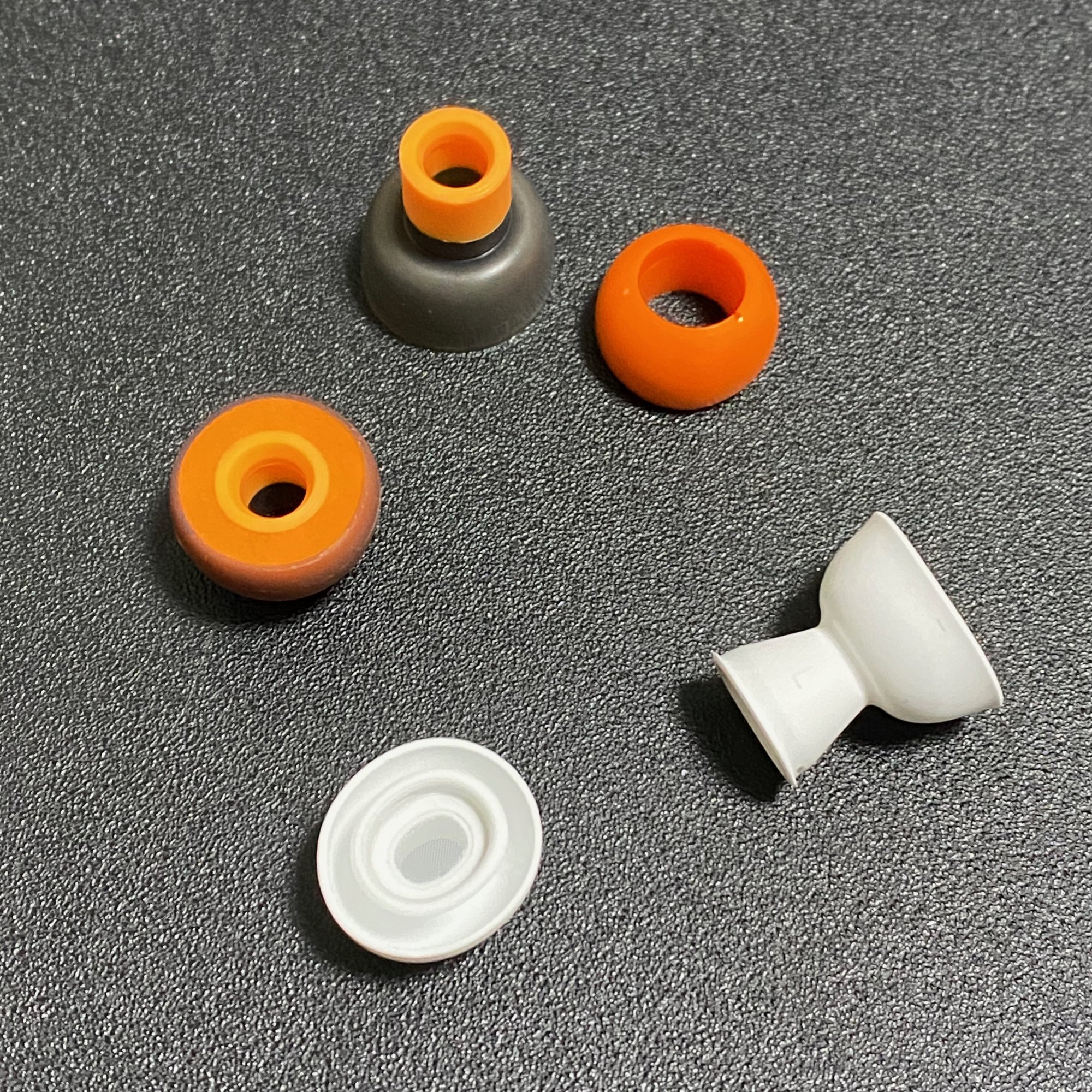

Sure. I originally did the medium tips (Symbio medium to AirPods Pro medium) but I just did the large as well, and took some pictures (click to enlarge). The whole process took about two minutes. The original/unmodified tips are on the left, in all the pictures (for comparison's sake).
1. Begin by inverting both tips. The Symbio memory foam seems to be sticky, but it actually isn't sticky - just tacky. So the tip inverts pretty easily, exposing the memory foam core.
2. Slide the memory foam off the shaft. (yeah, yeah - I'm sure there's a joke there)
3. As you can see, the memory foam insert comes off easily.

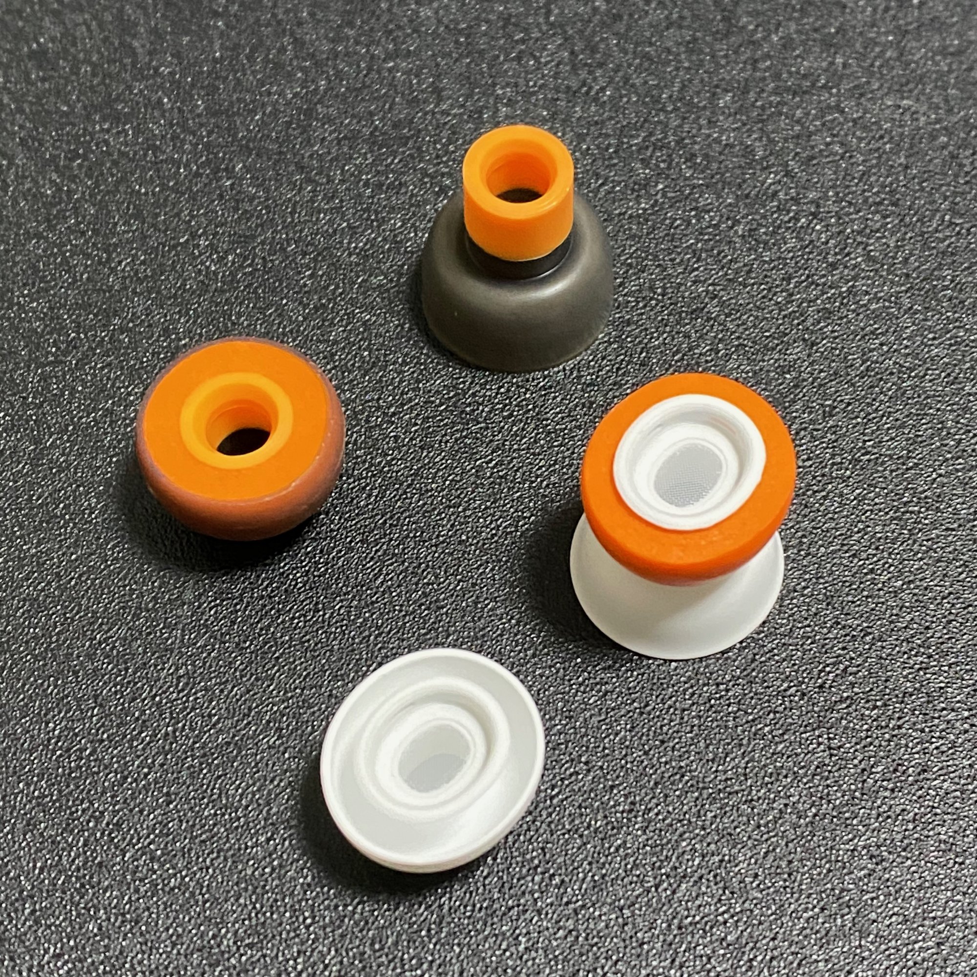

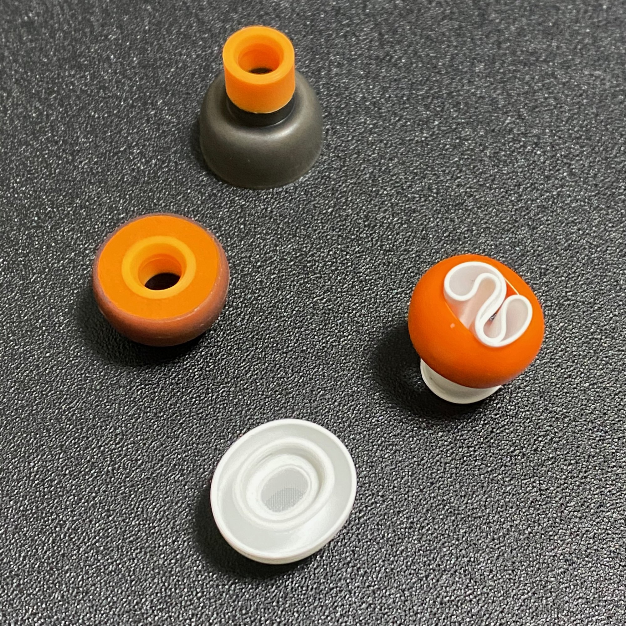

4. Pinch the AirPods Pro tip, and squish/twist it through the center of the memory foam.

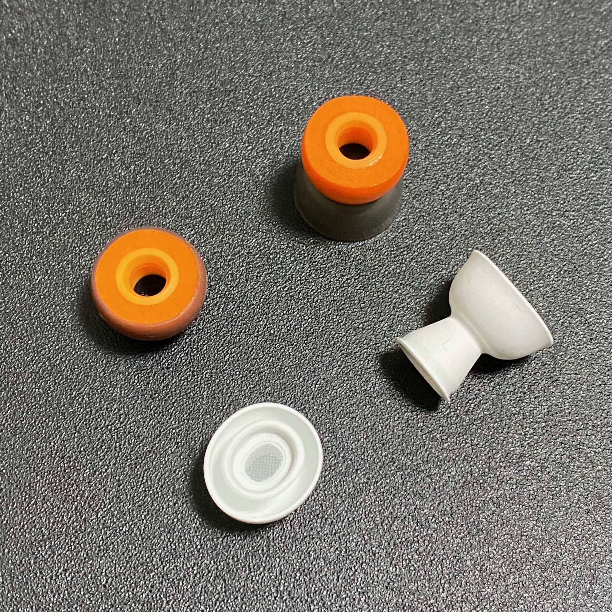

5. Pull the AirPods Pro tip through the memory foam's center, and position the memory foam on the shaft.
6. Re-invert the AirPods Pro tip and you're done.

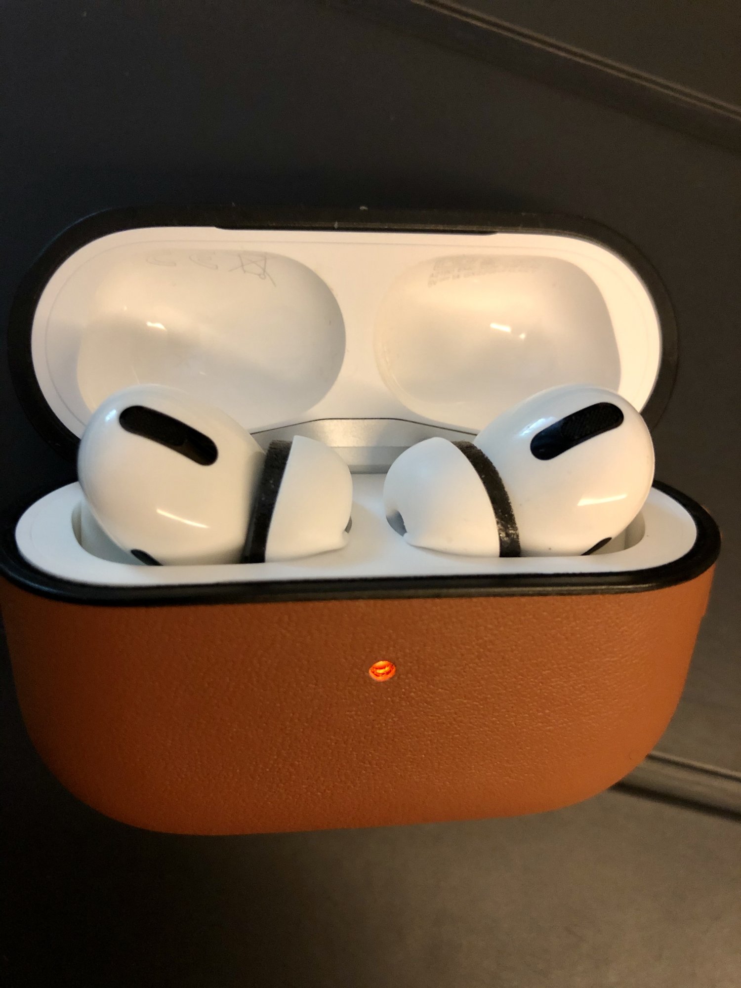

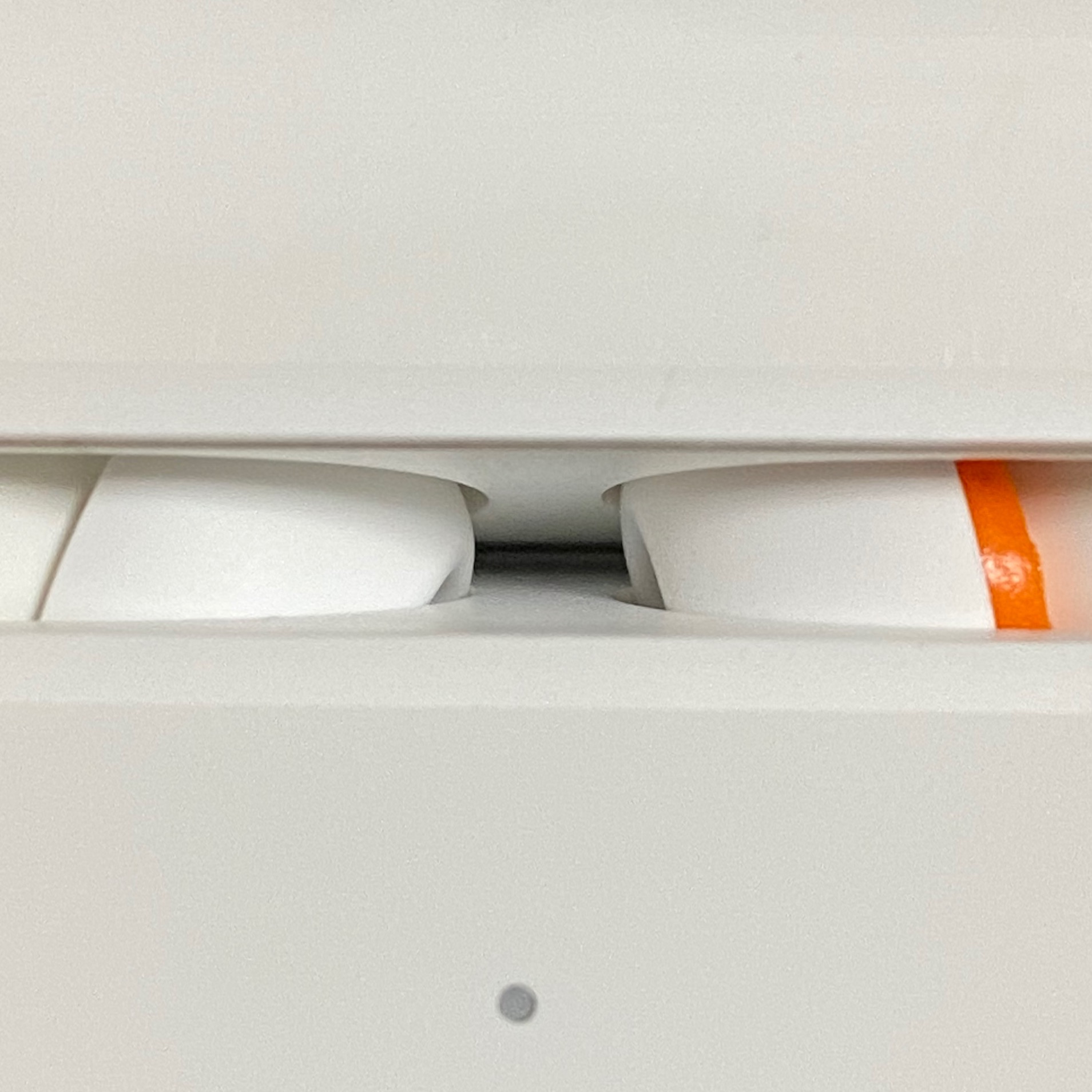

7.As you can see, the case closes perfectly.
The memory foam is quite pliable, so it fits the AirPods Pro tips' center shaft perfectly.
Hope that helps!

Both fit, the original from this thread with the Medium fits (you do have to compress them a bit), and the medium with the slide over the Apple tips method (just not as well as the original from this thread).

Yep my Symbio W large tips arrived today. I fitted them to my large Apple tips and I can confirm that they work with good NC, register a successful seal test and fit perfectly inside the case. I have a pair of mediums on order to try them

My Symbio mediums arrived today and fitted them to the medium silicon tips, fit great and a definite improvement in ear. Still holding out for some Comply tips as I'd like to ditch silicon completely as it tends to make my ears itch over time.
