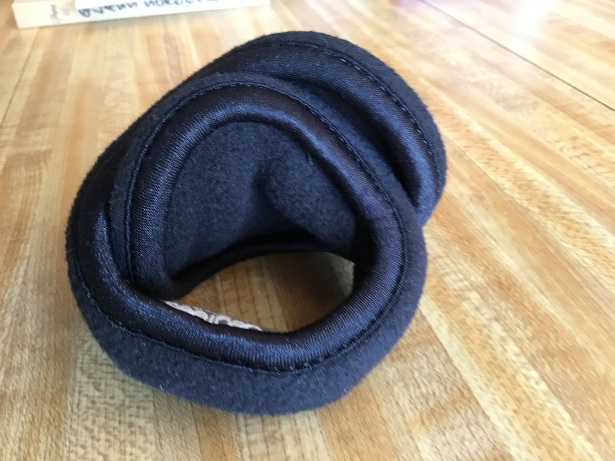

My pair of AirPods Pro has no problem in making calls in windy outdoor environment, the listener on the receiving end has no problem in hearing what I said. According to ACCU weather, the wind gust was about 27mph. But I have no way to measure the actual wind gust velocity. All I knew was the wind was so strong that I felt was strong pushing against my body while walking into it.
I just bought a pair of APP from Costco($200), model A2084, version 3E751. Together with an iPhone, it was used in the following experiments to ascertain the corruption of the caller’s voice when calls was made in windy outdoor situation.
Before the experiments, I made sure that the APP’s seal was perfect by performing the best fit test. I also have a pair of winter ear muffler, which I used to put over the ears to cover the APP, trying to block out the wind noise. I found that voice and Bluetooth signal could go through it without any problem. With and without the muffler was one of the test conditions. To make sure that the iphone was communicating with the APP thru Bluetooth, the iPhone was placed in my pocket or placed at a distance away from me while making the call was also one of the test conditions.
During each test in windy outdoor situation, I used my iPhone to call another number and left an voice mail until the voice mail was full and asked me if I would like to listen to the voice mail before it was sent, I then selected “yes”. This allowed me to listen to the voice mail and examine its quality. The voice mail represented what the listener of the other phone would have heard.
So using the APP and Iphone, I made calls in the wind and in outdoor, with either ANC on, off, or on transparent mode. In each case, I made calls with or without the winter mufflers, with the phone in my pocket or located at a distance, walking into the wind or the opposite direction.
I found that the recorded voice messages were clearly intelligible. With the muffler, the quality was better but not by much, likewise ANC on was a bit better than with ANC off. The transparent mode has the poorest quality but the voice was still intelligible.
I am not sure how the APP would perform when the wind gust is stronger than 27 mph.

I have refined my fan experiments by arranging two oscillating fans, such that sometimes the wind directions are aligned and at other times the wind directions are not aligned. This simulates the randomness of the wind. I then carried out The above steps under different conditions.
I found that:
  1. when the wind directions were aligned and when the wind was the strongest, the level of the voice was lowered that is the voice level was modulated by the strength of the wind. This is similar to what @Phwoar mentioned when the APP is near running water, the level of the voice is lowered. (or for some APPs ceased to work.)
  2. When I put on the winter mufflers, the modulation disappeared and the voice was clearer and steady;
  3. Comparing the voice quality between transparent mode vs ANC, ANC was better.
For me, the winter muffler does resolve the wind noise problem. If your APP does not work well when it is windy, try put on a winter muffler and see if the problem goes away.
The winter muffler that I used is given in the next post.
The winter muffler that I used in my wind noise experiments is attached. It covers both ears and the APP, but it does not form a tight seal with the ears. It seems to have two layers of fleece. It blocks (or part of) the wind, but importantly allows voice and Bluetooth to go through; any mufflers that has these three properties would work.
This pair of ear mufflers that are in two separate pieces and made of faux fur may be easier to carry and more effective than mine:www.walmart.com/ip/Bandless-Ear-Warmers-Earmuffs-Winter-Faux-Fur-Ear-Muffs-Covers-with-Fleece-Lining-for-Men-Women-Child-3-Sizes/535179325?selected=true
However, a thin pair of ear covers may be sufficient to block out the wind noise.
