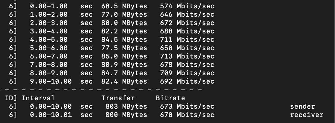

I get between 600 and 800 MBits/sec with the UA6 Lite.
What speed are you getting with UA?

You can do an iPerf test between two clients. It's fairly easy to set up. The test in my previous post was made with iPerf.
That being said, I highly doubt you will get more than 800-900 Mbits/sec with the UA6 Lite.
