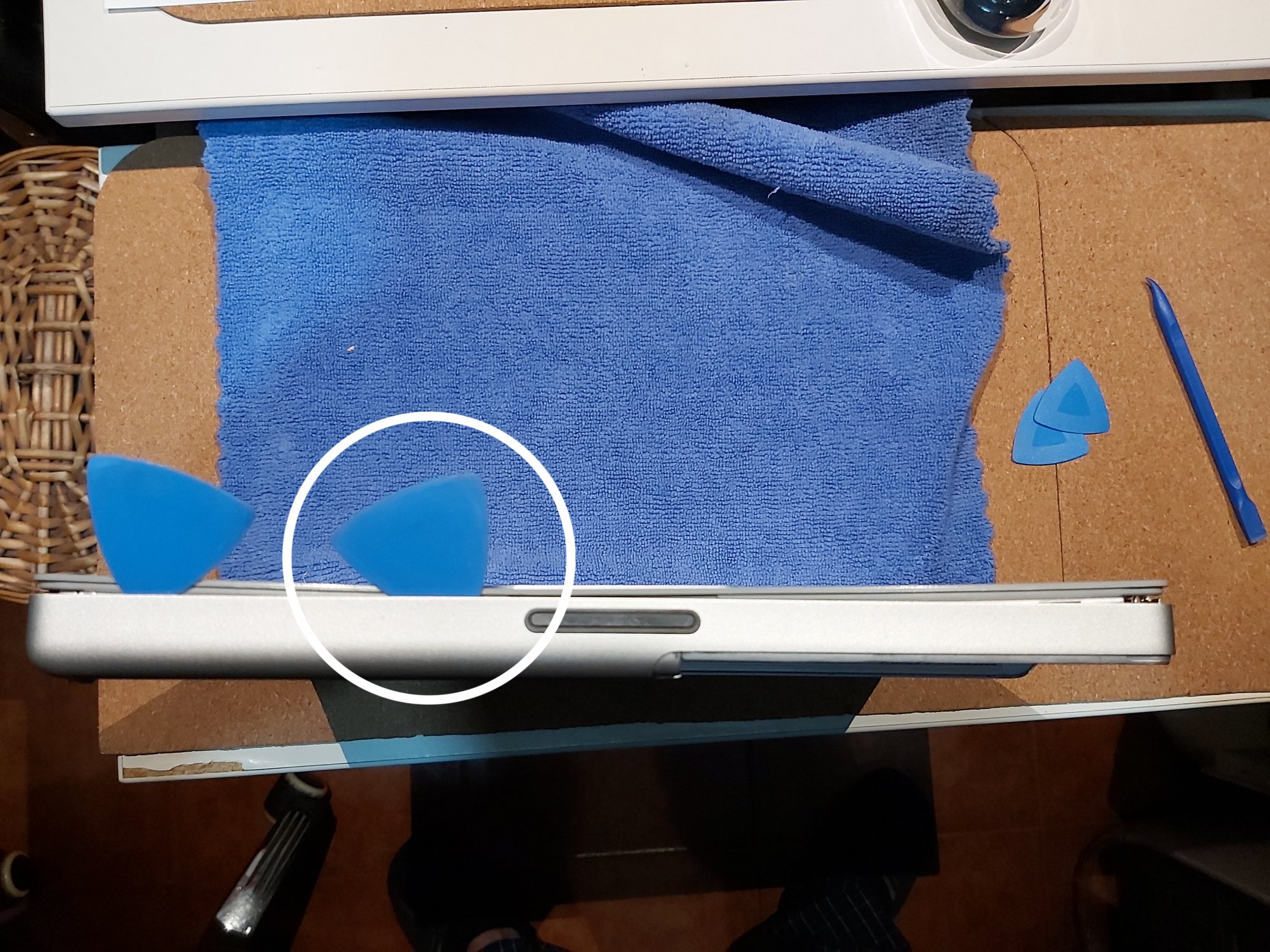

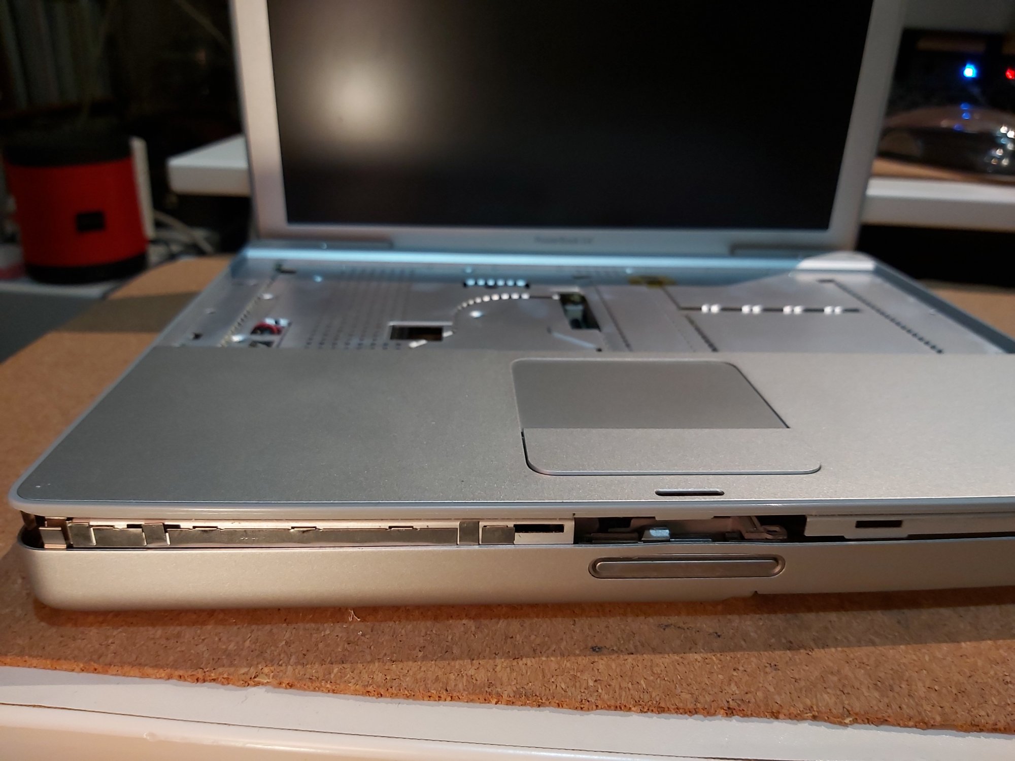

Got a nice 12inch Powerbook with a dead harddrive but can't manage to get the topcase off.
I'm missing only one spot on the front.
I know the plastic clips pushing into the holes from the frame but it seems to be glued...maybe aluminium parts bounding together from a drop of water or moisture?
You can cleary see the sides come loose.
I think it has to come straight up so i also tried to hold the whole topcase by its sides and rock it a little bit and even pull but this spot is really stubborn.
Any ideas?
Maybe get a air ballon and try to apply pressure from under?

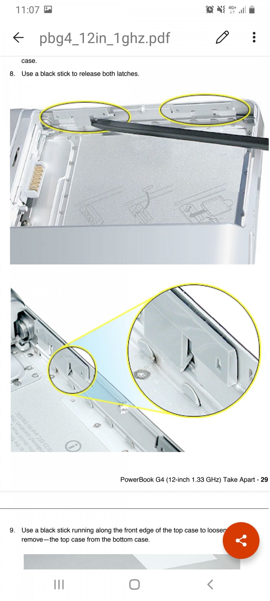

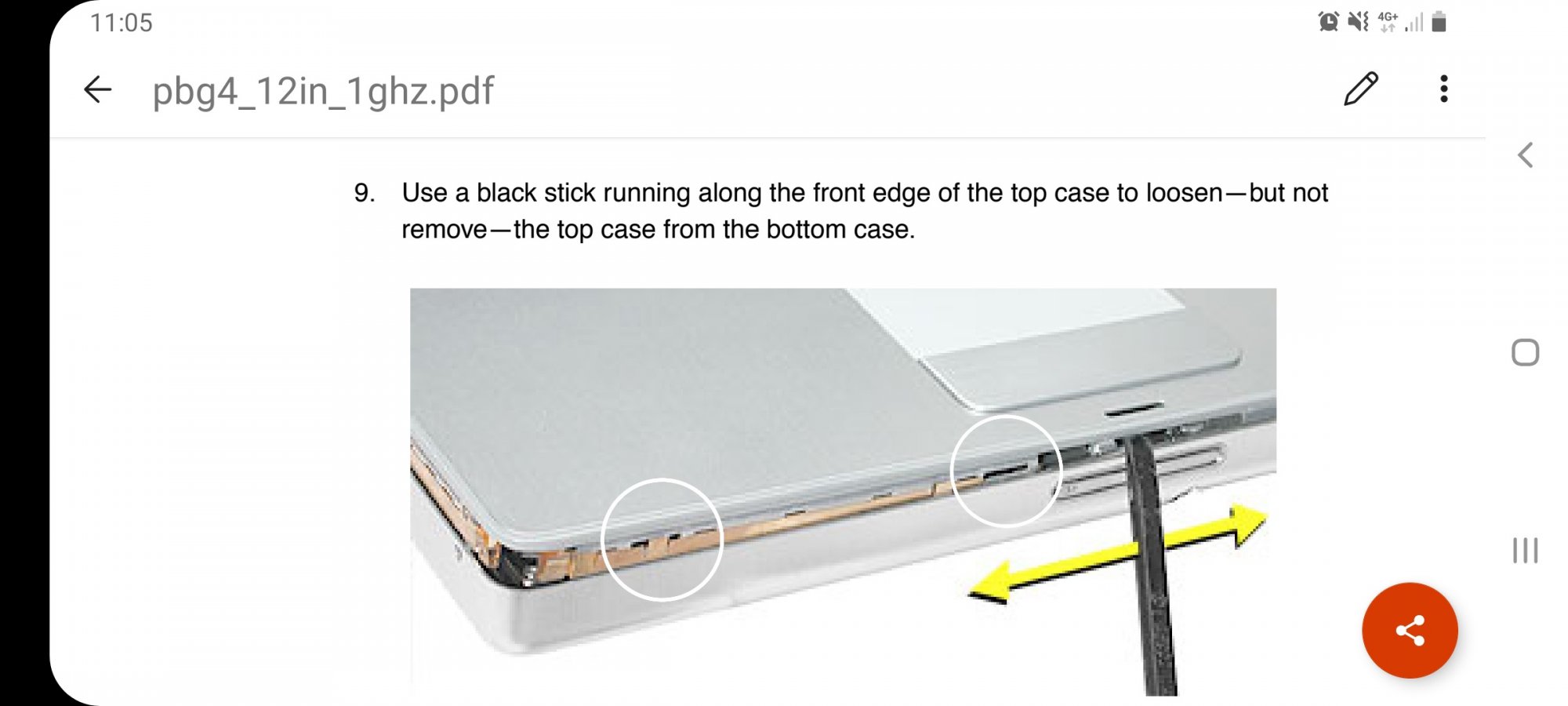

Looking at the service manual:
This is what it looks like on the left front side.
You can glimpse the two openings where you supposed to push the plastic stick into to free the plastic tabs.
Here you can see the plastic tabs from the right side from the battery compartment.
Can someone confirm there are the same plastic tabs on the left side?

Yes, those same plastic clips are also on the left. Sometimes it can help to lift the front edge first. Raising the rear edge (near the hinge) slightly increases the angle on the clips and makes them "bite" harder. If you have already raised the rear edge, try pressing it back into place and then try the front edge.

Yes, i thought of the same and began the process with the "problem" front left side first the second time i tried but still no dice...

Could the airport card be snagging something? If you haven't, why not take it out and see if that helps things release in that area? The tops are definitely fiddly and can take alot of patience to get on and off.
