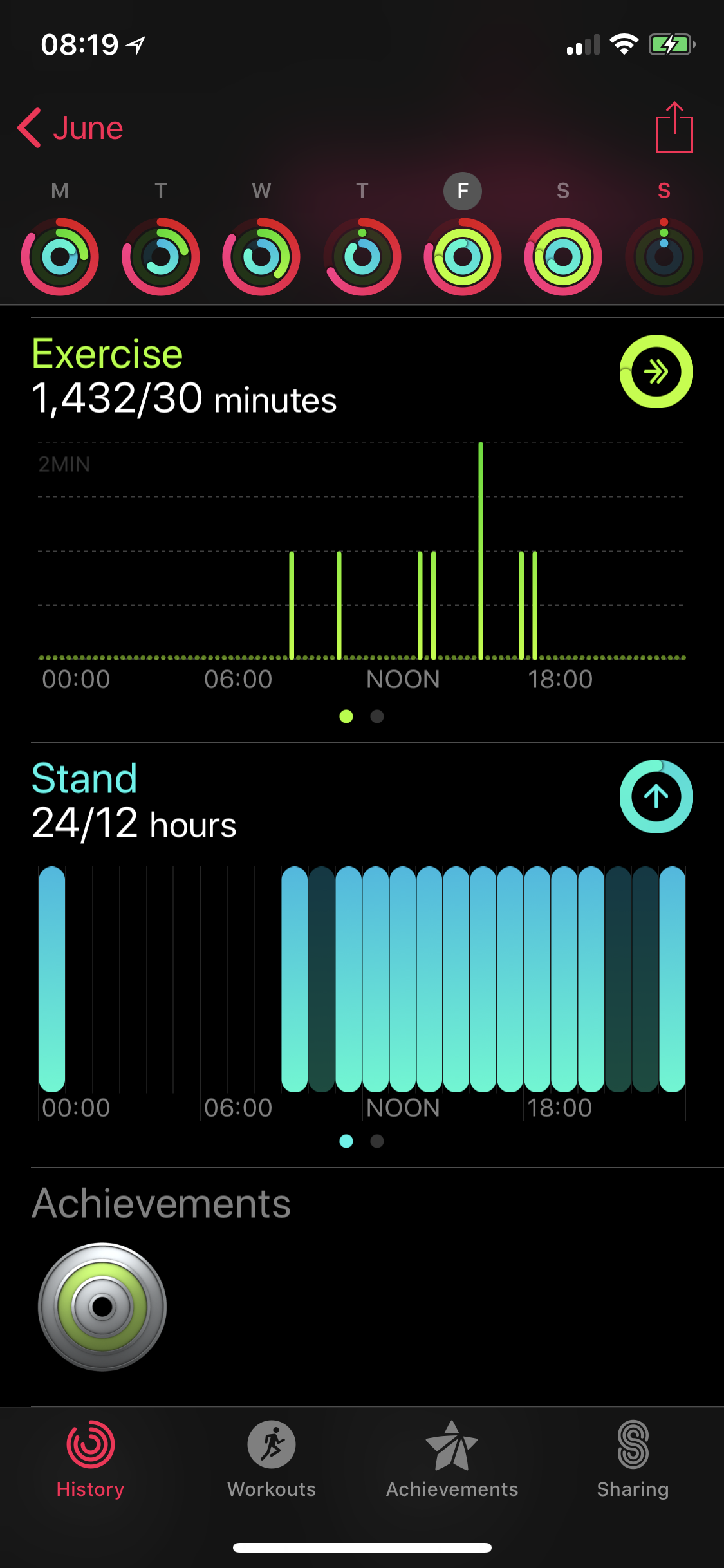

I noticed an issue yesterday where a 3rd party app had added a workout in error, starting 11th May, ending 2nd June.
This throw out my rings for just the past 2 days, Sat & Fri.
I’ve managed to find the data points in the Health App to remove them however the figure shown doesn’t match. See attached.
I want to align the figures to match that of the data. The Rings show I have “Exercised” 23.84 hours and “Stood” 24. That’s clearly not the case and having removing the data the graphs appear correct, just the figures haven’t updated.
Wouldn’t be a massive issue but I enjoy collecting achievements. Having those figures as my “high score” would knock some out.
Does anyone know how I can fix this? Even if I can delete both those days fully, I’d prefer that?
Just to stress, I have been through the data and sources so graphs are correct and showing those figures, just the figure displayed that needs updating.

I was able to remove the Workout that caused the issue. This removed all the data and updated the graphs accordingly however did not update the figures, strange!
