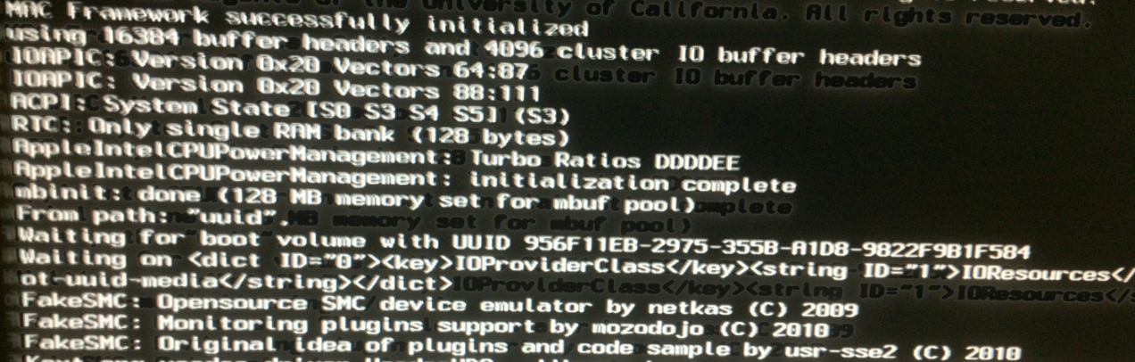

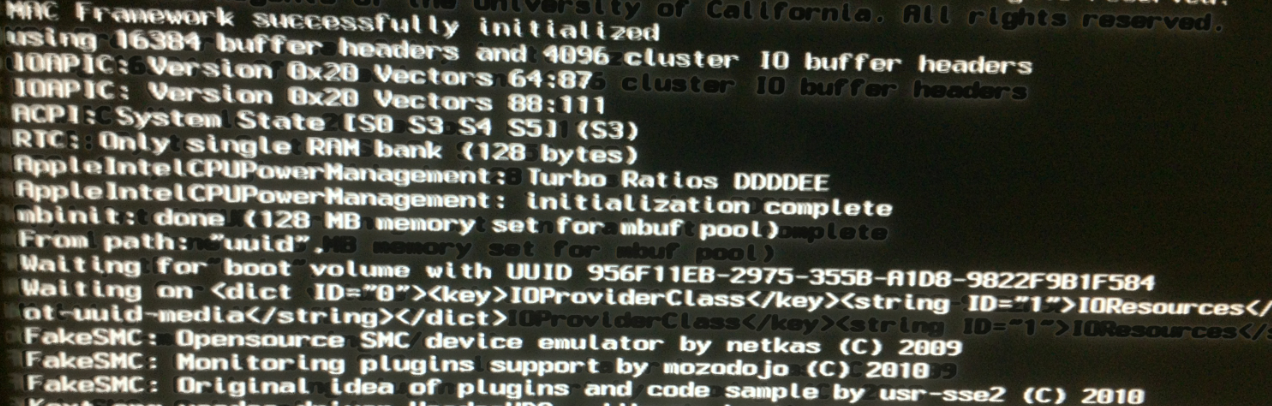

I did what you said and this time I tried to take as many pics and examine each and every individual line and there is one pic that shows this:
Read HFS+ File: [hd(0,2)/System/Library/Extensions/AppleIntelCPUPowerManagement.kext/Contents/Info.plist] 2324 bytes
I see that similar line repeating a couple of frames later. I also see in later pics the same with similar information for the fakeSMC.kext file, but nothing else. Is that what I'm supposed to see? Also, I don't see any info on Turbo Ratios at all on any of the pics that I took.
Lastly, my system keeps doing the CMOS error thing. So I just pressed F2 to let it start at default when I booted to -v and then took those pics. F2 (I think) just put everything in default mode taking every setting off, like ACHI right back to IDE mode. But if that's the case then wouldn't it have not booted into Mac OS X? I thought it needed to be in ACHI to have Mac OS X work? Let me know what you can. Again, thank you... 🙂
... . one pic that shows this:
If you don't see any info on Turbo Ratios at all on any of the pics that you took, it's most likely that it isn't working yet. What version of Chameleon, FakeSMC and OSX are you running? I'm using Chameleon 2 RC5 R699; my FakeSMC.kext file was created on July 22, 2011; and I'm running SL 10.6.7; if you're running Lion, be sure that you follow d00d's post#1 about setting up smbios.plist and org.chameleon.Boot.plist. Also, I recommend that you, as did d00d, use Chameleon r1331 boot loader if you want to run Lion.
