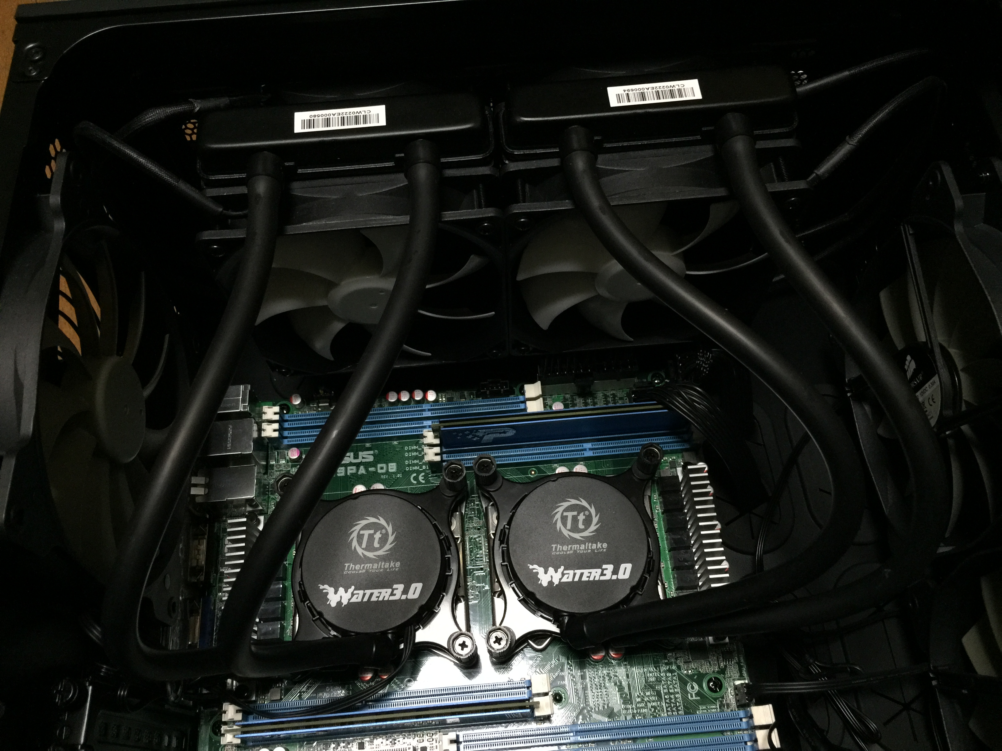

I put a inside pic of my dual Xeon system.
Specs and conditions from mail I sent to PunkNugget are pasted above.
Now I need a help to solve the GPU problem of this motherboard.
Because I still have the problem of this build, I can't provide precise recommendation of dual Xeon system.
I think using Z9PE-D8 WS is popular method for dual LGA2011 system.
Some people at tony's thread said they should use PCIe slot connected to 2nd CPU instead of a slot connected to 1st CPU to work GPU properly.
Sadly, all of slots on my mobo are connected to 1st CPU. I guess this is the cause of the GPU problem.
I don't know this PCIe problem affects to other non-ASUS or LGA2011-3 mobo or not.
But I suggest to use mobo that has PCIe slots connected to both 1st/2nd CPUs.
These connection configurations can be checked by block diagrams on the pdf manual.
I'm looking forward to discussing about monster Hackintosh at here!

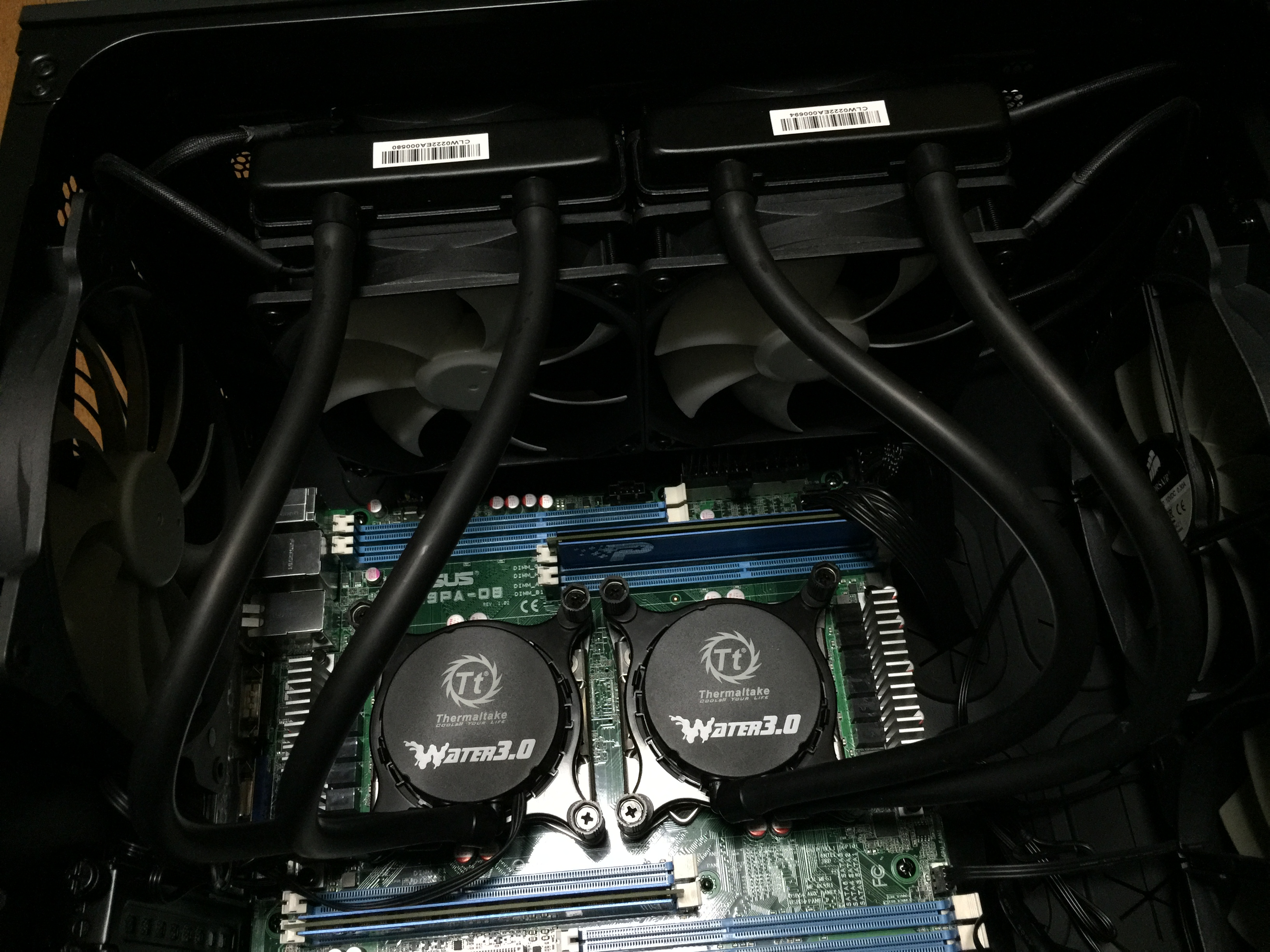

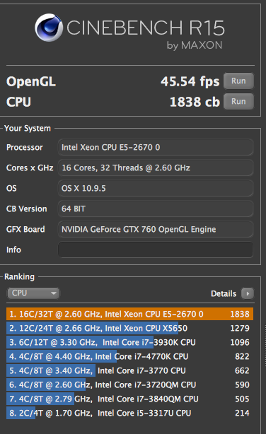

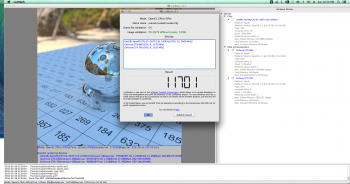

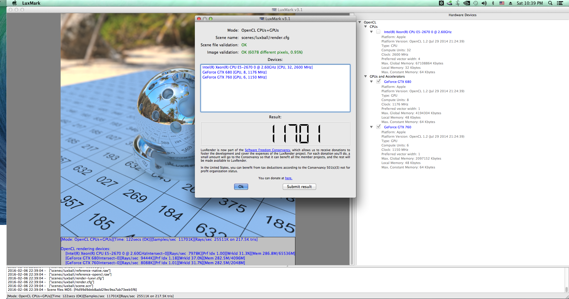

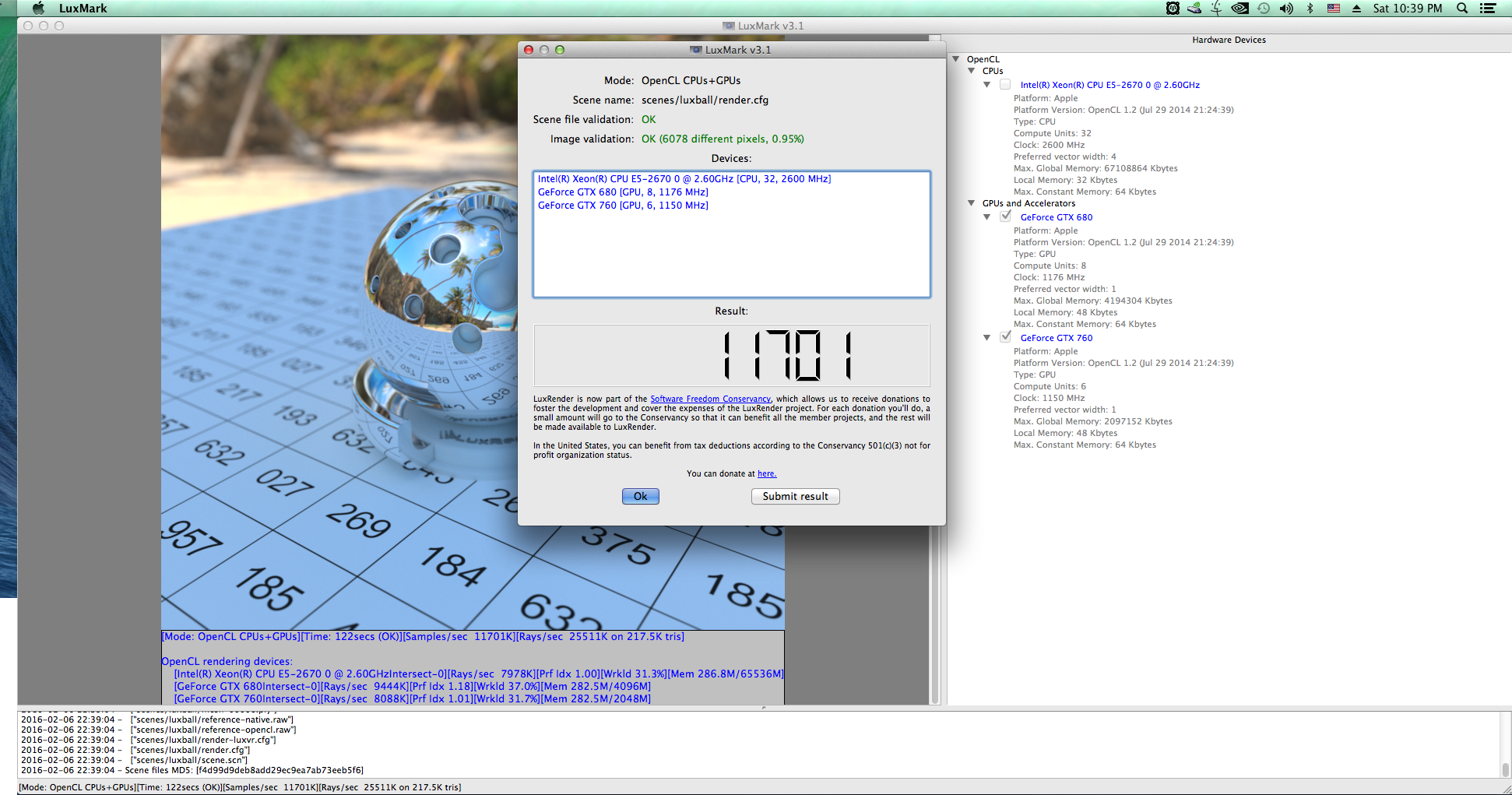

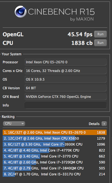

Hi ccr4700,
I've got Z9PA-D8C board like you, and 2 E5-2670 v1 Sandy, 1 EVGA GTX680 4G, 1 GA 760 2G. I made it up and run just fine with Mavericks 10.9.5. But I can't get Yosemite or El Capitan on it, always stuck at PCI configuration begin. Is there any luck with your board? I need Yosemite or El Capitan to work with FCPX.
Here some result from my system.
Main: Z9PA-D8C
CPU: 2 x E5-2670 (v1)
RAM: 8 x 8G bus 1333
VGA: 1 x GTX 680 4G, 1 x GTX 760 2G
SSD: Samsung 850 evo
OSx: 10.9.5
** CPU Power management:
Feb 6 21:05:29 localhost kernel[0]: AICPUPMI: CPU P-States [ 26 ]
Feb 6 21:05:29 localhost kernel[0]: AICPUPMI: CPU P-States [ 12 26 ]
Feb 6 21:05:31 dungpc1 kernel[0]: AICPUPMI: CPU P-States [ 12 26 30 ]
Feb 6 21:05:33 dungpc1 kernel[0]: AICPUPMI: CPU P-States [ 12 26 30 32 ]
Feb 6 21:07:54 dungpc1 kernel[0]: AICPUPMI: CPU P-States [ 12 26 30 32 33 ]
Feb 6 21:12:06 dungpc1 kernel[0]: AICPUPMI: CPU P-States [ 12 26 30 31 32 33 ]
** Geekbench: http://browser.primatelabs.com/geekbench3/5170280
** VGA:
Screen Shot 2016-02-06 at 10.39.23 PM.png Screen Shot 2016-02-06 at 9.55.08 PM.png

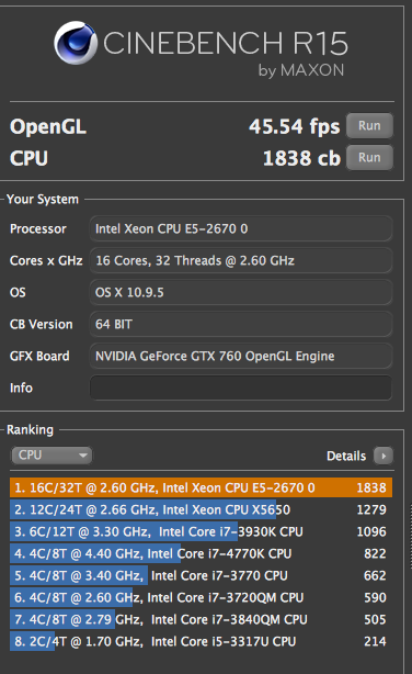

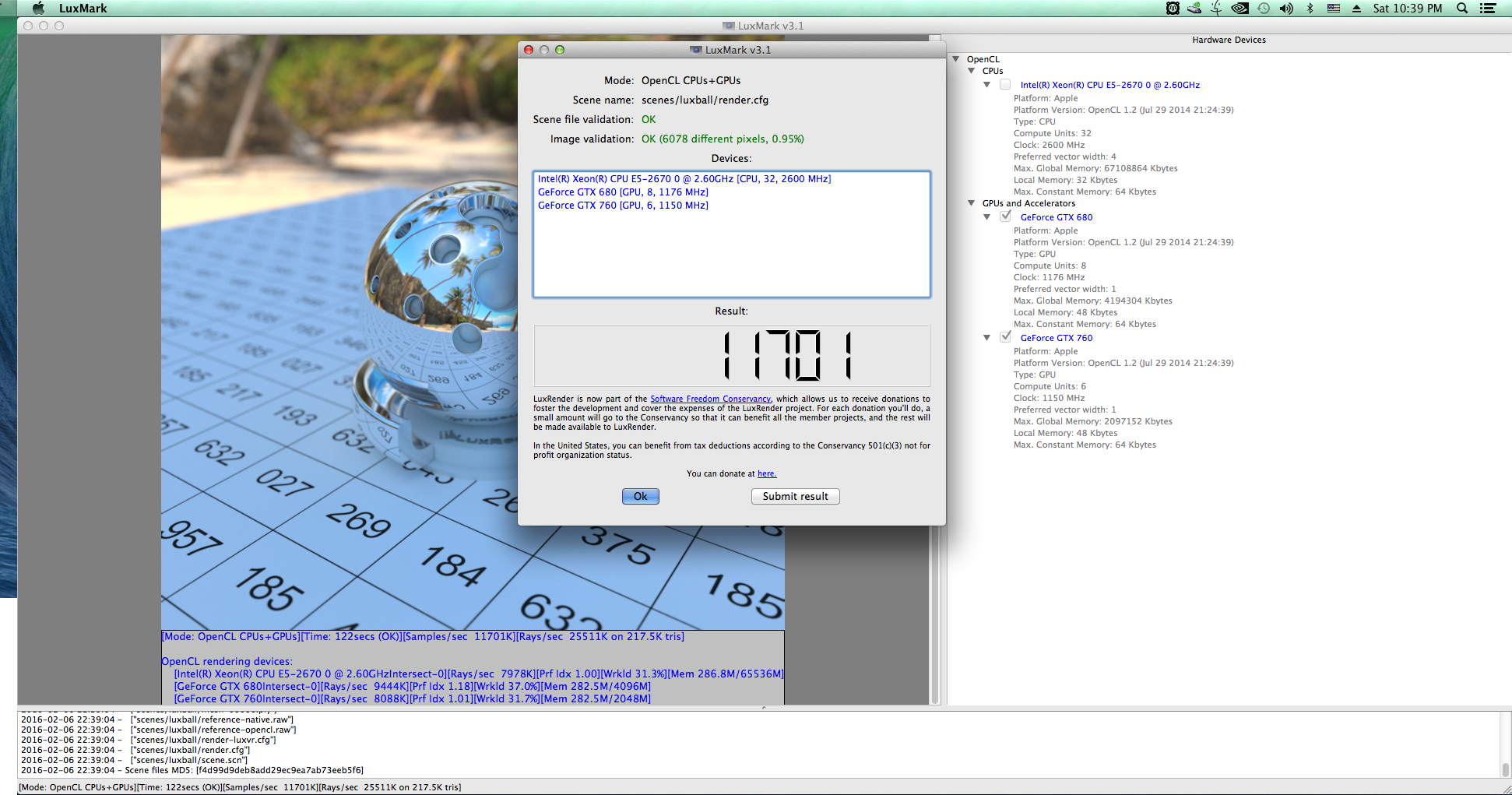

Hi ccr4700,
Main: Z9PA-D8C
OSx: 10.9.5
** VGA:
View attachment 614538 View attachment 614537

Sadly I couldn't resolve the issue of Z9PA-D8...
I gave up using Z9PA-D8, and I bought Z9PE-D8 WS. I struggled with this mobo, but finally I made El Capitan working.
I have no solution to work GPU connected to CPU1, so I had to use Z9PE-D8 WS (It has slot5-7 connected to CPU2).
