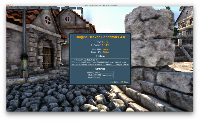

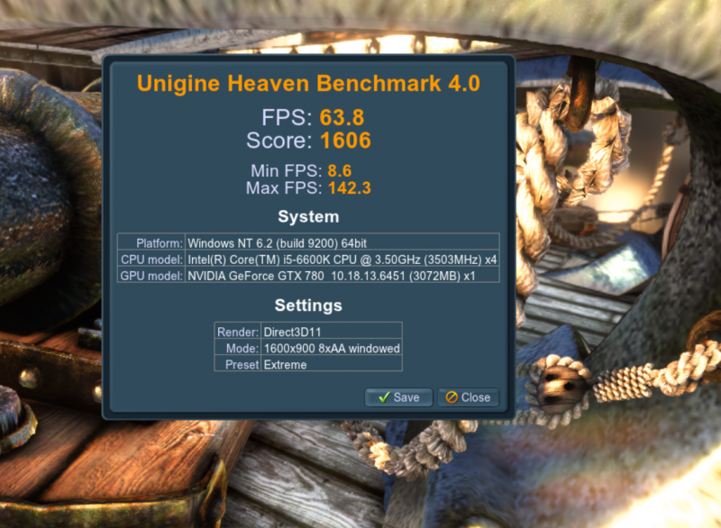

Those difference are mostly due to high CPU overhead in OS X, which is most obvious on systems with bad single core performance.
A CPU bound system (e.g. MP4,1 with 2.26 GHz CPUs or MP3,1) will usually perform much worse in OS X, I've seen differences way beyond 30%.
On the other hand a system with a fast CPU will almost close the gap:

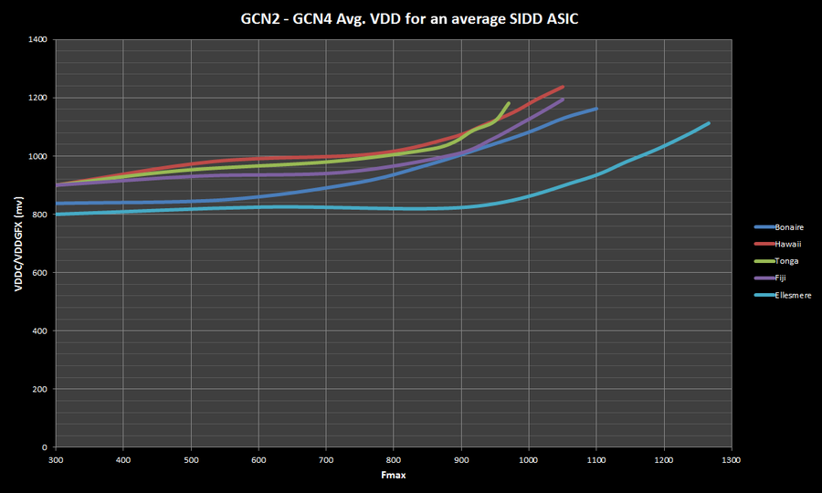

1120 MHz is the sweet spot, of power consumption and performance, and it is rather coincidentally the base clock for RX480.
I wonder what power consumption would get Fiji on this process, with 1050 MHz. As always, everything relies on the design of silicon, but it looks like the 14 nm process form GloFo is not that bad as people thought it is. It is again pushed out of its comfort zone(the architecture). AMD may just have underestimated the capabilities of Nvidia's silicon design, thats why they had to push the GPU out of its comfort zone at the last minute.
