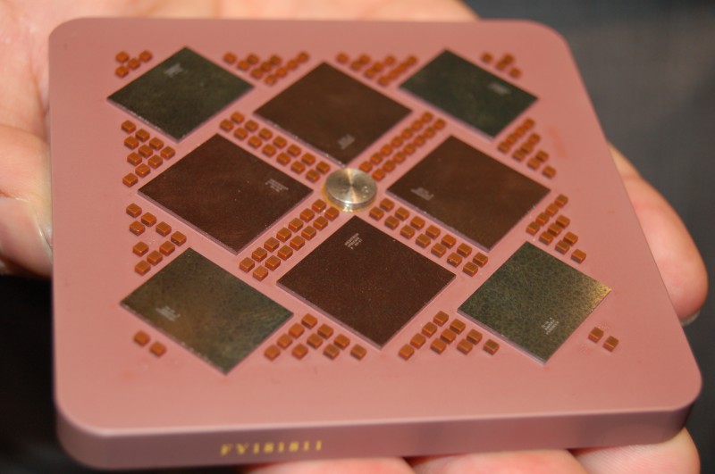

For server APUs they can use a bigger MCM (multi chip module) package like IBM does for Power. For example, a Power 5 MCM with 4 Power5 dies and 4 L3 caches.
https://en.wikipedia.org/wiki/POWER5
The overall module is the "APU". So could put a full sized 32 core die and a med-large GPU HBM module into the same supersize (relative to normal desktop socket) module. If have a multiple die solution then need a low latency, high bandwidth solution to handle traffic between the dies. But also don't necessarily need the same substrate interposer to span both the GPU+HBM and the CPU die
