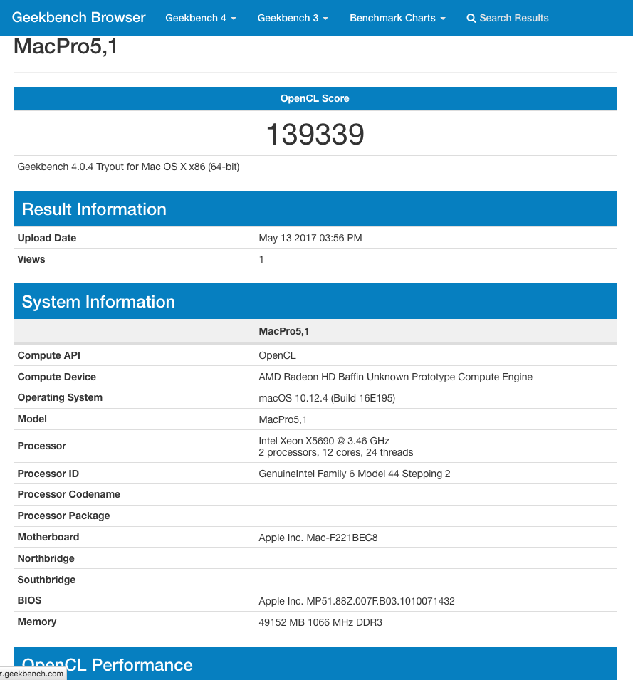

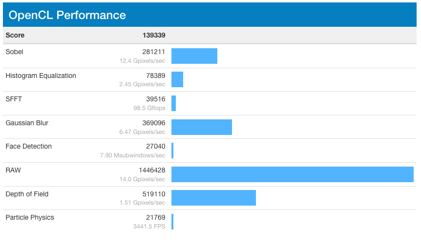

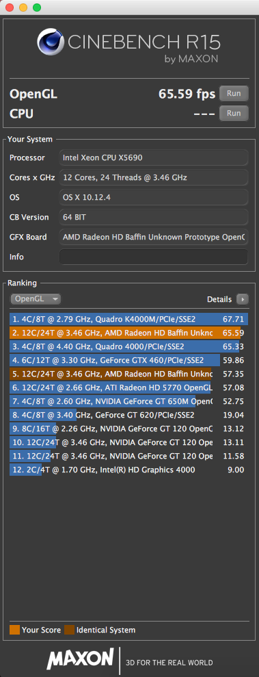

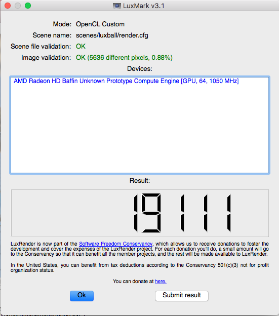

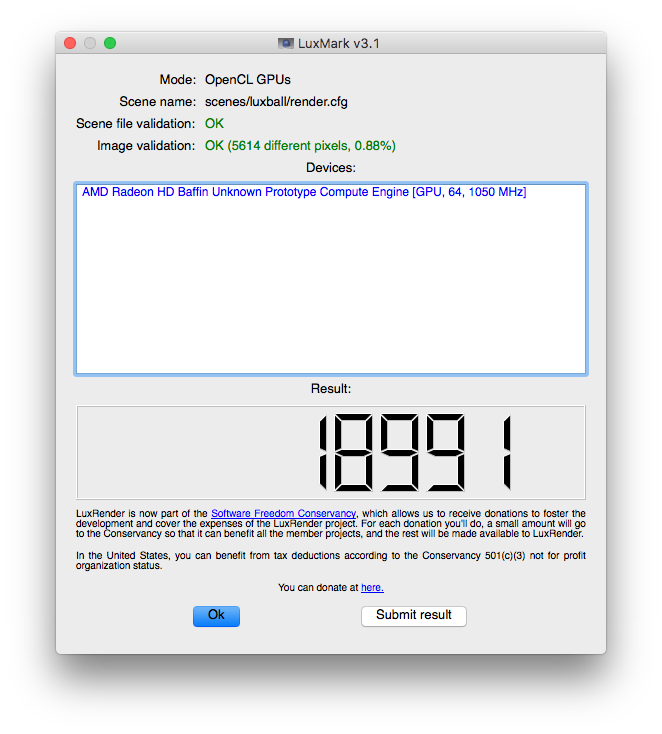

Changing drivers did indeed improve performance. Wow. Not subtle.
LuxMark scores almost doubled, as did Geekbench 4 OpenCL results. Very nice.
I can also report that at least in an original Mac Pro, sleep and wake work fine, as expected. One of the other forums mentions that this feature is broken, but I think it might only apply to Hackintoshes.
This card flies, and is so much faster than the stock card that came with the computer. A welcome upgrade, well worth the price. These cards go for just over $200 currently (the non-X versions).

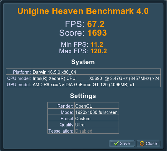

Screen Shot 2017-05-13 at 18.02.01.png Screen Shot 2017-05-13 at 17.56.46.png Screen Shot 2017-05-13 at 17.56.34.png Screen Shot 2017-05-13 at 17.54.53.png Screen Shot 2017-05-13 at 17.53.22.png

View attachment 699598 View attachment 699599 View attachment 699600 View attachment 699601 View attachment 699602
