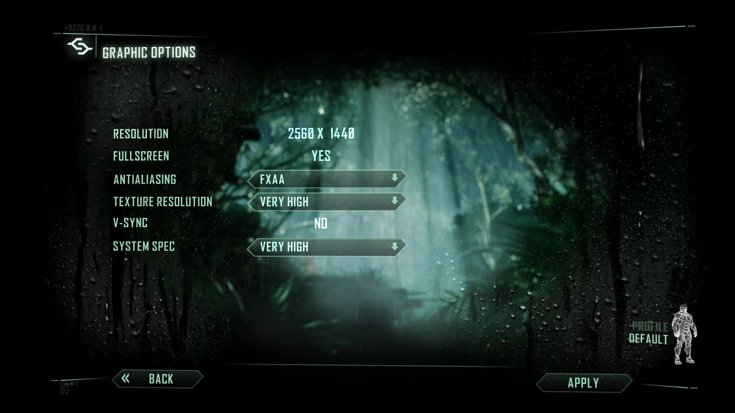

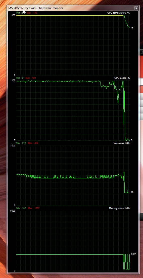

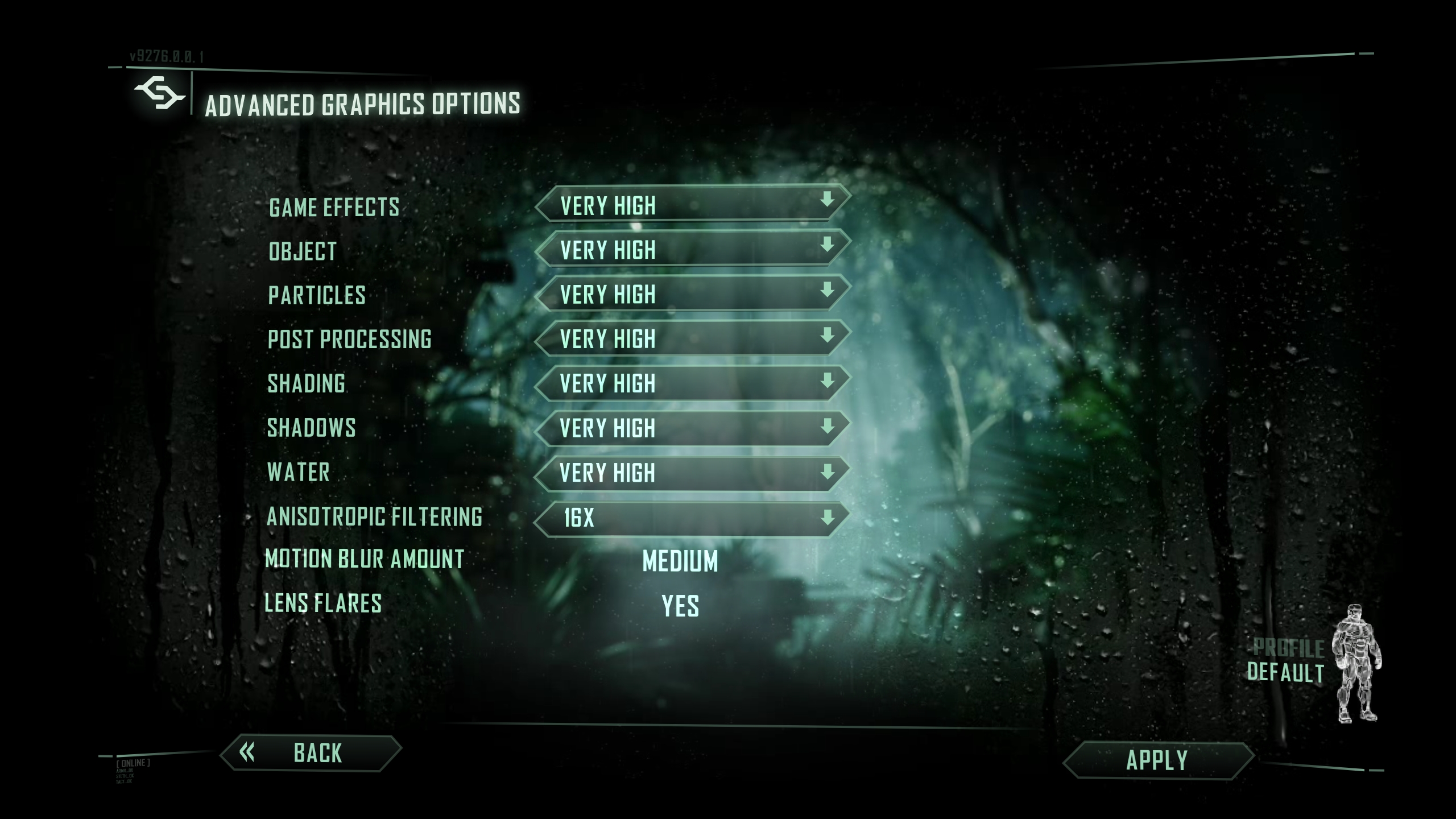

I "tried" Crysis 3 just now as I felt that maybe I needed to throw a more demanding title. Played for about 30 mins now... avg 23 frames but settings on very high. Room ambient temp at 23c
According to MSI Afterburner;
GPU temp at this time was 105c and GPU usage at 100%. Fan speed at 100% CPU temp was avg 84c.
According to Fraps, avf fps was 23... min 18, max 27.
Crysis I believe is a demanding game from 2013 even for desktop cards. So its laudable that the i7/295X iMac is able to handle it at very high. I'm sure it'll be playable at high settings
Thanks for the results. More confirmation of throttling as we can see from your GPU core clock. :(

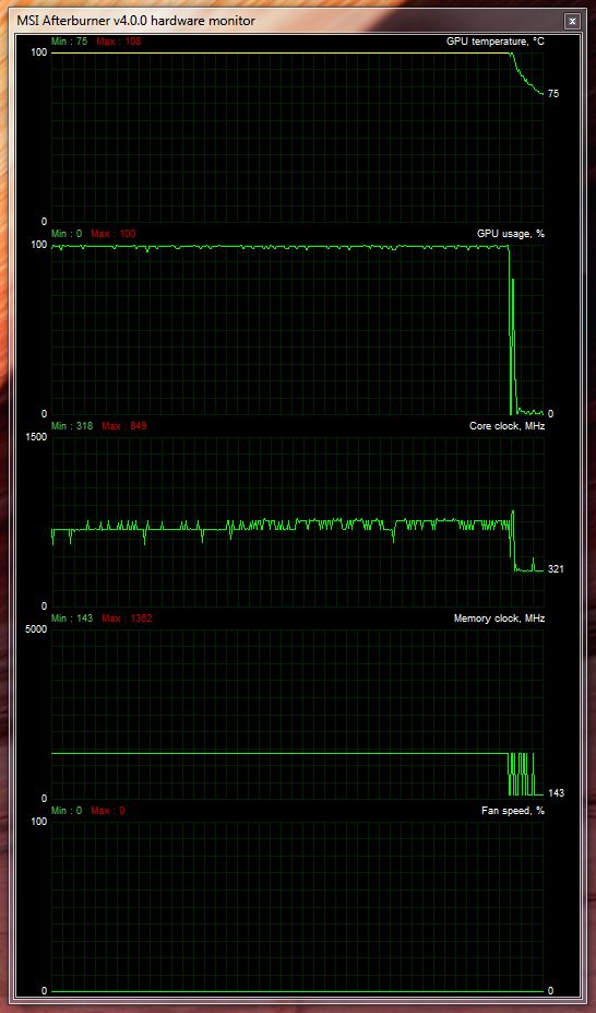

A couple of caveats;
1) this is an iMac :) not a gaming rig
2) this is Crysis 3 :p and has pretty high spec requirements
3) played again with all settings on High and with 4xSSA instead of the previous Very High and FSAA
a) looks gorgeous - sorry... thought I took screenshots... guess I didn't
b) no lag at all....
c) Fraps reports avg fps at 39...
4) whats the delta of the freq throttling? I estimate between 100-150 Hz max?
so here's what I'm thinking...
I am more interested in how well a demanding game actually plays rather than how much it is throttling on tests. Now if the game was skipping, I'd be disappointed as well. But that isn't the case with Crysis or with all the other games I've tried.

Yup, crisis 3 doesn't play that badly, but if you look under those graphs from MSI, you can see the core clock is throttling pretty heavily. I've never seen a core do that before. It's almost always completely the same MHz speed all across, just like the memory clock is.
Right now, the most important thing is trying to find someway to measure core clock fluctuations in OS X. For the life of me, I can't seem to find any piece of software that will allow us to measure even in a log file Temperature, GPU Usage, and Core Clock over time.
If the core is throttling itself in OS X, just like in windows, the issue is not so much that this is ruining gameplay or interrupting it to a point where things are unplayable, performances is just nowhere near what it should be because heat appears to be a huge issue in this form factor. There is no question that on paper the 295X is an amazing card, but it should be blowing the 680 MX out of the water in every test and it is not. Over time, as various issues contribute to reduced cooling efficiency, if this means that the GPU throttles itself even more, even faster, just to stay cool than this is bad news for me.
