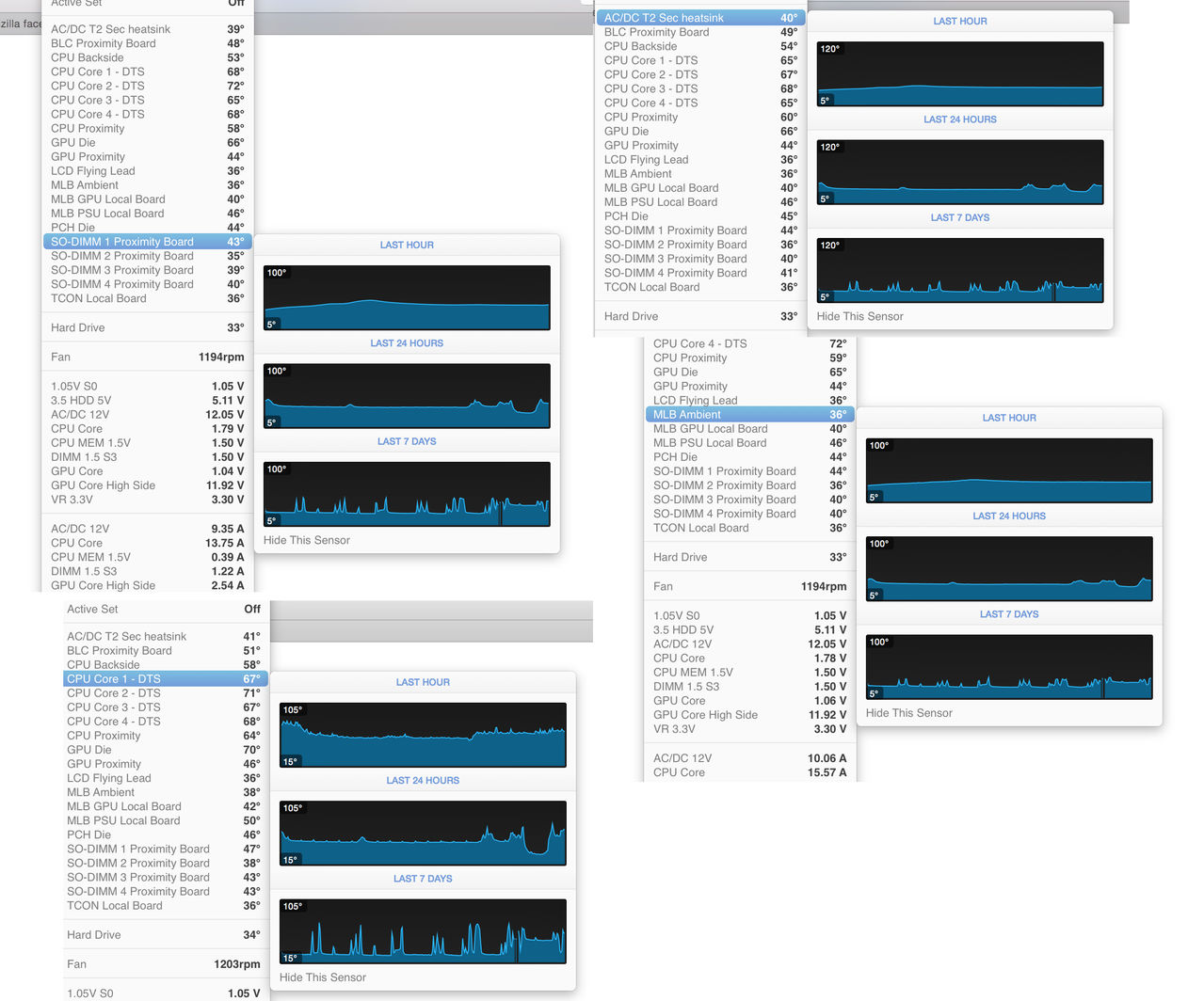

Guys, even the CPU core is at 105° at the top of the graph so you're telling me that even my CPU reached 105° ?
How about the RAM ? I have 100°
And yes ! AMBIENT ! I had 100° C in my studio ! I was so lucky beign outside when it happened !
I just re-installed iStat Menus on this iMac and all the graphs have dynamic value axis, based on the peak temperature reported by each sensor.
I'm not doing anything, so they all varied between about 25° and 50°, but they were all relevant and changed as the hardware jumped up 1°. So yes, any temperature you see at the top of your graphs = the maximum temperature reported by the relevant sensor.
We are having an honest discussion, and this is how iStat Menus works. Same as most peak/trough monitoring tools.
Yes, this is exactly how iStat works.
Maybe theres a default scale that can be dynamically increased if the value reach the end of the scale... :rolleyes:
Explain me the ram, all the other sensor and most important part... the ambient temp !
