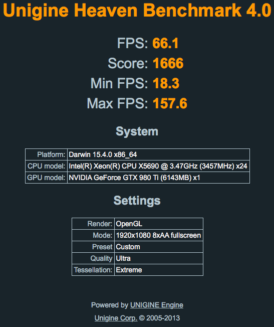

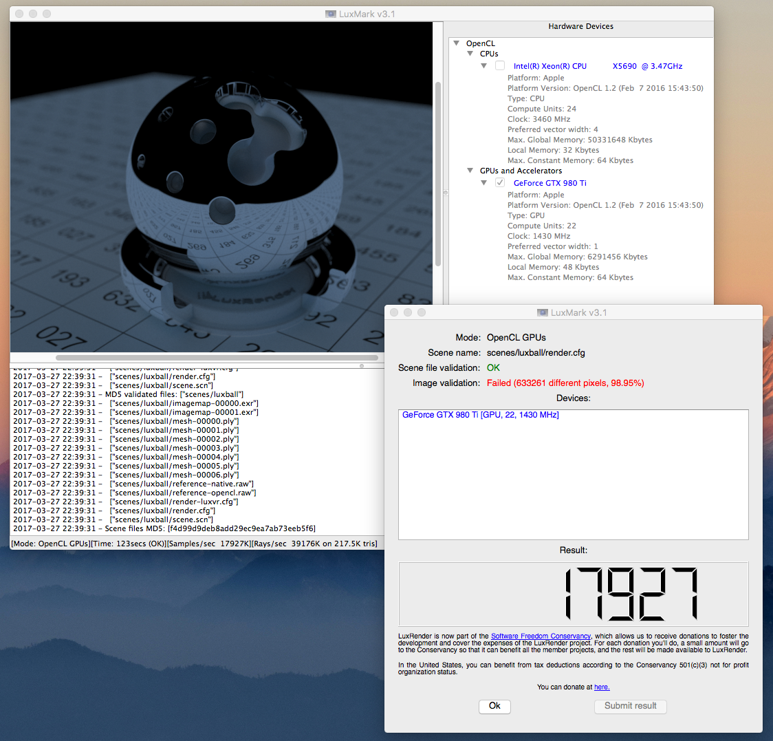

I`ve installed my GTX 980ti, loaded Windows 10 and installed the Nvidia drivers, first thing that I`ve noticed is that the GPU clock is higher than default, ebay seller informed me that it is a stable OC, and second bios on the card is factory clock, will play around with GPU clock speed tonight.
Back to macOS, did a clean El Capitan install, I`m still on El Capitan 10.11.4 due to some plug ins and Wacom device not working smoothly in 10.11.6 and Sierra:/
The results are on par with what others have reported, I am using latest Nvidia drivers for 10.11.4 and using FCPX 10.3.3.
So far, it is stable, but I have experienced the same image shuttering on FCPX when I try to preview videos. I did BruceX and got around 36-39 seconds (3 runs).
No problem on Adobe CC 2017, Premiere looks fine, will do some more testing in the coming days, my config is below:
