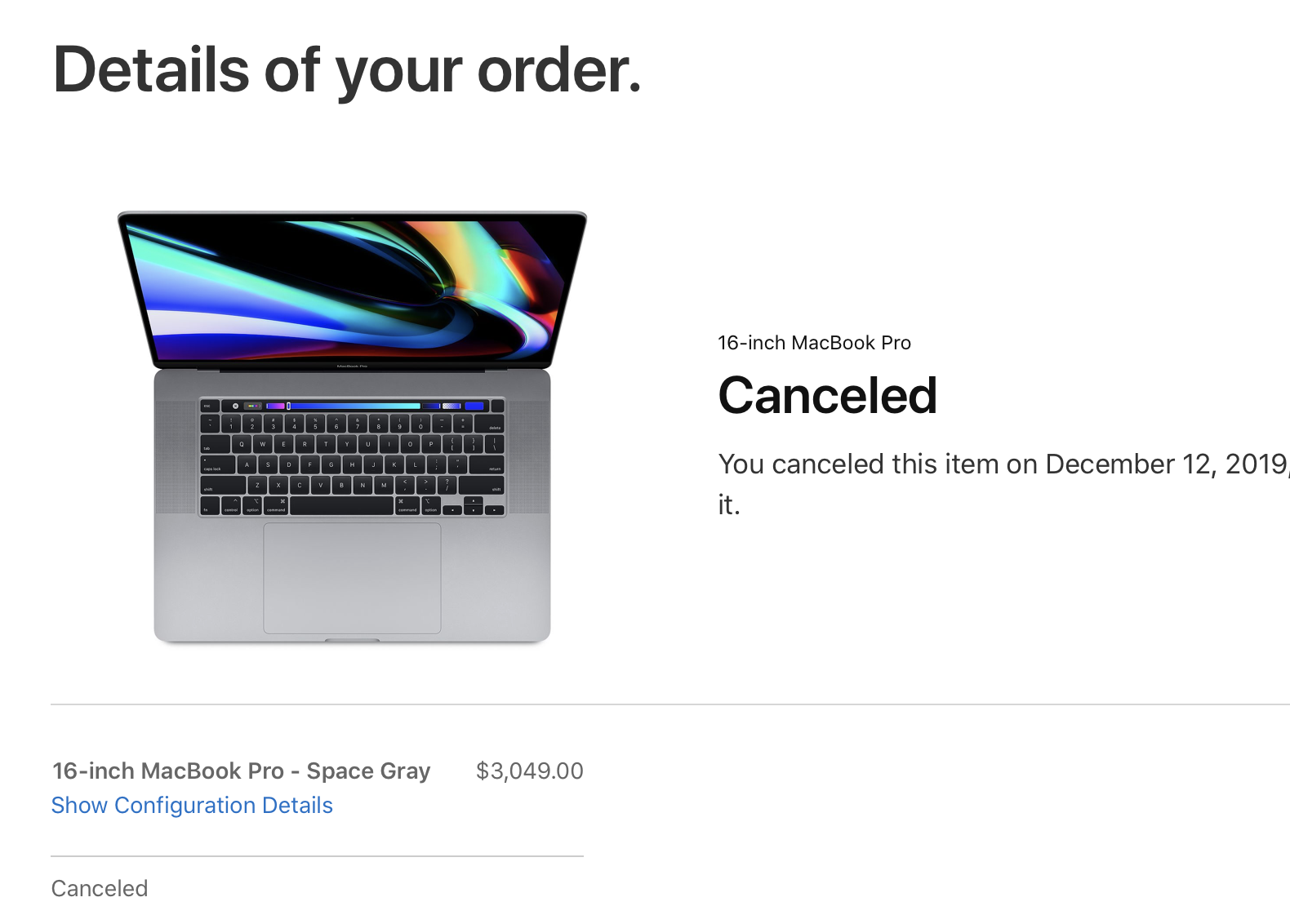

Thanks so much for letting us all know, we were all desperately wondering what your plans were with your order. I know I can rest easy now knowing that your cancelled it.
And FWIW, the popping has completely gone away for me with the latest Catalina update.
give him a rest...hes just trolling...he cancel the 16" that has proper cooling,keyboard but he keeps his 13" 2019 that also has this software pop issue
