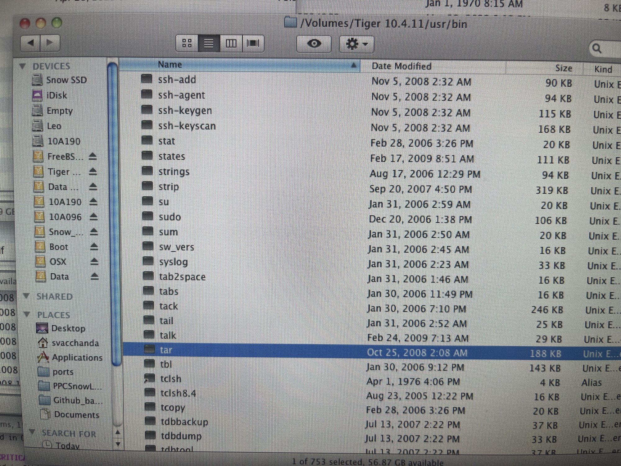

well, i tried, after installed the xcode v4 (most recent one for macos 10.4) and it's blocked on :
To the best of my knowledge, Josh is right, `tar`must be there. You rather re-install 10.4, since we do not know what else may be missing.
