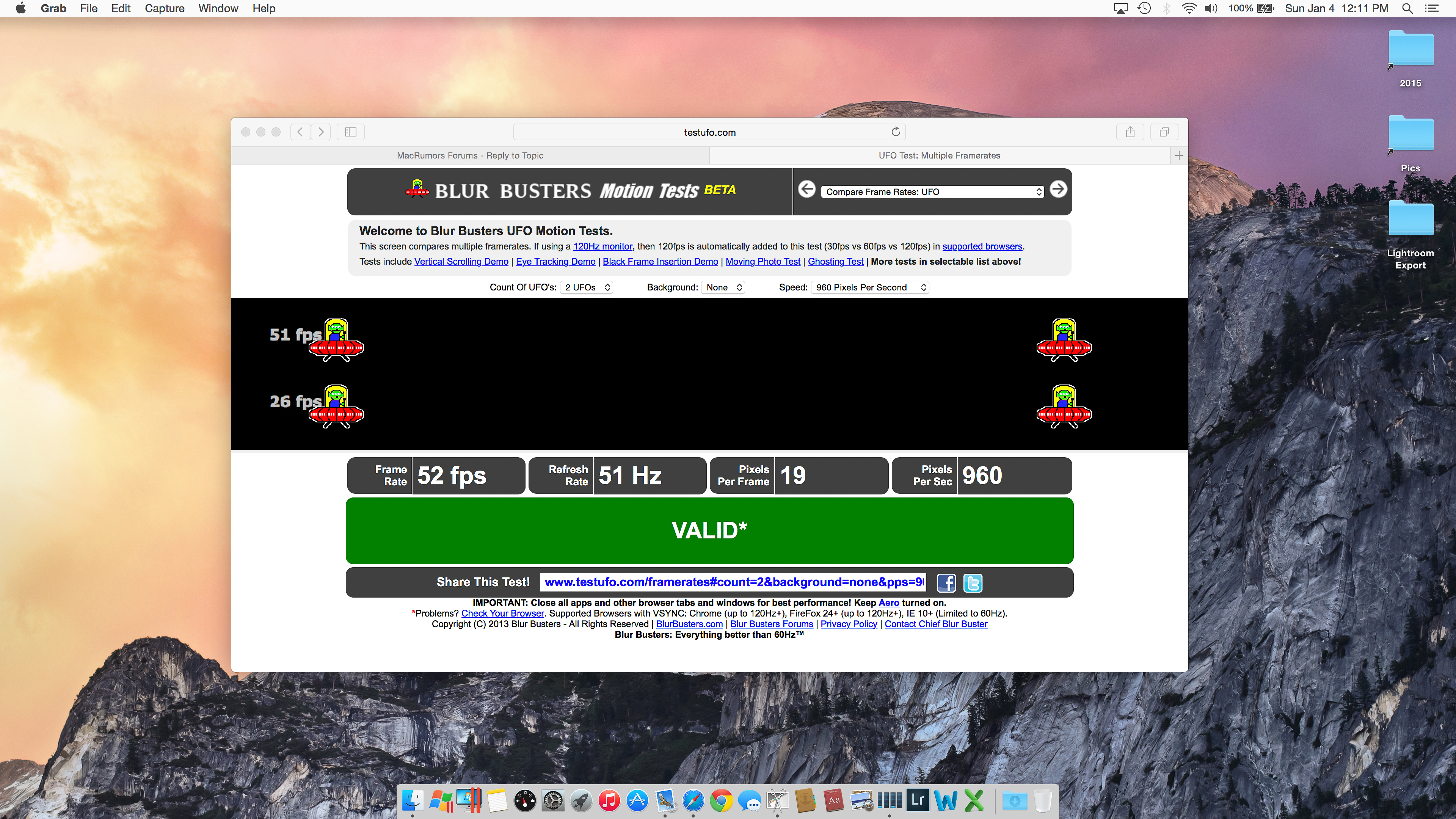

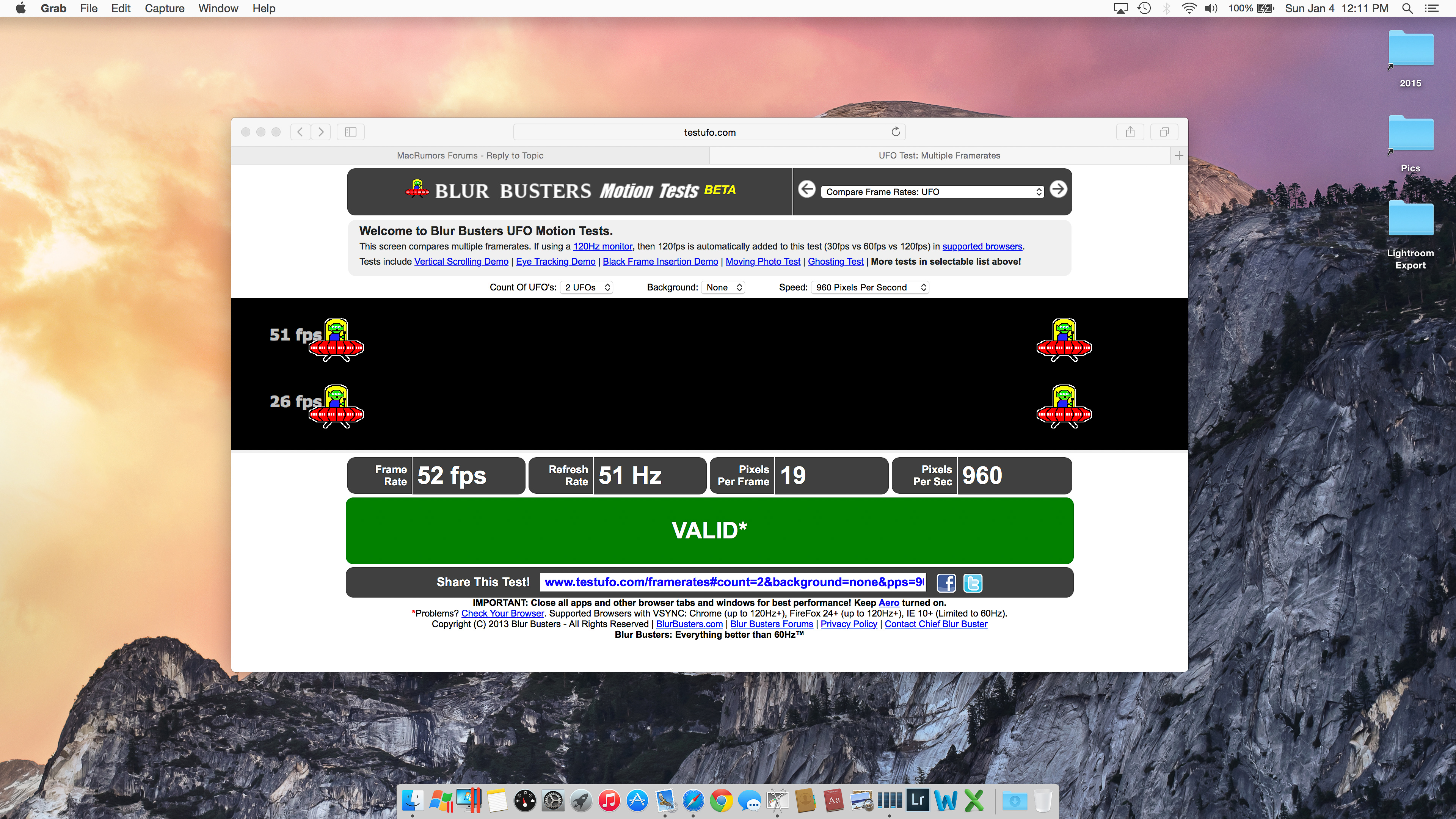

I'm running 4k at 1080p HiDPI on a retina MBP 13" (Iris 5100 gpu). Here's a screen shot with frame rate.

Hey, thanks for posting this! I have a quick question, are you still able to use HiDPI Mode while maintaining 50Hz? For example, if you selected one of the scaling options offered in the 'Displays' menu, would it maintain the 50Hz refresh rate? I'm thinking native UHD resolution of 3840 x 2160 may be too tiny, even on a 27"
yes, if you are able to run 1080p HiDPI @50hz, you'll be able to run 2160p @50hz.

What I meant is that you can get HiDPI 1080p (pixel doubled, 3840x2160) resolution on a 2014 mac mini or rmbp 13" with Intel Iris, but you won't be able to achieve pixel doubled 1440p or 1692p resolutions (these are availabe on the rmbp 15", nmp and new imac). These scaled resolutions use an internal resolution that is higher than the physical display resolution (for example the using a scaled HiDPI 1692p mode on a UHD display renders everything on a 6016x3384 internal resolution, which is then scaled to 3840x2160 and sent to the display). Display preferences has a nice nice selection panel where you can change the scale factor for Retina display if the graphics adatper supports these larger internal framebuffer resolutions. Again, this is not the case for the 2014 mini.
It's 50Hz...When I plugged in the same monitor via HDMI, It defaulted to 30Hz and was noticeably choppier.
