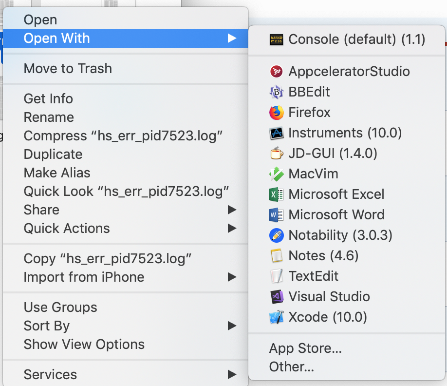

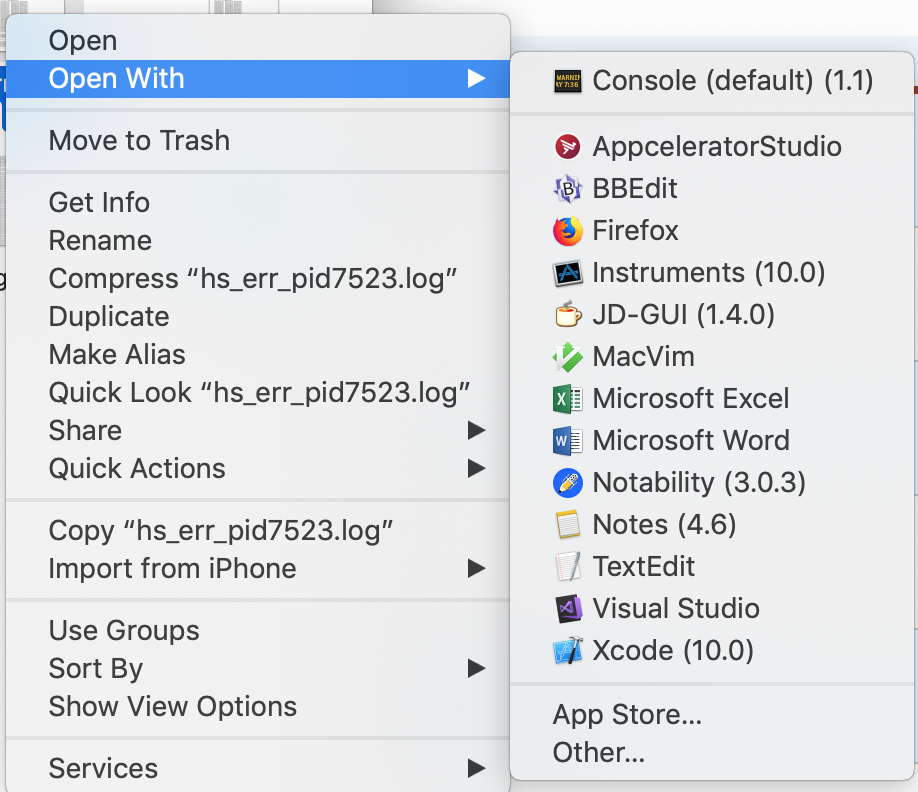

I just tried reassigning .log to a text editor in the way you describe, changing from the default, Console. Visually, when I select "Open With" it indeed looks like the assignment hasn't worked but when I double click it does open in my selected text editor. The Info dialog does show the correct app assigned also.
I rebuilt launch services. Same behavior. The reassignment works but doesn't show correctly in the menu.

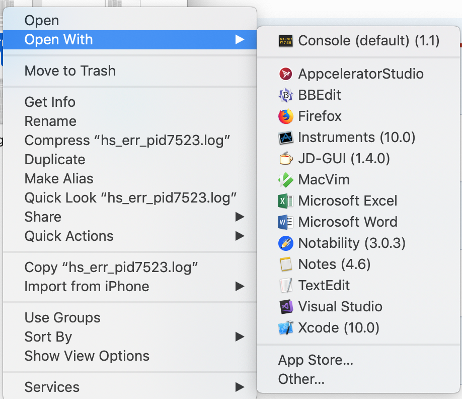

Basically, yes. When I reassign a file type and hit change all in the Info dialog, that filetype does indeed open in the nominated application when open it by double clicking.
The only real weirdness was that the right click -> open in menu didn't correctly reflect that

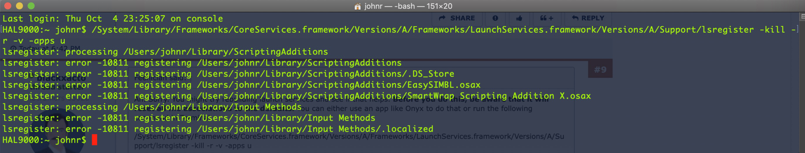

Restarted holding apple+R, Terminal/ csrutil disable/ return/ restart/

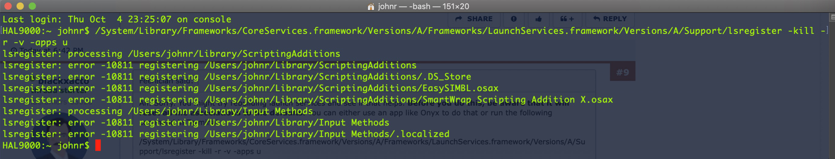

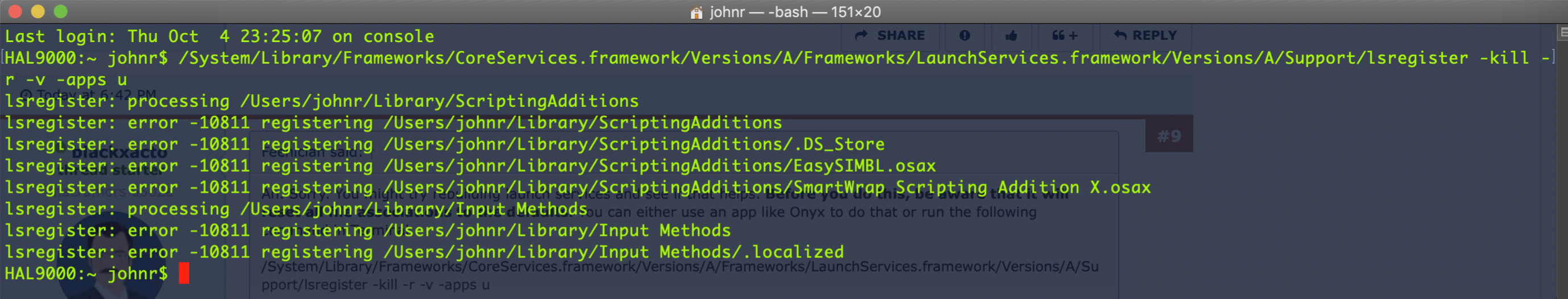

Terminal/cleared launch services/few errors, see attached jpg/

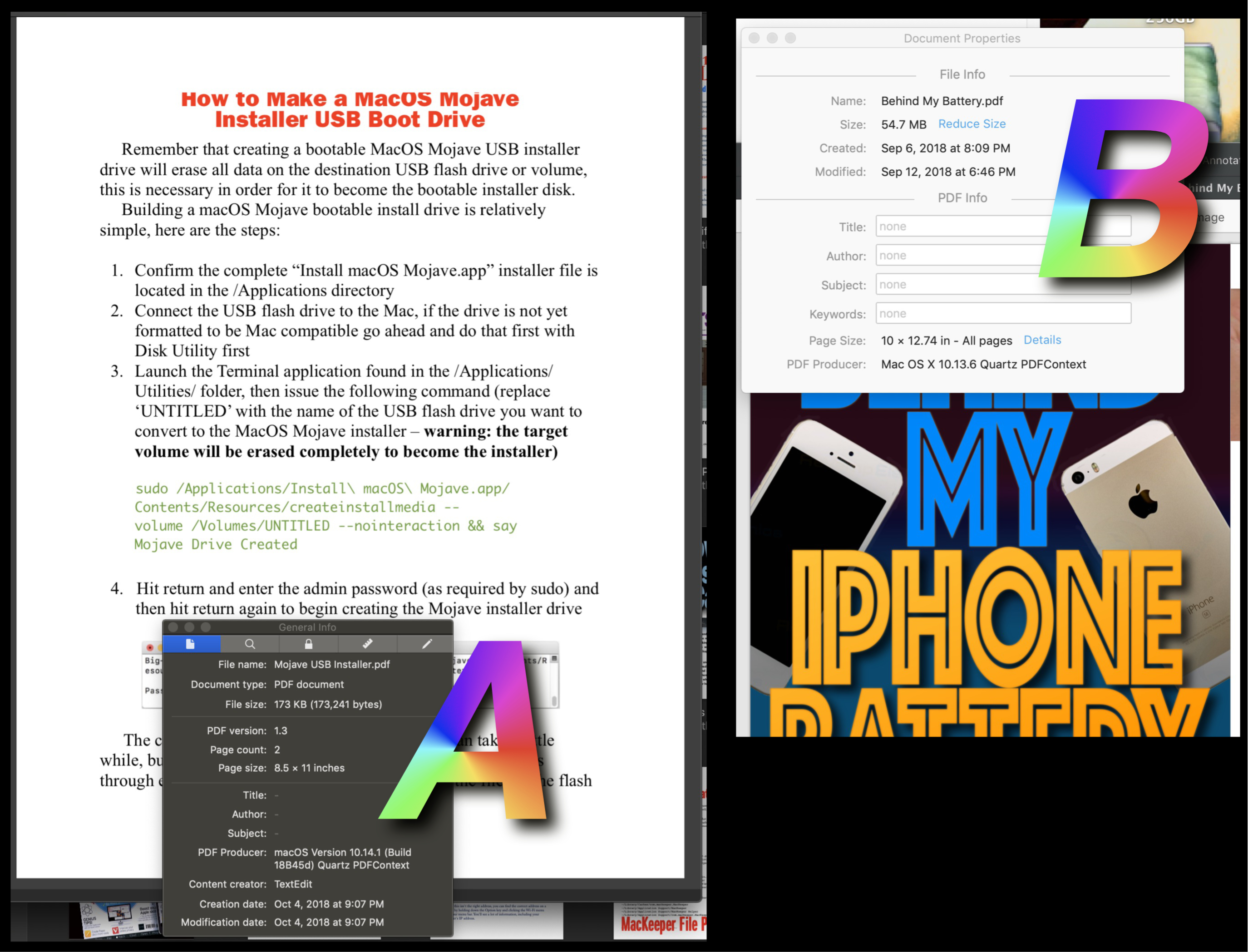

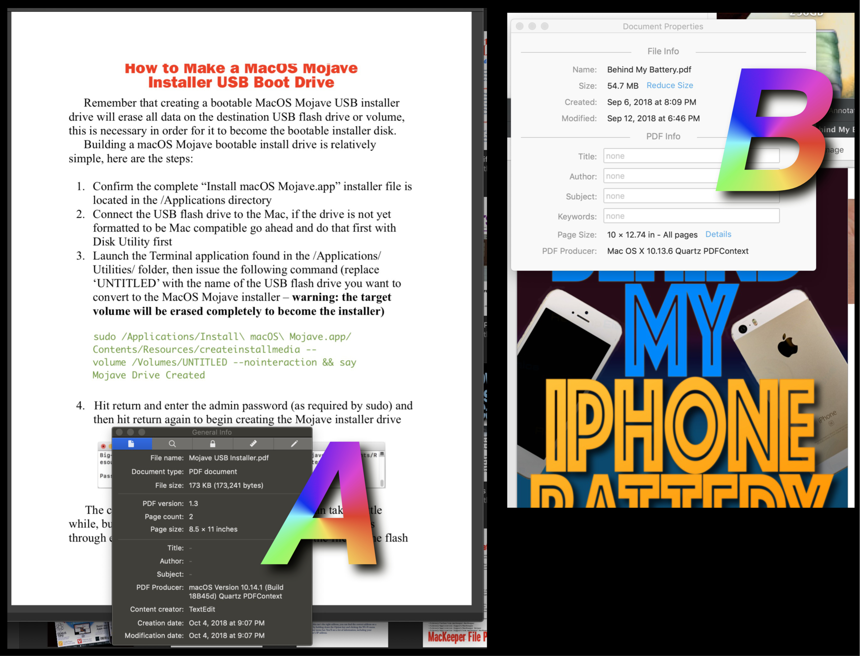

A PDF - made after Mojave was installed. Double-Click opens from Book app in Preview
B PDF - was made before Mojave was installed: Double-Click opens from Book app in PDFXpert editor
A=macOS Version 10.14.1 (Build18B45d) Quartz PDF Context. 8.5x11
B=Mac OSX 10.13.6 Quartz PDF Context. 10x12.74
I have done this with SIP and without. I have done this with apps added to Full Disk Access and without.
Does anyone see a difference in the pdfs that is causing this issue?

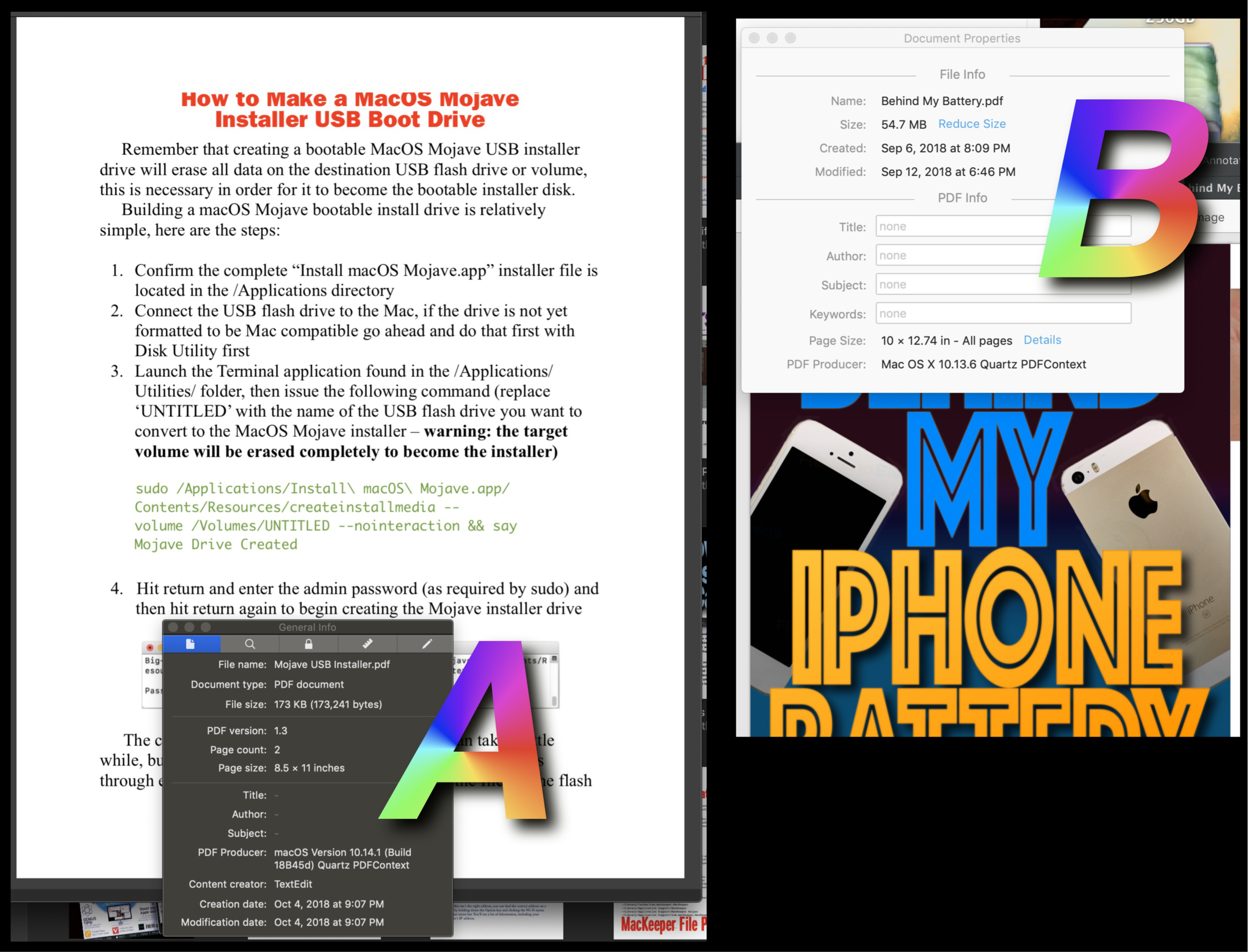

Did some more trouble shooting today. I have narrowed the situation.
I make multi page pdfs from textedit documents, then print to pdf. Various dimensions, but all made the same way. Before Mojave, When I placed a newly made pdf into iBooks, I could double click the pdf in iBooks and the pdf would always open in my pdf editor (As I had assigned all pdf's).
– Here comes Mojave –
If I make a pdf the same way as before Mojave and leave the pdf on my desktop, double clicking opens in my pdf editor, always.
–HOWEVER– If I move the newly made pdf into Mojave Books, double click the pdf in Books, the pdf always opens in PREVIEW. Even if the default app to open it is my editor.
What does this sound like to anyone? Does Mojave Books break the default settings?
