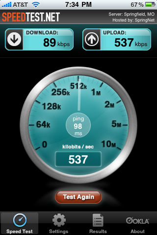

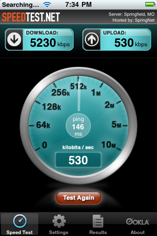

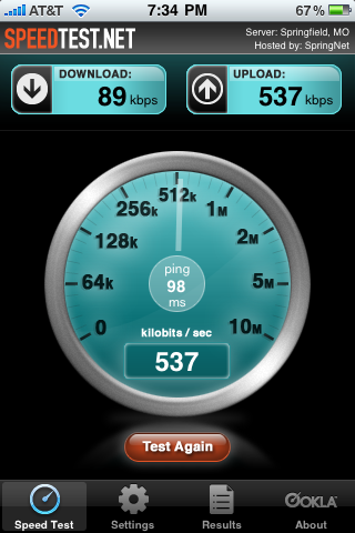

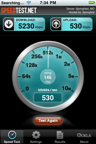

I have a 3G Iphone and just got a 3GS. Both phones have software 3.0 on them. 3G works fine on my wifi network at home on my linksys router. The 3GS connects and works, but it is so slow you can't even watch a youtube video without it timing out.
I use the speedtest.net app to test. See below. Pic on left is 3G working fine, pic on the right is new 3GS on same network sitting side by side with the 3G. Have reset phone, reset router, etc.. No luck.

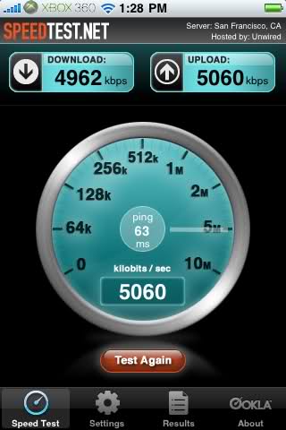

I don't think the Speedtest app is very accurate for the iPhone. I have 10meg Internet, which I get consistently on my computer. But with my iPhone right next to my wireless router set to 802.11g I only get 3meg download speeds most of the time.
WiFi "g" is supposed to be faster than my Internet speed, yet I can't even get my 10meg Internet speed with the iPhone right next to my router?
