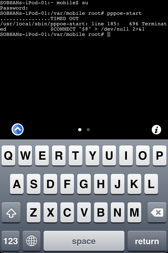

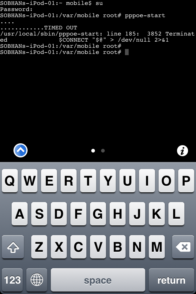

You were right about cydia sources.
I did what you said. (Installed Bigboss recommended tools in cydia and upgrade rp-pppoe-ios_3.10-3)

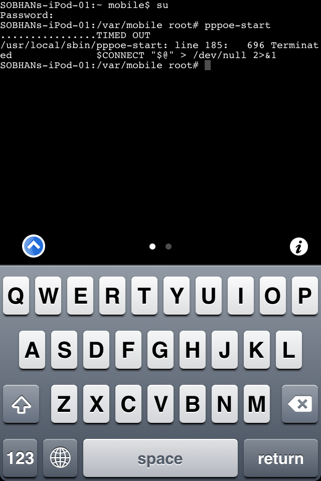

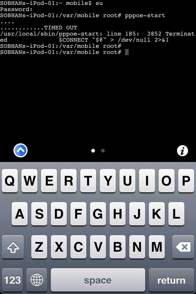

After a while when I tried to connect again, second picture error happend with
different codes after "Line 185: "
756,149,344,539,734,924,1115,1300,.....
Each time I run "pppoe-start" different digits shown and I'm not connected to the internet.

After a while when I tried to connect again, second picture error happend with different codes after "Line 185: "
756,149,344,539,734,924,1115,1300,....." Each time I run "pppoe-start" different digits shown and I'm not connected to the internet.
Huh, that's very strange. Honestly, I have no idea. Could you post another screenshot of this when it happens to you?
You could try completely uninstalling RP-PPPoE and reinstalling it. Remove it in Cydia, and then delete all files from /etc/ppp directory. Then reinstall in Cydia again, and re-run pppoe-setup.

First and second attachments are the screenshots.
each time I run pppoe-start one of numbers I said in previous post comes
instead of 3852 or 696.

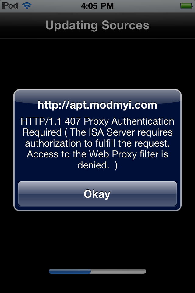

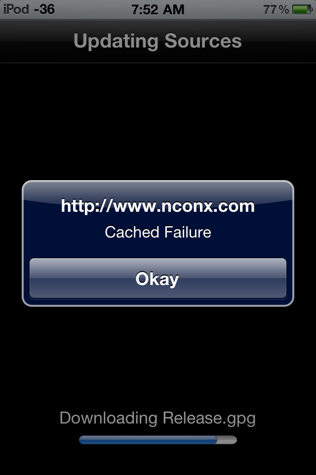

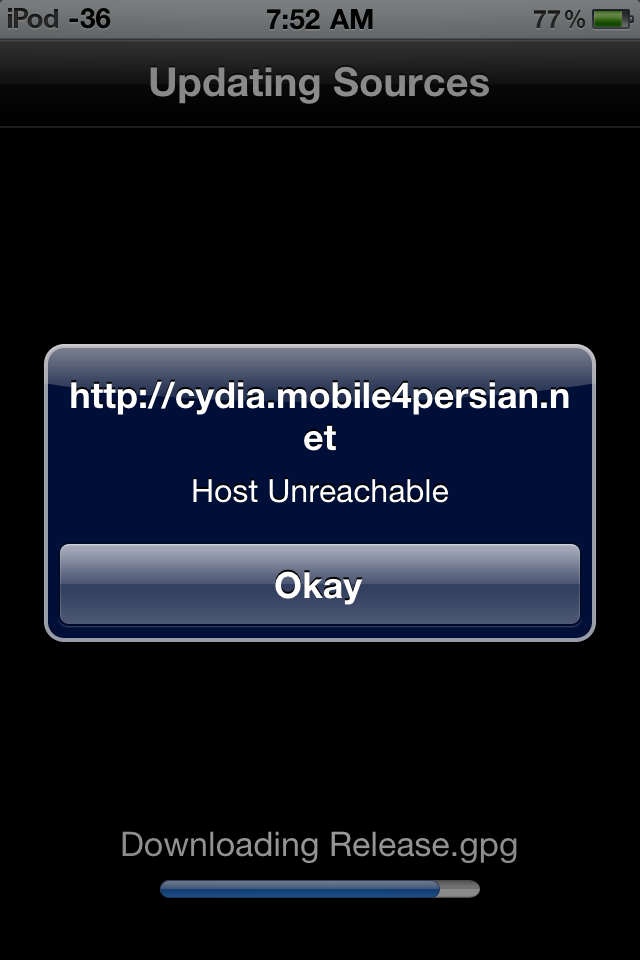

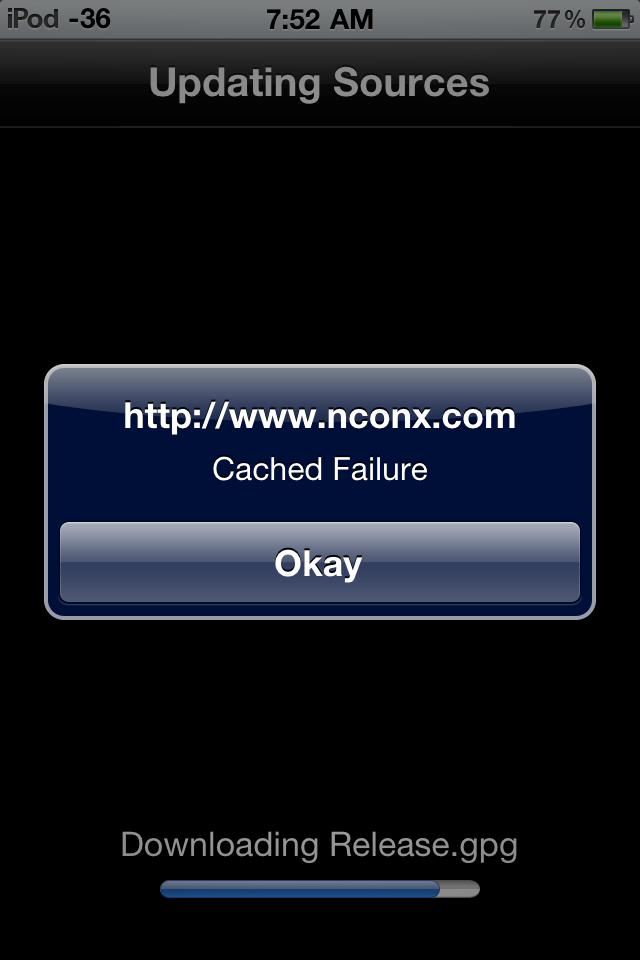

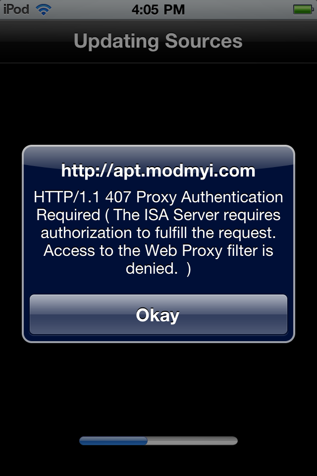

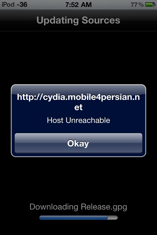

Also I have another problem, When I want too update your source or another one, errors occurs like third and fourth and fifth attachment.
I shoud say that I have access to internet in my office through LAN network with authenticated proxy.(username and password)

Excuse me because of my silly mistake.
After Upgrade I forgot to re-run pppoe-setup,and I think All of that errors happened because of this mistake.
All of Problems is Fixed now and thanks for your effort.
