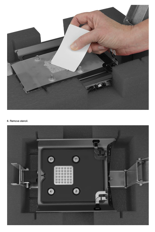

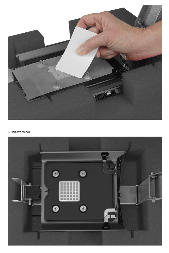

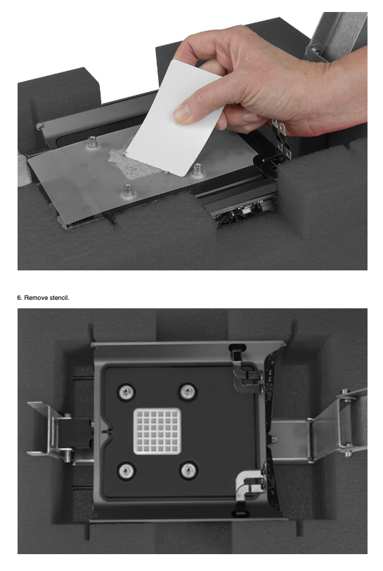

I have heard various methods about applying thermal paste. I plan on upgrading my CPU to a 12-Core. I heard the "X" method, and the "Bean" method etc. Since the top of the CPU chip is large (where you would apply the thermal paste), how much (or how large) should be applied? Should I apply thermal paste on both the CPU chip and heat sink or just the CPU chip? I have heard both, but still not sure. Thanks for the help.

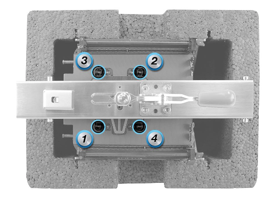

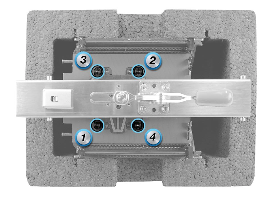

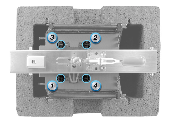

You could do it however you want, but the official Apple method is to lay the special thermal grease stencil over the chip, apply enough grease/paste to fill all the square holes and then remove the excess using the access card. Then lift the stencil off and you're left with neat little squares of paste on the chip. Then secure it back onto the thermal core. Tighten the four T10 screws in the sequence shown in the picture to exactly 1.2 Nm.

seems like a good way to quickly (assembly line method) get it done and consistant.
But...nowhere to get template, especially just for 1 or 2 regreasing.
