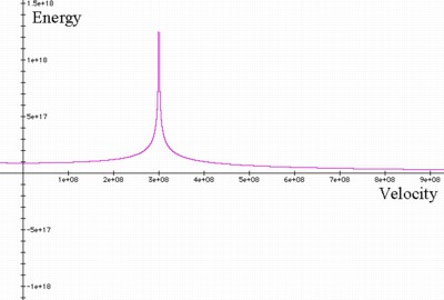

Originally posted by Mr. Anderson
That's a 2D representation. Rotate that curve around an axis diagonally through the center in the quadrants that don't contain the curve and you get a way to reach both sides (requires more dimensions, but there actually are so it might happen) :D
D
Actually, it's a 2D representation because it has to be. And, no, there aren't more dimensions. What's missing is the units on the graph. Also, the assymptote is not located around the origin, but around the speed of light. So, it takes an infinite amount of energy to accelerate from below the speed of light to the speed of light, or to decelerate from above the speed of light to the speed of light. So, in principle, if there were a way to skip over the speed on light, then it would be possible, from an energy stand point, to go faster than light. In fact, it would get easier to go faster.
However, I am glossing over one significant point. Inorder to be traveling faster than the speed of light an object needs to have an imaginary mass. What is imaginary mass? Well, we really don't know. The models that we have don't prohibit it, but we've yet to see anything that's made of imaginary mass. (Which makes sense, as something with imaginary mass would have to be traveling faster than the speed of light...)
Here's a better graph:
I'll be damned. Another PacificT.com Graphing Calculator connoisseur! :eek: :D
