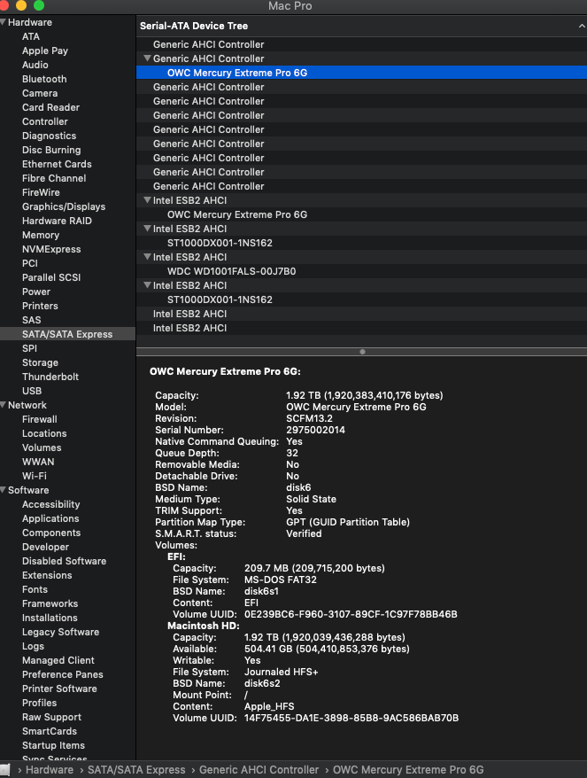

My cMP3,1 shows Intel chipset for my internal drive bays, but I'm using an OWC Accelsior S PCI card/SSD drive for my boot drive which shows up under "Generic AHCI Controller", so I'm reluctant to try the ROM Patcher.
You only have to worry about the chipset that is inside your computer, it won't mess with the firmware of your pci card.
