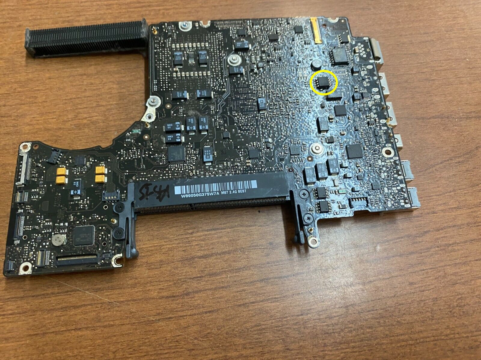

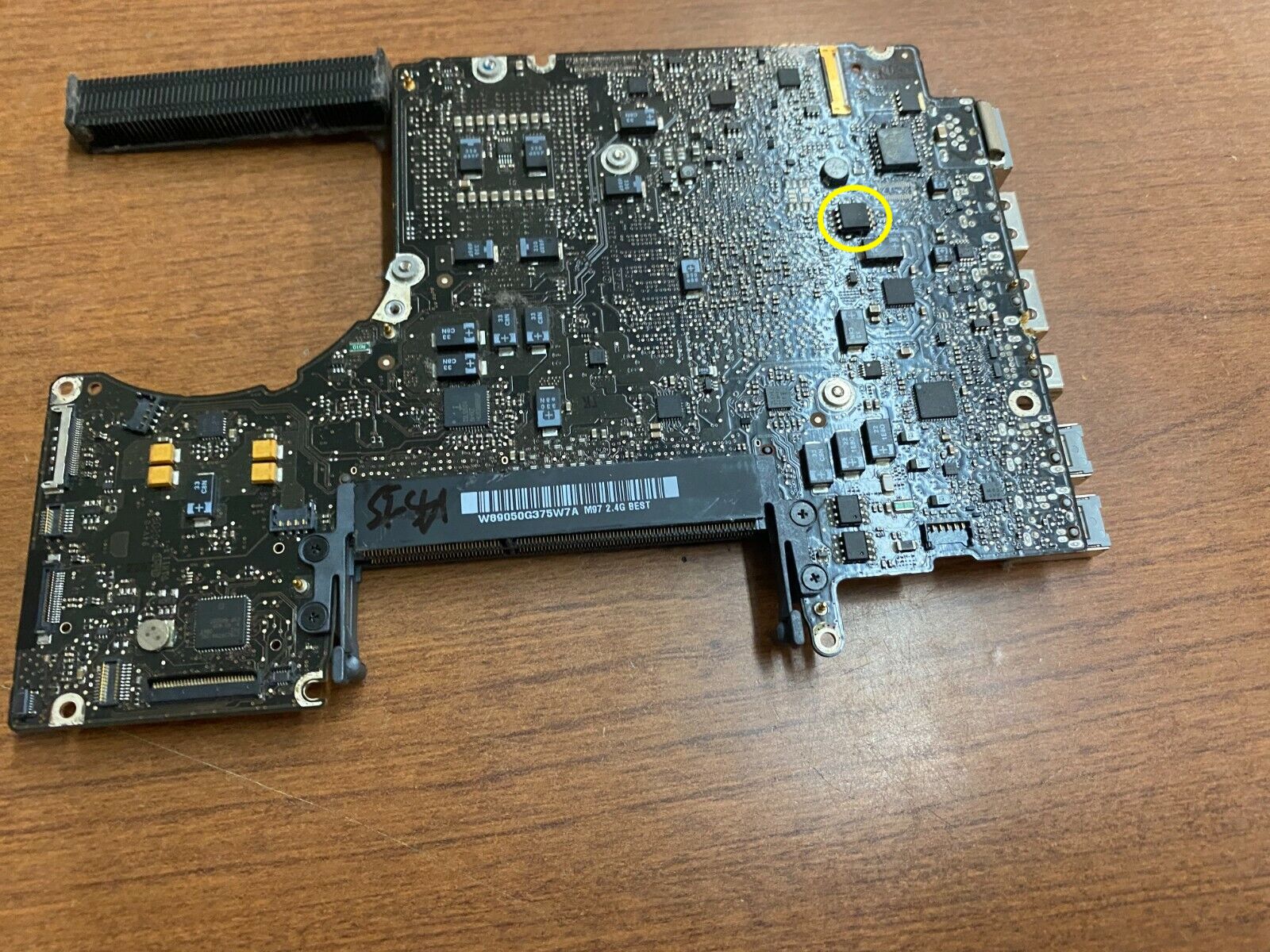

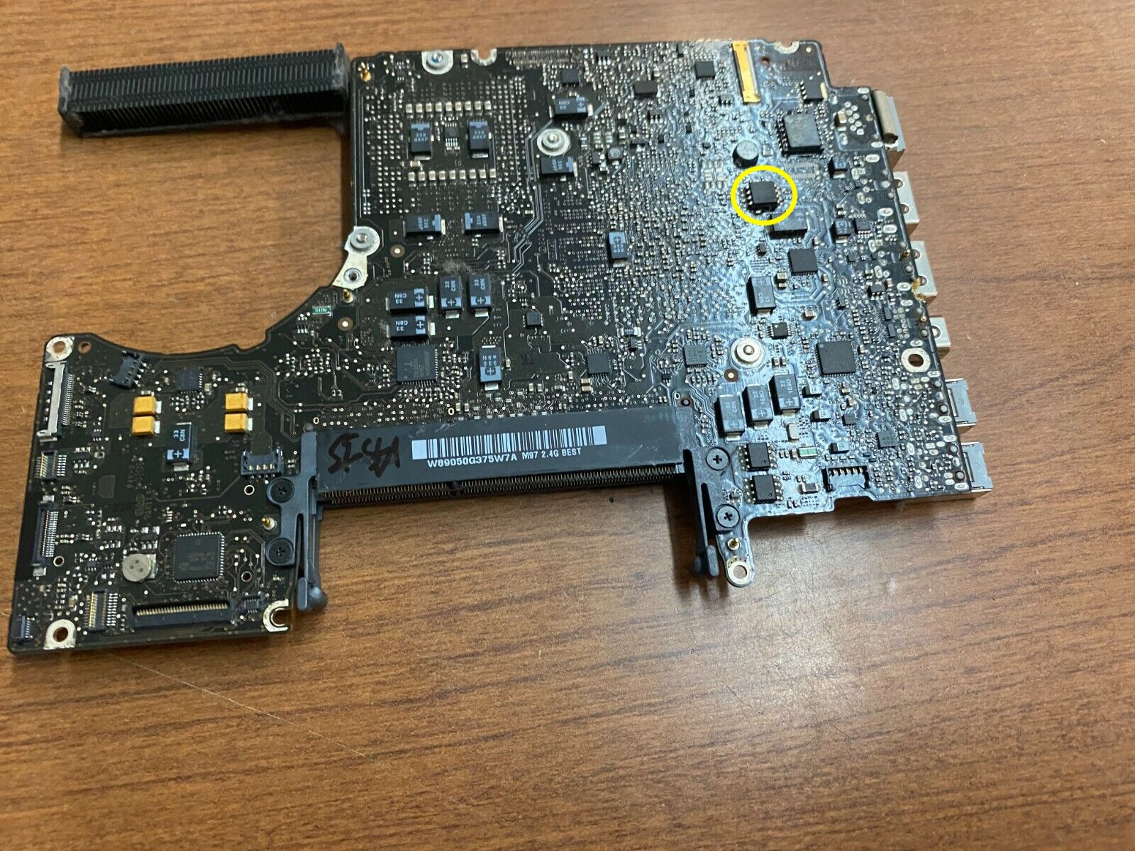

I have successfully applied APFS ROM patcher on a MacBook5,1 (2.0Ghz) logic board in 2020. I was planning now to do so with a 2.4Ghz. However, this latter one comes with multiple ROM definitions and the patcher suggests to identify the EFI chip before to apply it in order to choose the correct chip model.
I have identified on the logic board what it looks like a ROM chip which is spotted by a yellow circle in the picture I have attached. It reads the following code: MX12G2523205D.
Can anyone confirm me if this the ROM chip the APFS ROM patcher was asking for?

I have successfully applied APFS patched on a MacBook5,1 (2.0Ghz) logic board in 2020. And now, I was planning to do so with a 2.4Ghz. However, this latter one comes with multiple ROM definitions and the patcher suggests to identify the EFI chip before to apply it in order to choose the correct chip model.
I have identified on the logic board what it looks like a ROM chip which is spotted in the picture I have attached. It reads the following code: MX12G2523205DM2I.
Can anyone confirm me if this the ROM chip the APFS patcher was asking for?
I am in a very similar situation with my MacBook5,1 as I have two logic boards 2.0Ghz and the 2.4Ghz. I had no issues patching 2.0Ghz board however 2.4Ghz board presented me with a choice to select the right chip and I decided against going through with it. The reason for this is while dosdude1 did an incredible job with the APFS ROM patcher it was impossible for him to collect the dumps from all the possible chip variations. It seems that there are too many of them which makes the probability of bricking your Mac very high.
Reactions: aurora72
I am in a very similar situation with my MacBook5,1 as I have two logic boards 2.0Ghz and the 2.4Ghz. I had no issues patching 2.0Ghz board however 2.4Ghz board presented me with a choice to select the right chip and I decided again,st going through with it. The reason for this is while dosdude1 did an incredible job with the APFS ROM patcher it was impossible for him to collect the dumps from all the possible chip variations. It seems that there are too many of them which makes the probability of bricking your Mac very high.
I have been very cautious with this for the very same reason you have pointed out here and decided not going through with it. Yet I have recently spotted that ROM chip whose ID model matches with one of the choices that the patch presents to select. It seems a correct match, however, I don't know if I have spotted the right chip...
I have been very cautious with this for the very same reason you have pointed out here and decided not going through with it. Yet I have recently spotted that ROM chip whose ID model matches with one of the choices that the patch presents to select. It seems a correct match, however, I don't know if I have spotted the right chip... this feels like playing Russian roulette...
I actually wanted to mention that if you have found an exact match to the every letter and every digit you will probably have more chances for success as long as your Mac does not go to sleep or lose power during the flashing process. It is a tough choice to make regardless considering that the OCLP allows you to boot APFS partitions without any BOOT ROM patching from what I understand.
