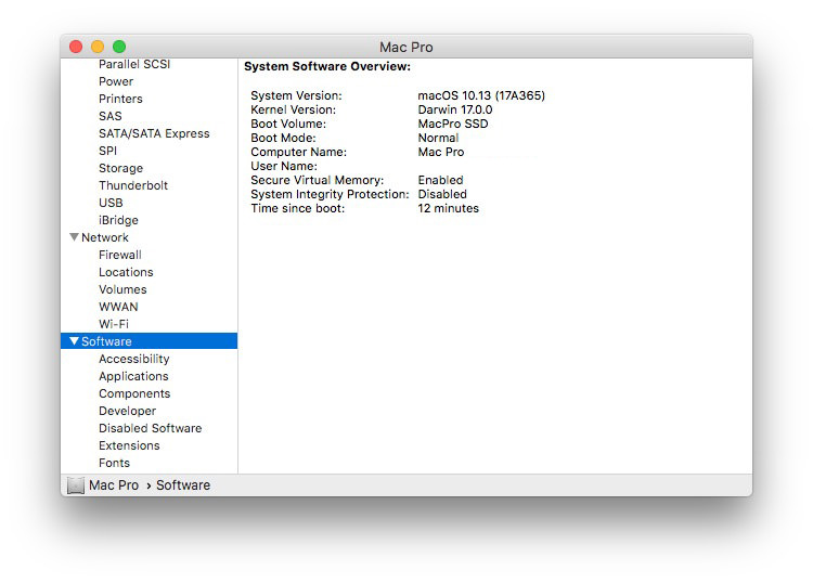

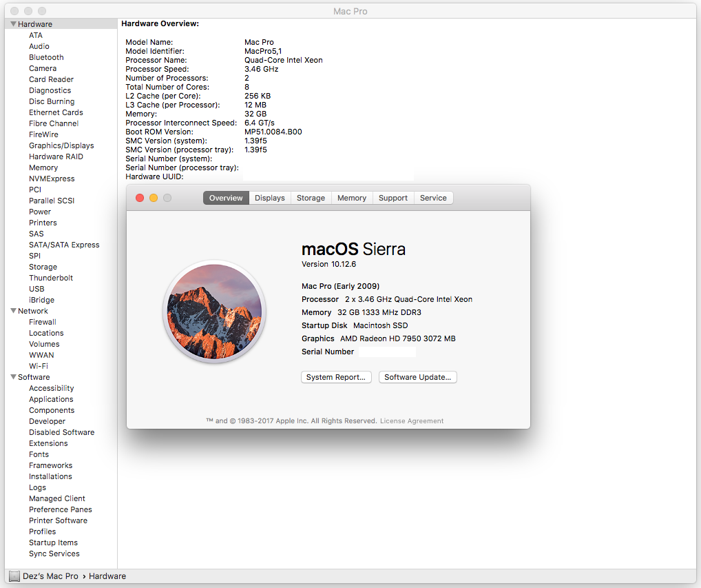

Success on an Early 2009 Mac Pro (4.1) with the 5.1 firmware update/flash.
Ran the installer, and it asked me to update the firmware. I cancelled, powered off, and replaced my GPU with the standard one that came with my Mac, the GT120.
Booted again and re-ran the installer. It asked me again to update the firmware, which I now accepted. I powered off, and held the power button until the led flashed and it beeped.
It proceeded with the firmware update, which took ~5 minutes (for those who can't see the screen), and then it booted into Sierra. I checked the firmware version to confirm it worked (it's now at MP51.0084.B00) and re-re-ran the installer.
It now installed High Sierra normally, which took about ~40 minutes, probably because it had to update the file system to APFS.
And that's it. No issues so far.

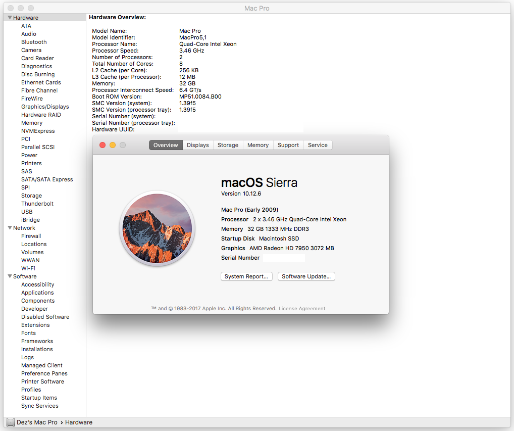

I upgraded the CPUs in My Mac Pro today from dual X5570s to Dual X5677s and I noticed that on first boot the RAM speed was already at 1333Mhz, I was expecting 1066Mhz then do a PRAM reset to get it to show properly...
Not sure if this is because of the new firmware but...
PRAM reset is not necessary required, but just a quick way to fix it. I never need to do that after any CPU, RAM change.

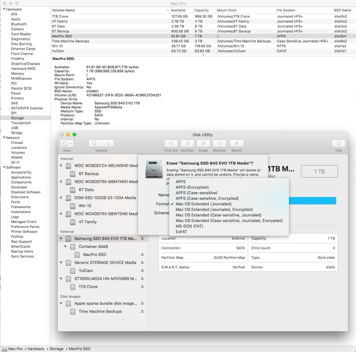

High Sierra also runs fine on Mac Pro on a SSD with Mac OS Extended (Journaled) format.
Cloned the High Sierra installation with CCC to an external Hard Disk with Mac OS Extended format, booted the external disk, erased the APFS formatted SSD according to https://www.macobserver.com/tips/deep-dive/macos-sierra-delete-apfs-partition-right-way/ and cloned High Sierra back to the SSD.
Note: It is not possible with the High Sierra harddisk utility to format an SSD to Mac OS Extended format, only APFS is indicated to choose from.

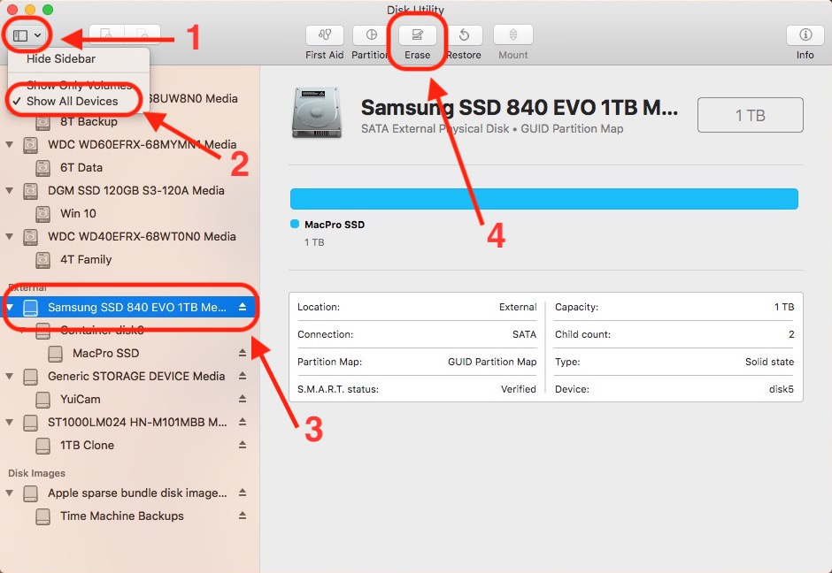

High Sierra disk utility can format a APFS SSD back to HFS+

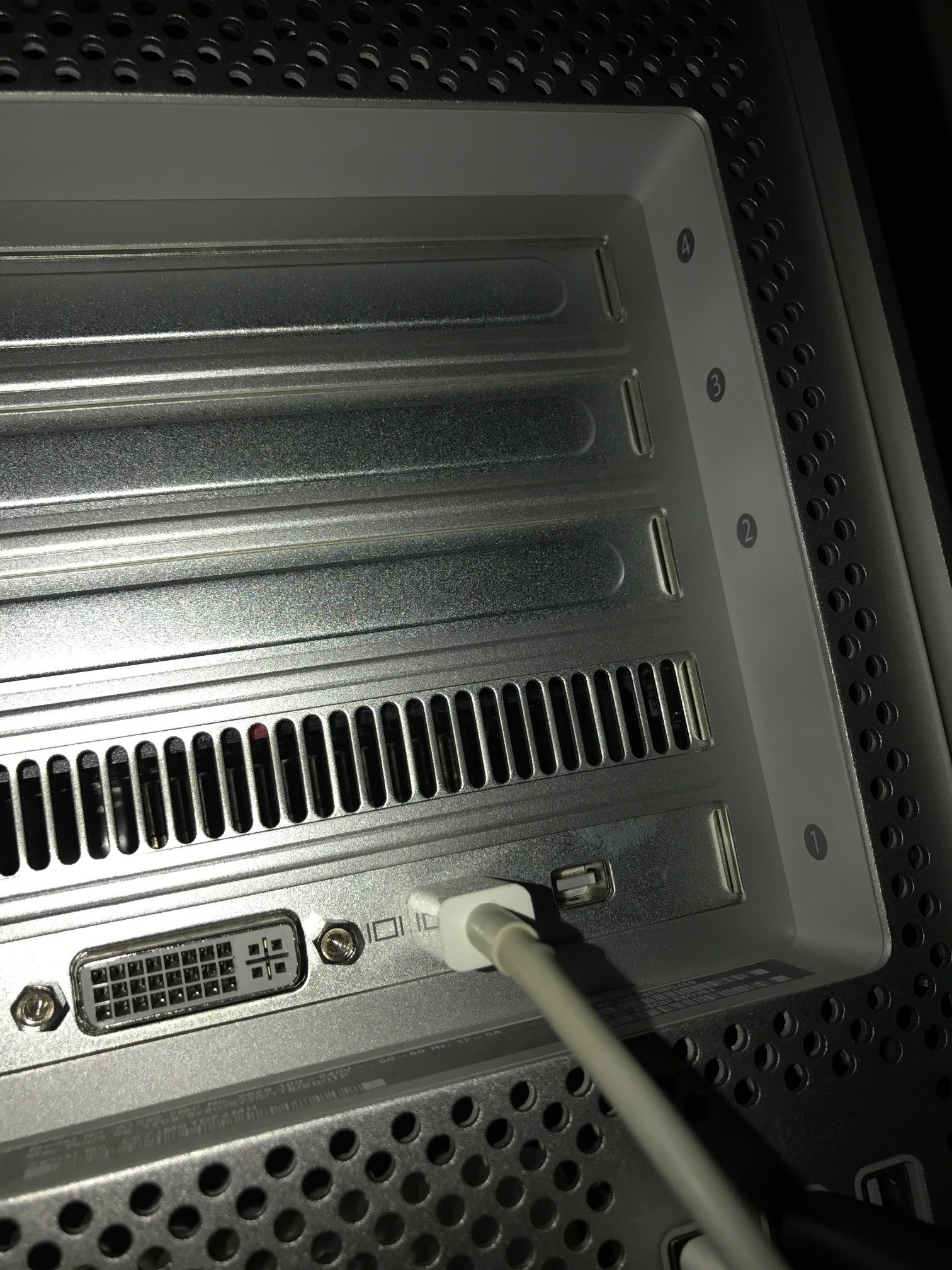

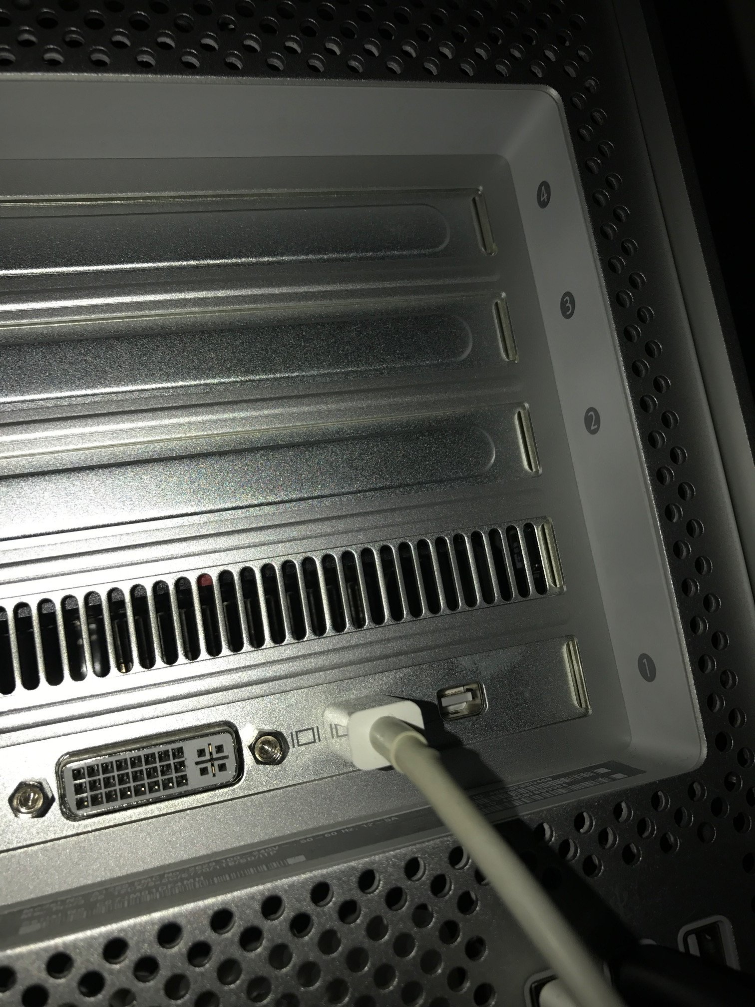

I have the same issue as Kris. How to check if I have a EFI video card? I'm not able to install High Sierra now :(

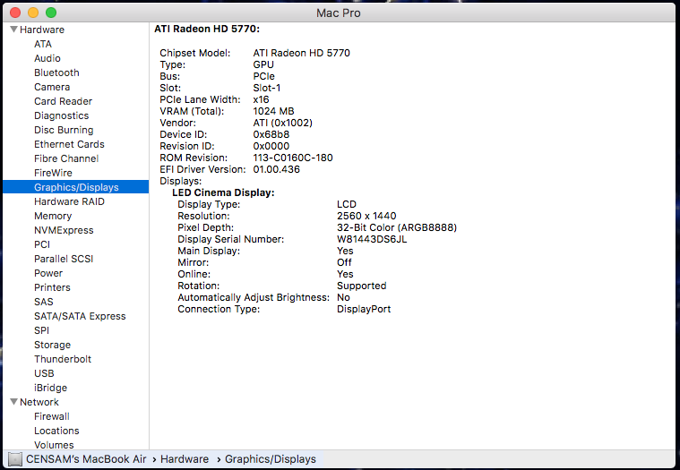

Your GPU should be an Apple 5770, or at least a flashed one. Both can finish the firmware upgrade anyway.

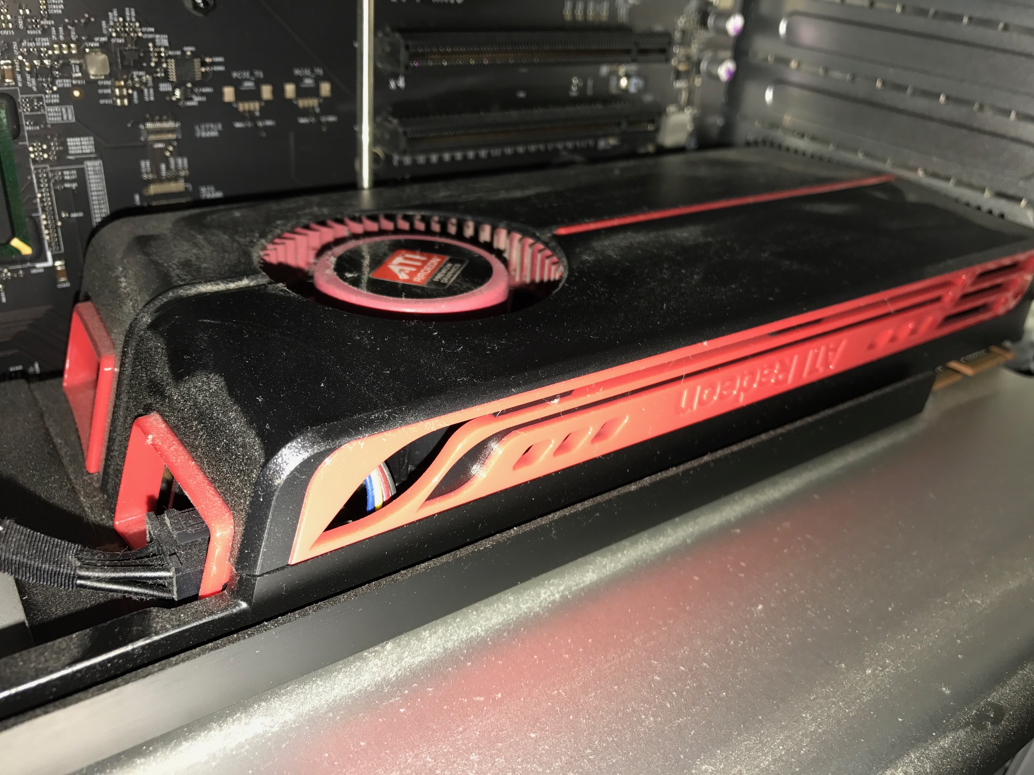

One of the easiest way to determine if that’s a real Apple card is to open up the case and post us the real looking of the card.

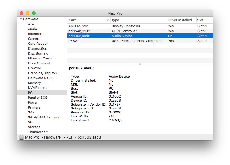

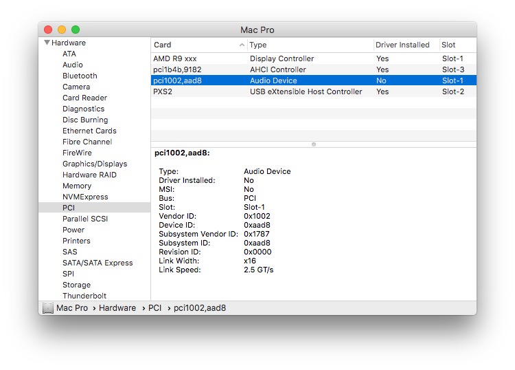

Anyway, for others info. The PCI page is fixed for non flashed GPU (even no HDMI audio installed). It's too bad that the HDMI audio work natively during Beta and Apple intentionally took it away.
I am particularly hacked off by Apple deliberately breaking the HDMI audio support after the first betas supported this.
Apart from the facts that it has been well proven to work fine in Boot Camp, and even in OS X via a third-party KEXT, and as we have seen worked in the early HS betas, when the next new Mac Pro ships which is supposed to support internal PCIe video cards people will be quite rightly livid if Apple cripple those cards in a brand new model. Since the next new Mac Pro will be running the same OS and the same PCIe video cards as the classic Mac Pro having it working in one means it should work in the other or vice versa.
Since it did work in the early HS betas, is anyone able to spot what the difference is that allowed this? Was it as simple as a change to the relevant Radeon Kext file or a plist inside it? Or would a DisplayOverride file do the job?

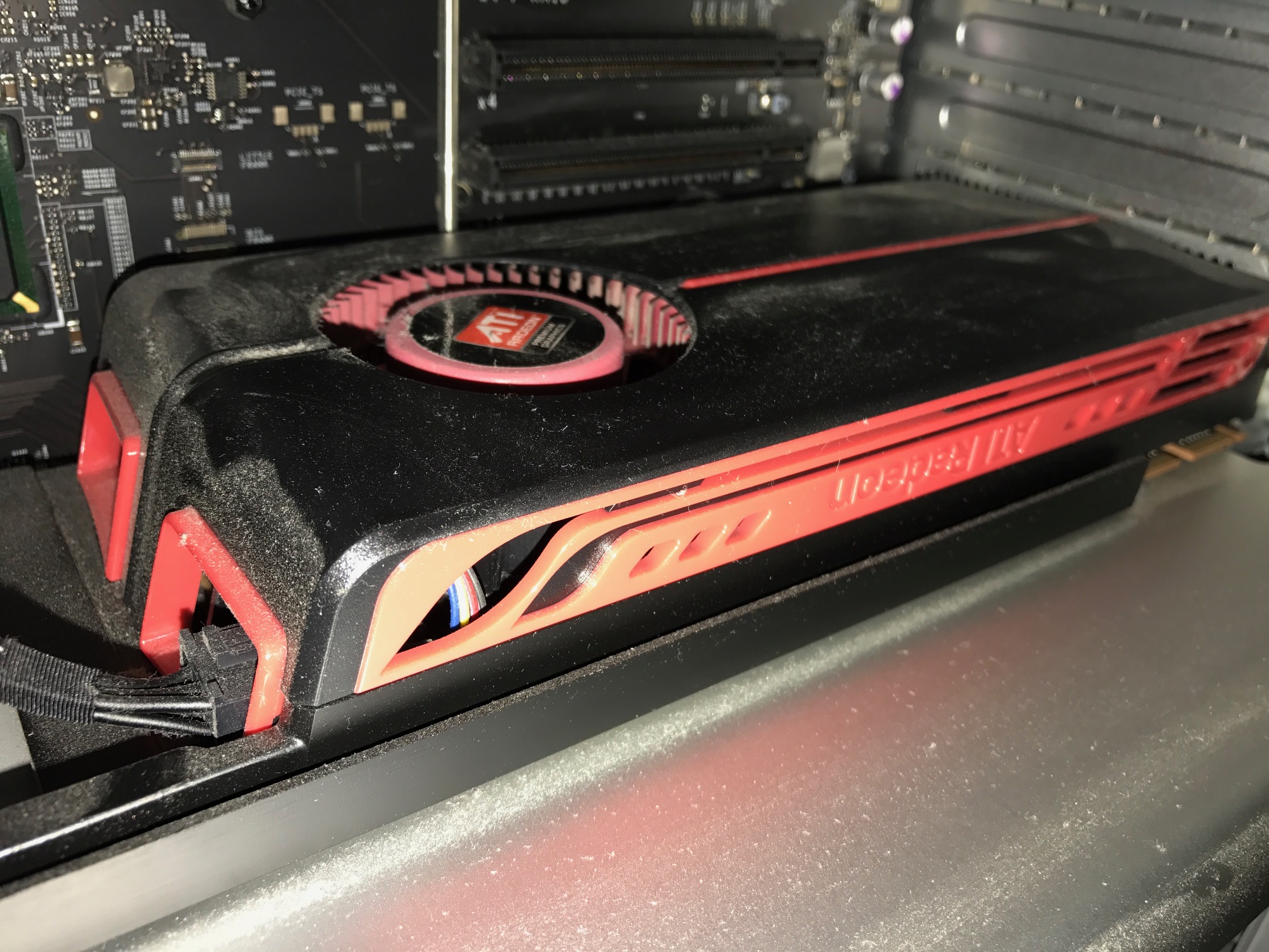

Attached some pictures. Is this the one?
Yes, I tried a direct download from App Store and run the installer.
[doublepost=1506762658][/doublepost]
You have an EFI card if you get a boot screen. If not, then no Mac EFI.

I do get a boot screen. From what I've read on this thread, the upgrade should work for an EFI card. But it doesn't
Yes, this is a Apple 5770.

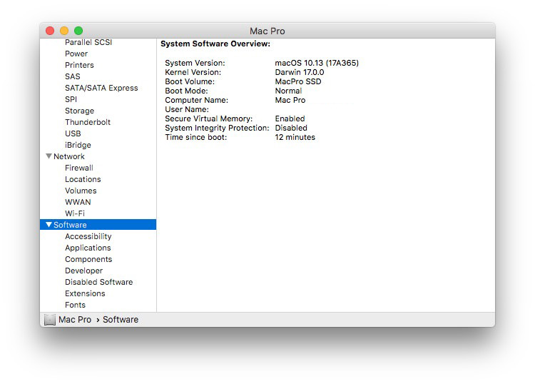

Ok, so I went for it and........
You don't really need the separate firmware updater. Download HS, run the package and it'll ask you to power down and restart.
You do this by holding the power button until the power light flashes or you get a long bleep, mine did both. (Before doing so though, I removed all non apple hardware which also meant popping the SSD into a SATA bay). It'll restart with the new firmware back into the original OS and of course from that point you have the option to stay with 10.XX

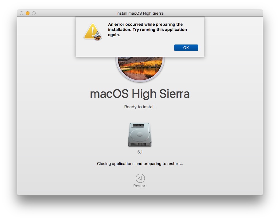

Incidentally when I continued to 10.13, it failed 3 times, I restarted and it failed again. I put Rootless back to how it should be and again, fail.
I downloaded a fresh HS package and it worked.
Reactions: h9826790
