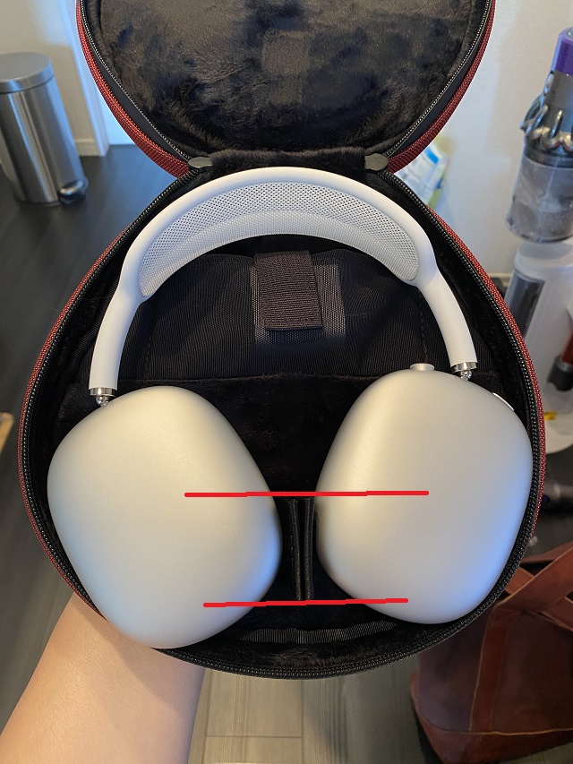

Another observation from another perspective. The APM does not wake up in the morning is because after being placed in the case, it still attempts to connect and disconnect in cycles (observe your Bluetooth settings). After a number of cycles the APM locks up. Another indicator is the Battery widget will appear to report on the APM battery but it's actually not a live reading because your APM is already locked up.
This is almost like the case magnet is there but almost hitting the low power mode switch but only partially causing the APM firmware to trip. My speculation of course.
Also another note, I believe my case is Batch #24 and the magnetic butterfly looks very different from all the photos posted online. The butterfuly also sits a lot lower - have no idea if this is going to be any different.
Update:
Have reached out to Apple, they are replacing my APM with another unit, we shall see with my replacement if this is still the case.

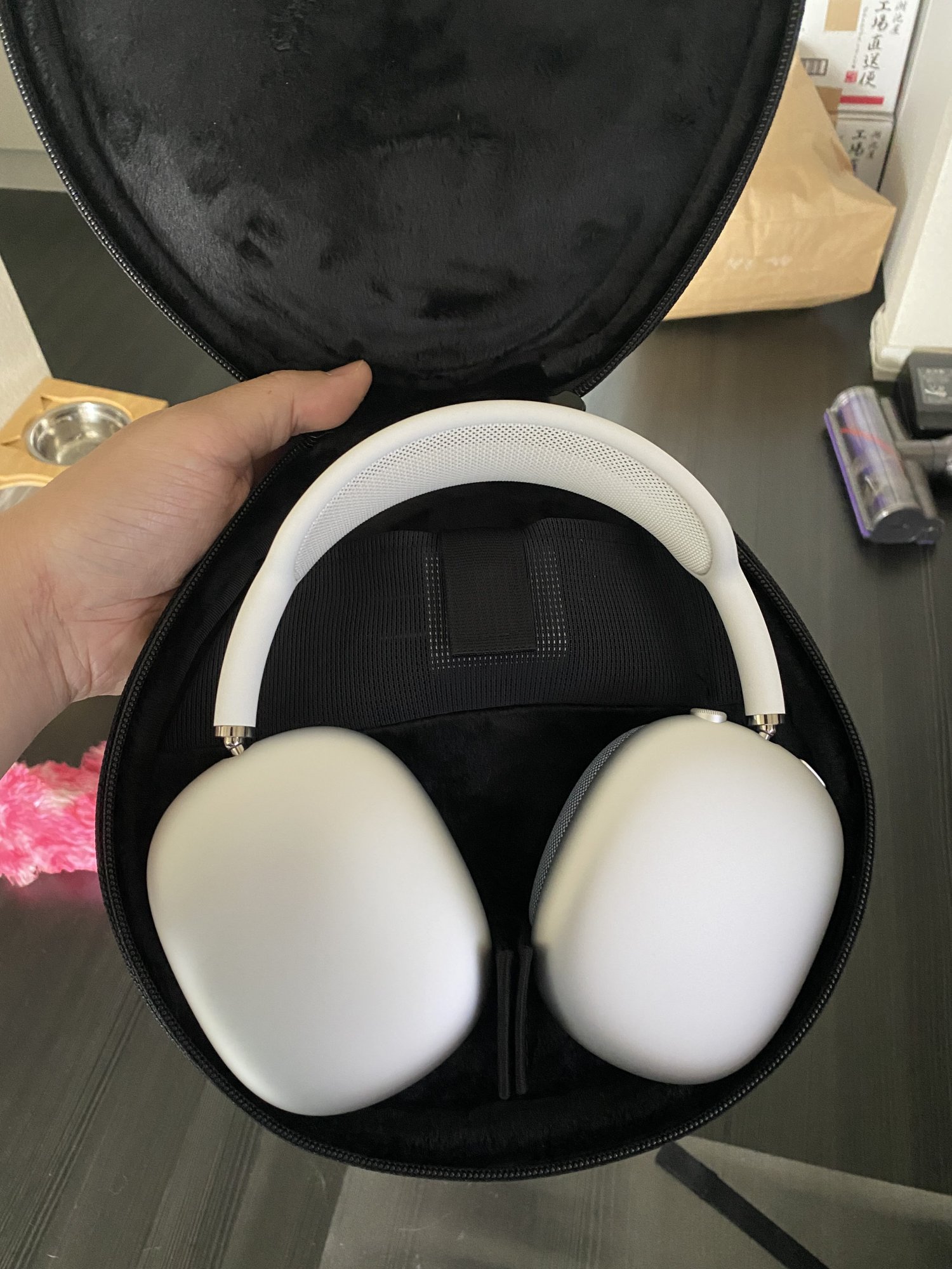

is your APM attempting to connect and disconnect in cycles (observe your Bluetooth settings). After a number of cycles the APM locks up. Another indicator is the Battery widget will appear to report on the APM battery but it's actually not a live reading because your APM is already locked up.
take a look at the photos attached, old case where the magnets are lower and new case where it sits right where the two ends of the AirPods Max bump into each other. I measure it 0.5cm difference in where the butterfly was stiched onto the case.

I'll have to see the next time I run into the issue. I've watched the light turn green like they're turning on but then I can't do anything with them unless I connect them to a power source first. Super infuriating.
Based on your pictures I have the newer version of the case. The positioning seems to match up with that photo you sent.
