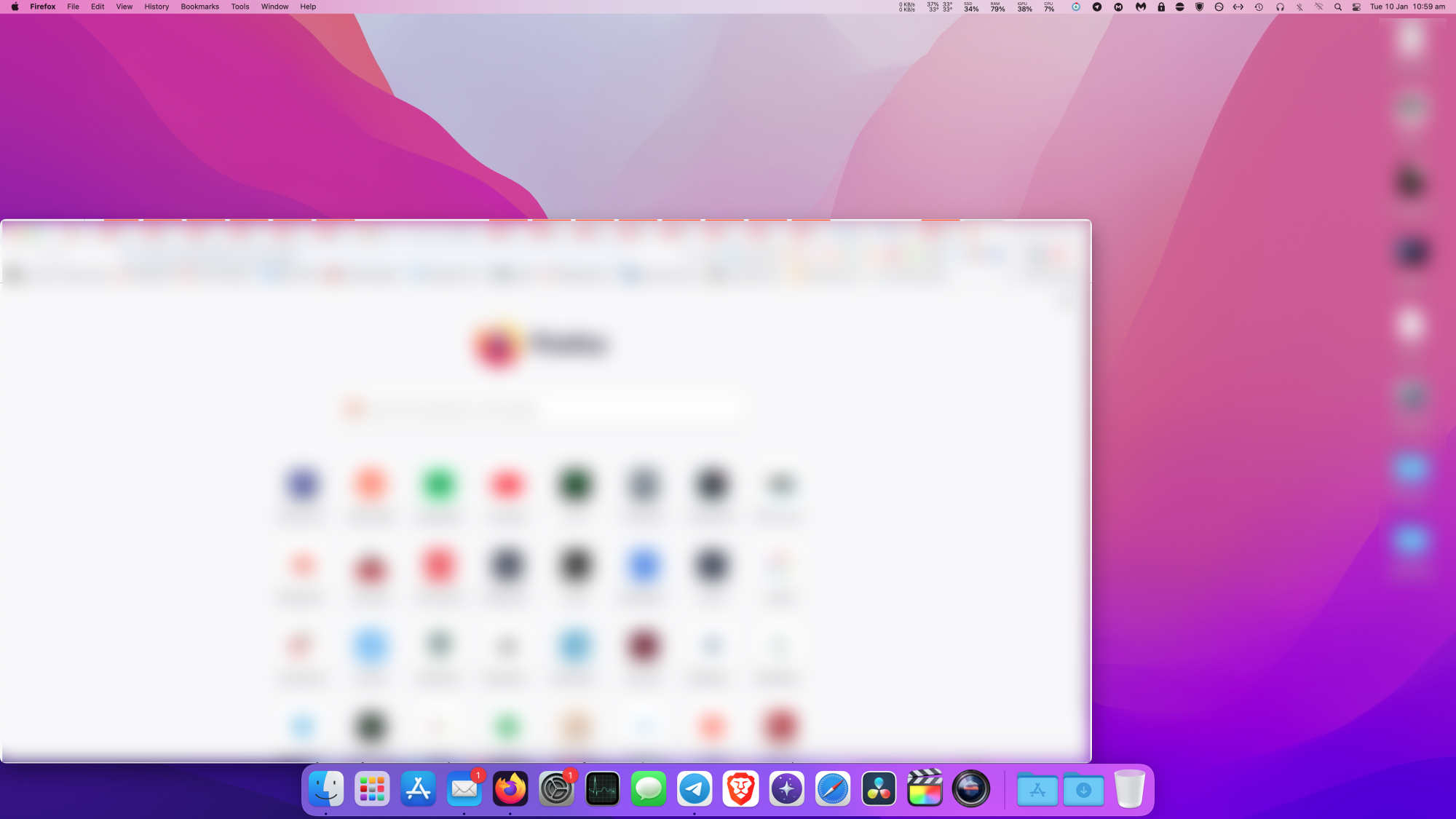

I have an M1 Mac Mini connected to a 27" LG 4K monitor via HDMI. I usually have three other apps apart from Finder open at all times. These are: Mail, Firefox and Telegram messenger. They are always opened to the maximum window size when in use (not full screen mode). Every single time I wake the computer from sleep these three apps are resized and moved to the lower left of the screen in the exact same position, so that if you were to open one over the other, the one in focus would completely hide the others. This has been happening for as long as I have owned the computer (about two years) and I have just put up with it. Lately though, for whatever reason it has been really irritating me, and I've been trying to figure out how to stop this from happening. I have not found much online regarding this issue and a potential solution. Does anyone have any idea why this might be happening and/or how it can be fixed? I have attached a screenshot for reference.

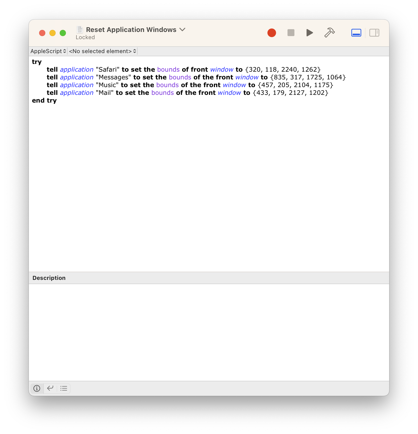

I've come up with a band-aid solution. I wrote an AppleScript that will put the windows back where I want them and I run it using a keyboard command (F19) using an app called FastScripts. Wicked awesome app if you like scripting and attaching commands to them.
I've edited my script to check if the application is running before changing the window size because if not, each app opens.
Just put "if application "Safari" is running then tell application "Safari" to set bounds of front window to...."
By the way, if you want to get the current size and position of a given window, just make an AppleScript that says "tell application "Safari" to get the bounds of the front window" and it will spit out a number in the section of the window below the script.
Hope this helps!
