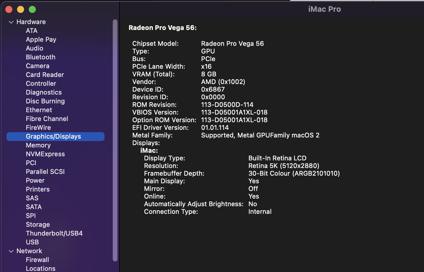

How do I check which Version of the 30" ACD I have?
The next thing would be upgrading to M3 Mini when it is released....but as I read the thread...M3 does not work. That's bad so for the Lifetime of this 30" ACD it will most likely an M2pro Mini....hopefully this will work.
This is how I find it in Monterey. If that has changed in the last two macOS versions, I do not know.
Go to About This Mac
Overview -> System Report
Hardware -> Graphics/Displays
Serial Number:CY60208KUG1
Model:Cinema Display (30-inch DVI Late 2005)
Codename:-
Build Country:This unit was built in Korea.
Build Year:This unit was built in 2006.
Build Week:This unit was built in week 2 of that year (January).
Production Nr.:This unit was number 291 to be built that week.

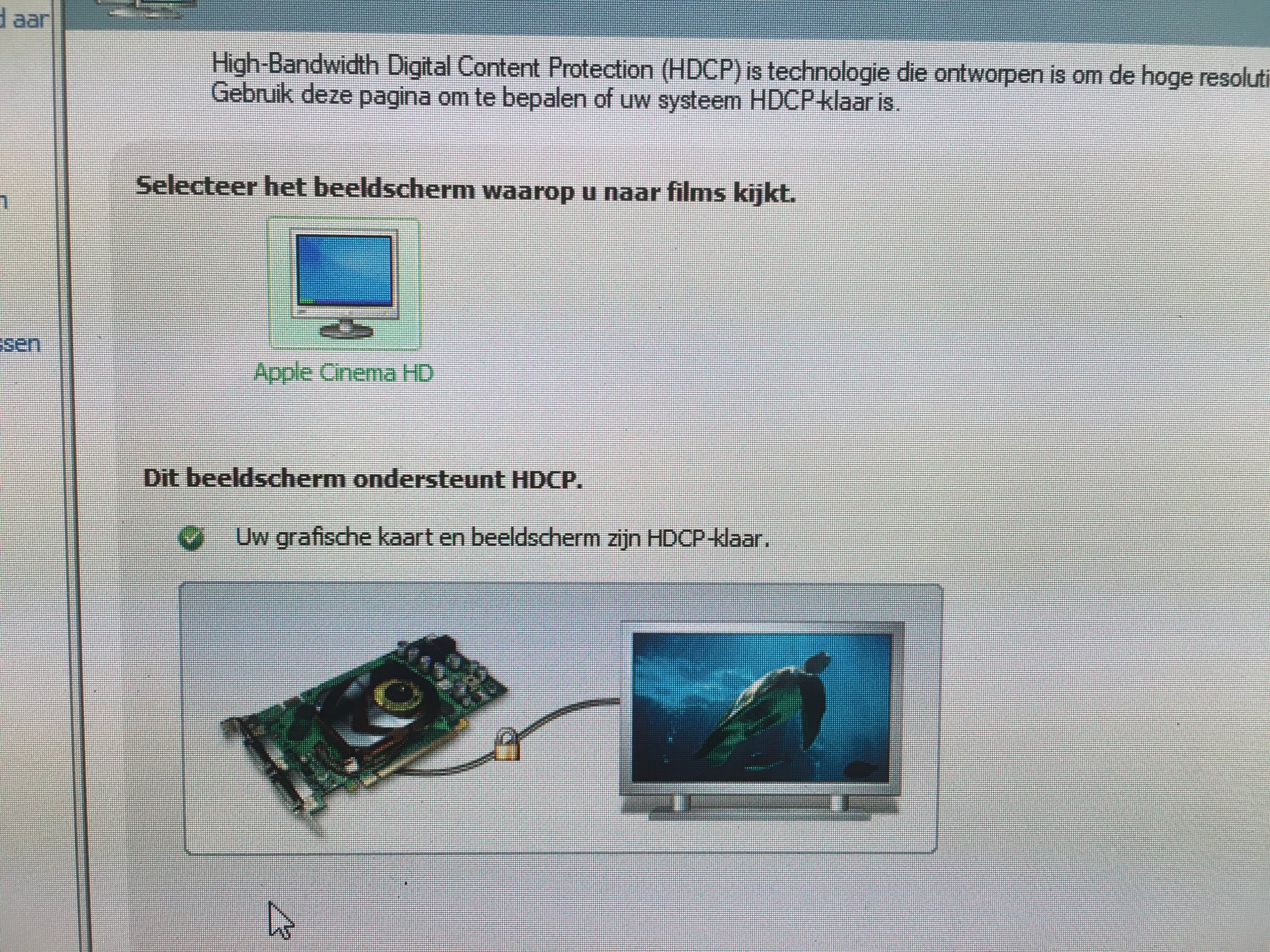

All 30" Cinema Displays produced from mid 2007 and onwards support HDCP!
This is mine:
