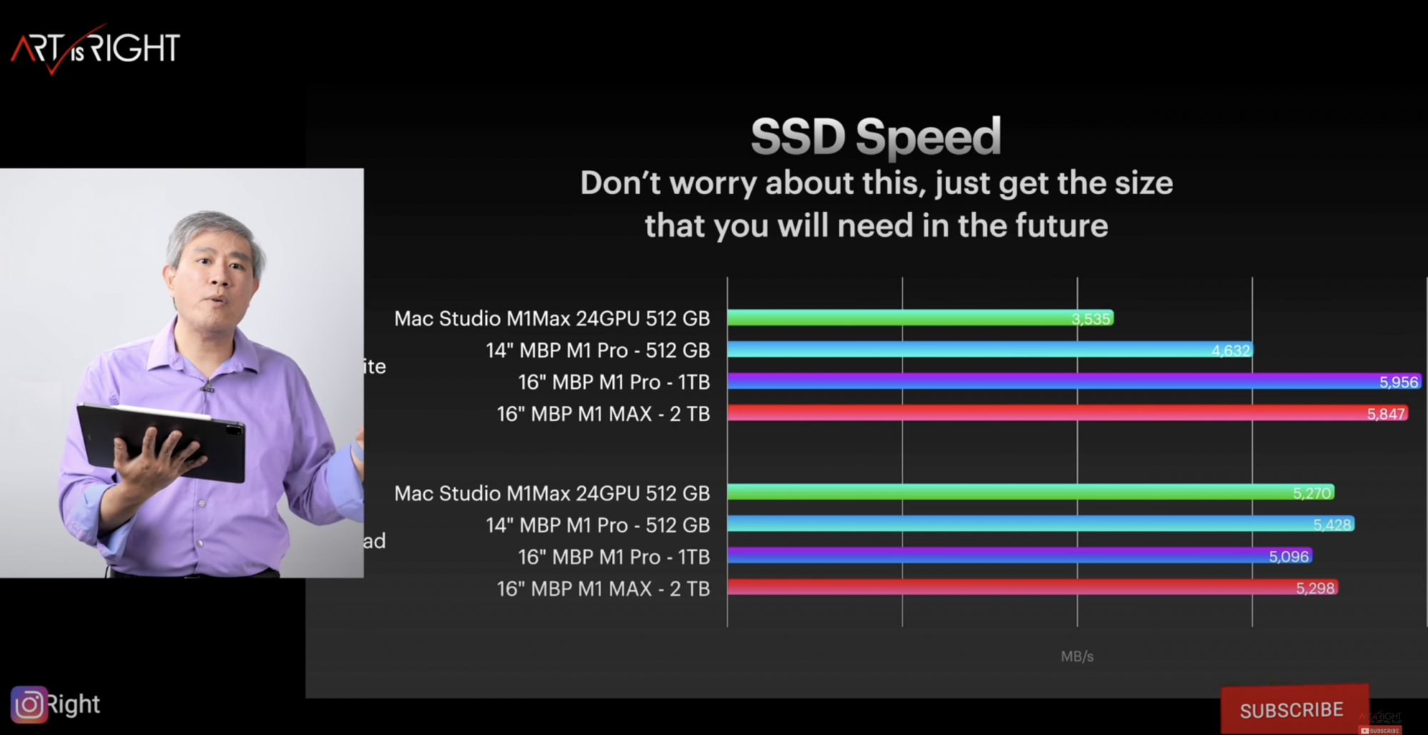

Is the socketed SSD in Mac Studio slower than the SSD in MacBook Pro 14" & 16"?
As far as why Apple solders the SSD in everything, it comes down to cost. It's cheaper to have a pick and place machine place the nand flash chips right on the logic board rather than have a socket installed, and purchasing a completed SSD elsewhere. They probably do a cost analysis and look at internal warranty data when making that decision was well. It's also a great incentive to force the customer to pay Apple their crazy high prices to have more storage at the time of purchase, and failing that, it gives them an excuse to sell the customer a new machine.
Reactions: turbineseaplane
Ya all the tests I have seen show the Mac Studio is a bit slower than the 14/16". Maybe because it is socketed.
Surprisingly tests of the. "Artisright" on youtube show the same: studio is slower than comparably sized 14/16.
Interesting. Thanks for sharing.
Curious to know if that translates into a noticeable real world experience or it its a fraction of a second faster or a whole minute. Small variances are a fine trade off for replaceable socketed storage imo.
The truth is that it only matters in a vacuum: if it had 2 the same ssd inside, then we could say that if all you do is copy/paste/move the data from one ssd to another then you are going to win with soldered. But it doesn't have - copy/pasting within 1 ssd doesn't test the speeds.
We could say that you will win if you copy/paste the data all day to externals - truth is that your external will be a bottleneck to even slower studio's ssd.
Overall conclusion: you would have hard times to notice the speeds faster than 2000 and not going to see any difference by going any faster than that. It is just higher numbers make some people feel better.
Reactions: Zdigital2015
There isn't that much of a difference in read speed - which is mainly what makes your Mac feel nice and responsive.
The only way I can think you might notice the lower write speeds is if you are doing a lot of swap between the RAM and SSD. Your Mac might just feel a smidgen slower. Maybe?
Of course you can compensate by getting a larger SSD. Write speed will go up with a larger SSD, so if you just get something bigger, that (theoretical) lag starts going away.
